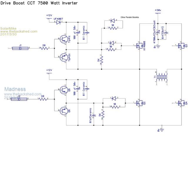

Is the IR 2010PBF gate driver a good alternative for the IR2110PBF?
It could supply 3A.
Clockmanfr
Joined: 23/10/2015
Location: France
Posts: 437
Posted: 02:25pm 05 Mar 2018
A good 2110 requires 10v to 20v, 15v is spot on.
12v should be okay coming from that TIP35c with a 13v zenner.
Other 12v supplies required, like the cooling circuit, then a 48v to 12v separate supply is recommended.
tinyt
Joined: 12/11/2017
Posts: 564
Posted: 02:26pm 05 Mar 2018
  nickskethisniks said   Is the IR 2010PBF gate driver a good alternative for the IR2110PBF?
It could supply 3A.
In my opinion, I think it is. On a 48v system, we don't need the 600v rated IR2110.
I will add it to the experimental inverter I am still designing. Thanks for the info.
Madness
Joined: 08/10/2011
Posts: 2498
Posted: 08:58pm 05 Mar 2018
the ir2010 appears to be directly compatible and the 200V maximum is more than enough, the MOSFETs are rated at 80V.

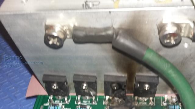

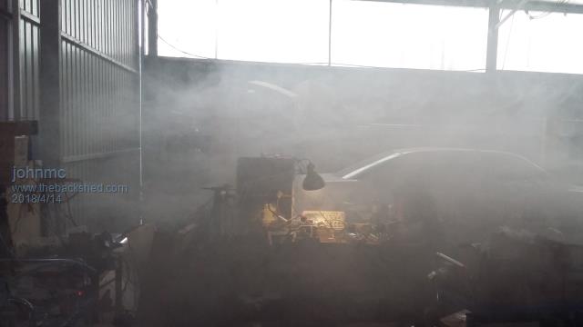

Good Day All
Still no inverter but i have managed to destroy over 100 HY4008 50 odd ir2010
20 odd EG8010 and numerous PCB boards the last effort of a soldered in place FETS and cpacitors
So power board number 3 has screwed replacement of Fets and power capacitors
The inveter will create a sinewave with a standing current of 1 amp (50w)but this is with restricted battery supply.
when the inverter has the main battery bank 1000 amp hr at 48 volts supplied even with a small load of 500 watts this will blow the power fets .

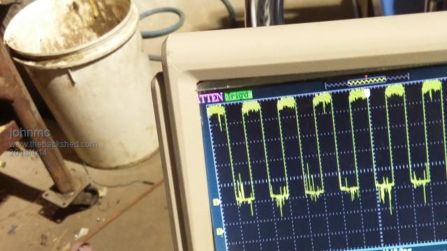

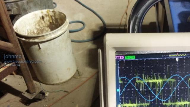

The fet driver voltage is 17 volts there is no noise from the transformer .

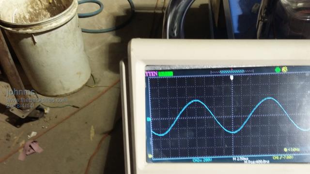

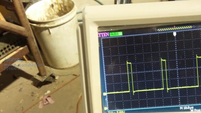

The following wave forms are taken at the power board high side fet gates but no fets fitted to the power board
highsde Fet fitted
low side and with fet fitted
With out the fets the low side wave is nice and square.
Cheers john
johnmc
