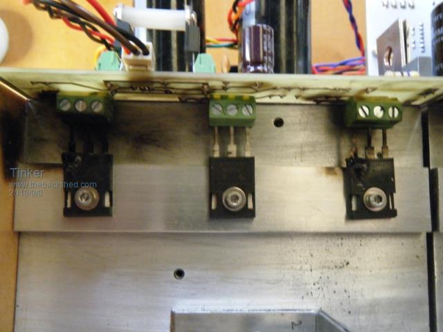

It has been a bit quiet here lately so I thought I'd amuse you with my exploits .
The idea was to find out why my inverter has spurious 'brownouts' when a very heavy load comes on. For this I used my test inverter (inverter #4).
So I had it connected up and running with various loads when I noticed I did not have the IFB signal connected to my control board.
The load was switched off and the inverter was idling when I attempted to plug in that wire.
Bad idea .
This is what happened: Big bang, bright flash and fire. The most spectacular blow up yet .
All of the 12 mosfets self destructed, the ones at the low side caught fire by the time I disconnected the power.

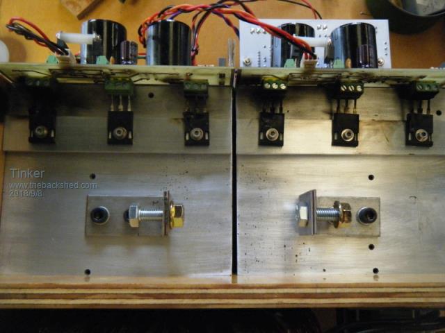

This close up shows that the screw terminal idea works well for a blow up but the terminal got too singed by the fire so three of them require replacing. That was the only solder job I had to do, the PCB had no damage and cleaned up nicely.
Two of the totem pole transistors (TIP42C) also shortened on the low side but as these are on screw terminals are easy to replace.

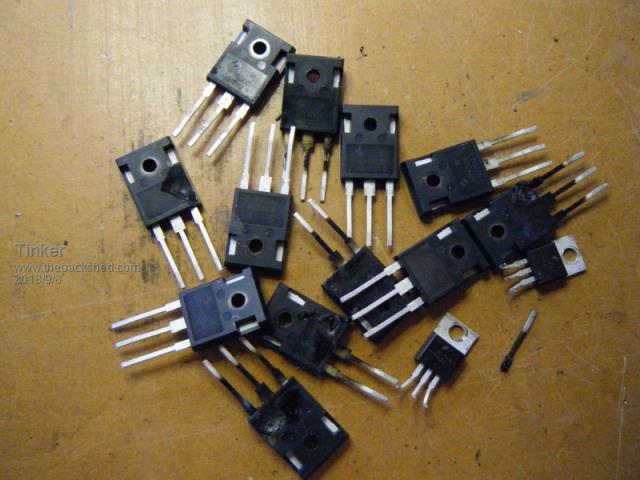

Here are the casualties:
Lesson learned: Do turn off the inverter before plugging anything in or out.

Maybe if you make a rectangular plate to cover the face of the MOSFETs you might be able to hold them together

  Madness said   Maybe if you make a rectangular plate to cover the face of the MOSFETs you might be able to hold them together
Brilliant idea Gary, it could add extra heat sinking too .
What I found interesting is that despite the mosfet legs were left at their full length they survived, the blow occurs inside the body.
I suppose the mess left on the PCB with the short mosfet legs you solder guys have would be much worse .

[quote]that the screw terminal idea works well for a blow up but the terminal got too singed by the fire so three of them require replacing.[/quote]
It seems to be the exploding legs that burn the screw terminal blocks. If the legs are kept original full length, the mosfet body is a fair distance from the terminal block.
Anyhow I had this idea of buying some fairly thick wall teflon high pressure tubing and slipping a short length over each mosfet leg. That should contain the fire and smoke and protect the terminal block and heatsink somewhat. The protective metal shield is a good idea too.

Today I found that 9 out of the 12 gate diodes also blew, I had used IN4148's there and they worked fine.
Have not yet tested the gate drivers or the EG8010 outputs to see if they survived.
Warp, The HY4008's had the full length 'legs'. Its the source leg that melted off at the mosfet body on some. It would have got hot enough for the plastic housing of the terminal to start smouldering where the 'leg' entered. I'm not sure if a teflon sleeve would help there as I think the 20A terminal rating was exceeded by a fair bit briefly.
I will try mad's idea of a cover strip though. Looking at it a 20 x 3mm alu strip right across the 3 (or 6) mosfets would do a good clamping job and just, maybe, conduct a little of that heat away when the two tiny source wire connection inside the chip explodes. It an easy mod with lots of room to do it at my PCB.

Madness - Yes, I got the joke but thinking about it a little its actually not a bad idea. I made the top clamping bars today .
Wiseguy - We have progressed past the EGS002 solution here. If you like to play with that, have fun. But I will not try to complicate an inverter that runs very well 99% of the time by adding yet more components to go wrong.
You can look up the schematics of my inverter control and power board on an earlier page here. Look at the latest posted schematics, some earlier ones have been modified since.
I am very pleased about the physical attachment of the mosfets in my inverter. This certainly makes their replacement soooo much easier than you lot of the solder them in brigade. The charring of 3 of the 12 terminals I did not foresee and I will try warp's teflon sleeve idea since I have some here.
The PCB has no charring/ burn marks whatsoever.
