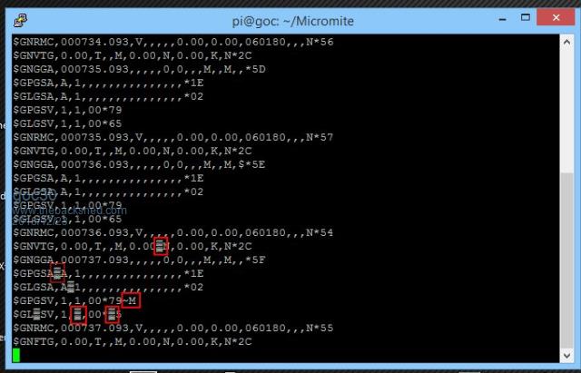

Hi Matherp
I have a small problem with my GPS
it is a "gsm/gprs/gnss hat "
I work in 115200 baudrate and sometime I receive bad char
in usb mode I have no problem
my program test
Open "com1:115200" As #1
Dim a$ As string
print #1,"AT+CGNSPWR=1"
pause(100)
print #1,"AT+CGNSTST=1"
pause(100)
If Loc(#1)=>1 Then
a$=Input$(1,#1)
Print a$;
End If

  Quote  I work in 115200 baudrate and sometime I receive bad char
Are you receiving a bad character (i.e. checksum incorrect) or is it the output to the screen that is corrupting? All serial I/O on the Pi-cromite is bitbanged as the real UARTs can't be used (the best one is dedicated for bluetooth, the other changes speed when the CPU throttles) so it is best to keep baudrates as low as possible. Nothing I can do about this.
I have checksum error each time,
If I use card with usb output (not by rpi), all frames are corrects

Posted: 06:54am 24 Dec 2018
After change baudrate (9600Bd), it work correctly
For me it's enough, but I think that Picromite can't work with high speed like 115200 bds
