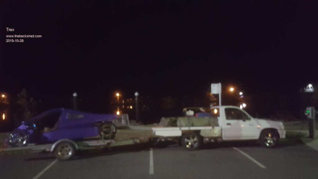

Left Taree at 7.14pm.
No charge data from a show ground 3 phase outlet.
Arrived at Macksville 10.05pm
EV Hilux used 22.4kW
T-Rev used 102.7Ah
Drove 166.4km
Time for a sleep while it charges. There will be no charge data on this one either as it is not controlled by chargefox. Free by the council of Macksville.

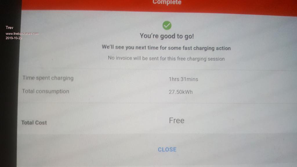

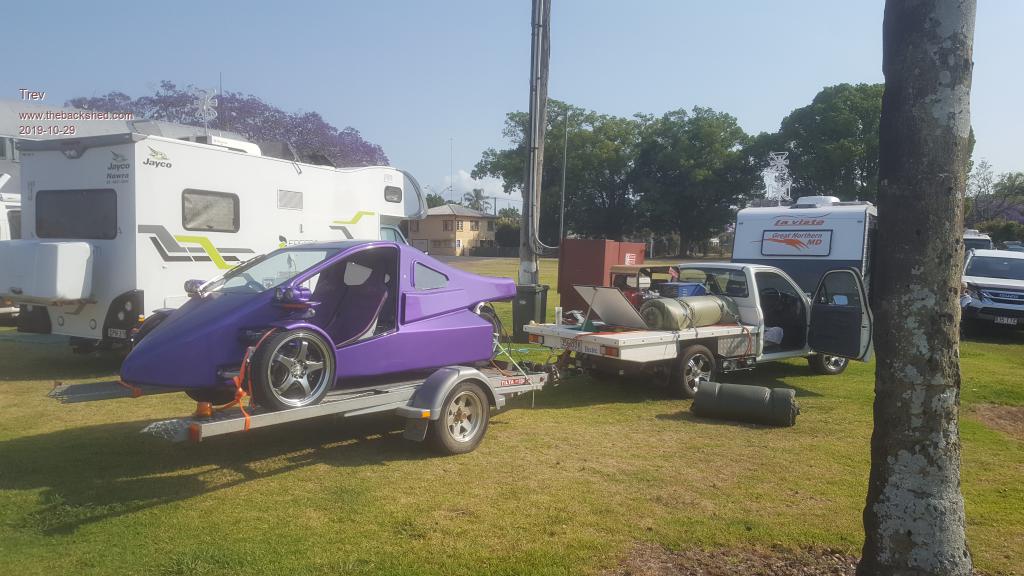

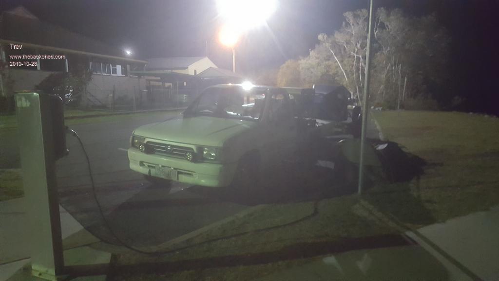

Posted: 10:35pm 28 Oct 2019
Left Macksville at 5.30am.
Arrived at Grafton showgrounds at 8.14am.
EV Hilux used 21kW
T-Rev used 96 Ah
Drove 140km
Charging at Grafton showgrounds for free.
Just in case it is not obvious. I am driving home with T-Rev and EV Hilux battery packs connected together permanently. I don't have the MGEV to save the power for, so I am boosting my range and stopping to charge far less often.

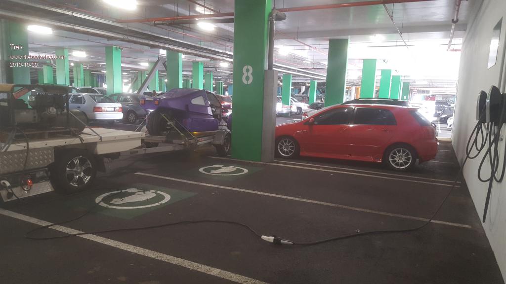

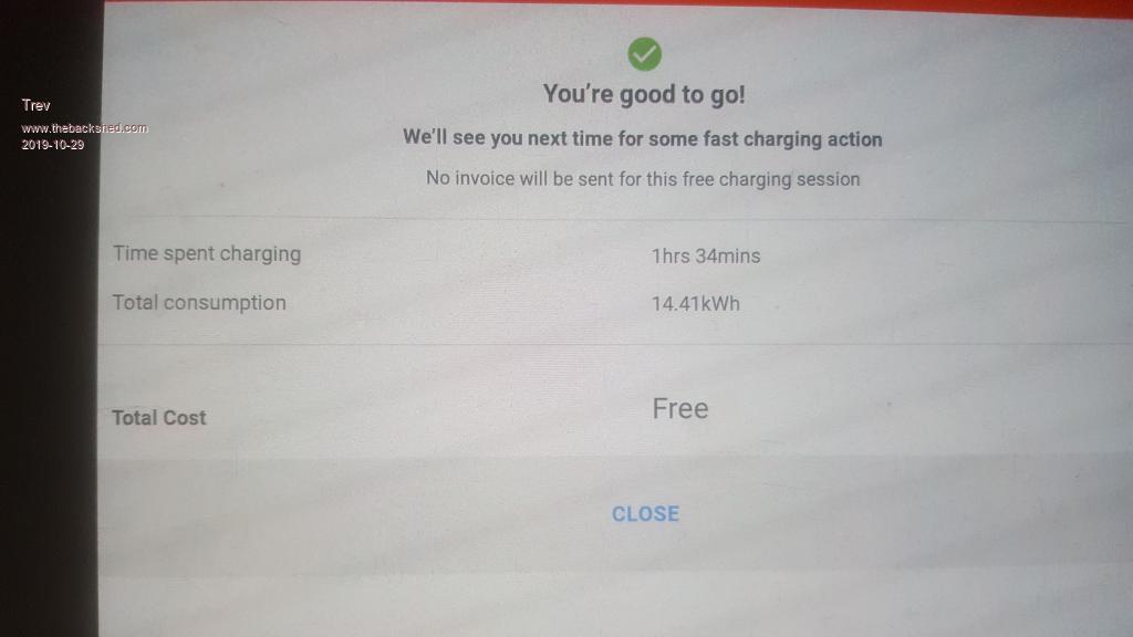

It was 30 minutes to get the first cable connected using the tablet. I toyed with the phone for another 20 minutes or so but could not get the phone to connect. There is no internet service and the shopping centre wifi is very weak, in this underground carpark. We had the same trouble on the way south as well.
I really didnt want to disconnect the tablet connection. It was hard to get it. But the only way I could see was to set up both cable connections from the tablet. After a few attempts I got it. So there is 3 data pictures. Another issue we found last time was each box cannot run both port A and port B at the same time.
Cost $10 for parking. Double what we paid per vehicle on the way down. Just because it was over 2 hours in the carpark. Electricity is free.

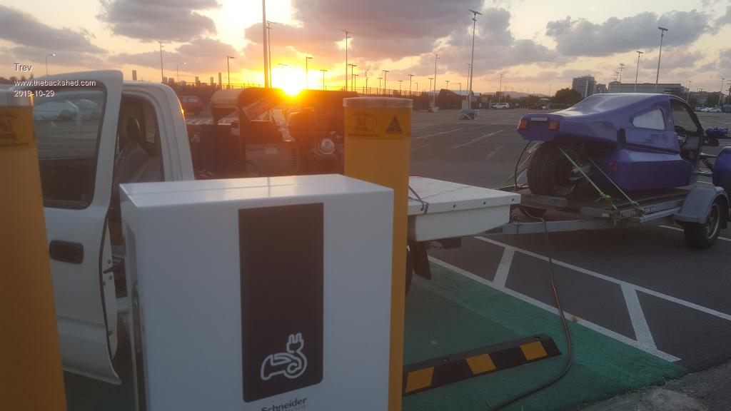

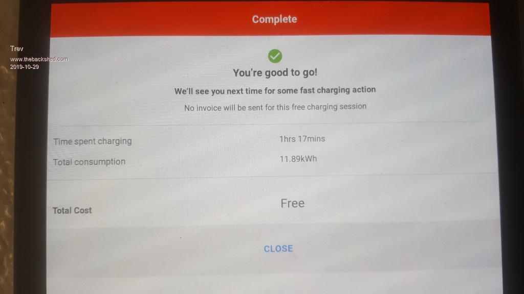

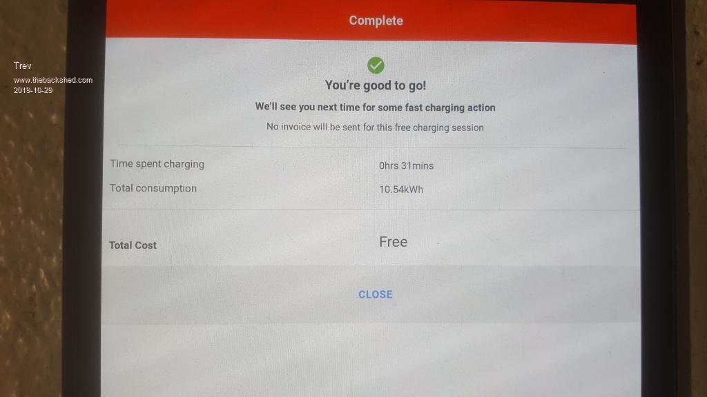

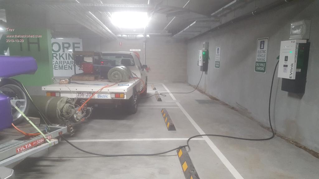

Left Byron Bay at 3.15pm
On the way, stopped at Suzi Auto, (4.50pm  Qld time again now, crossed back over the border. NSW time is 5.50pm) for a few minutes to drop off some batteries.
Arrived at Hamilton Northshore at 5.50pm (peak traffic through Brisbane)
EV Hilux used 22.6kW
T-Rev used 109Ah
Drove 177km

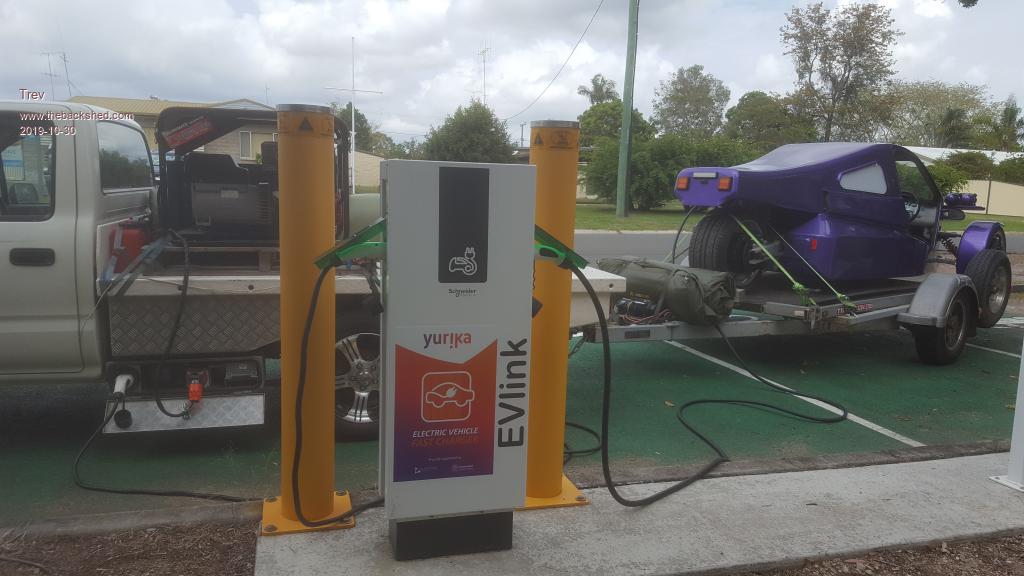

Nice picture just before I plugged in. The sun was gone by the time I had both cables plugged in.

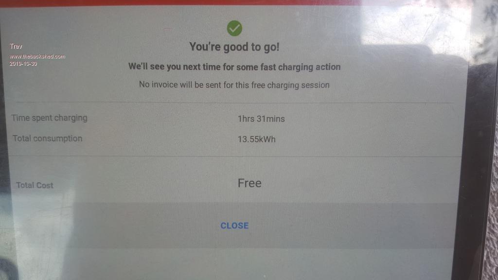

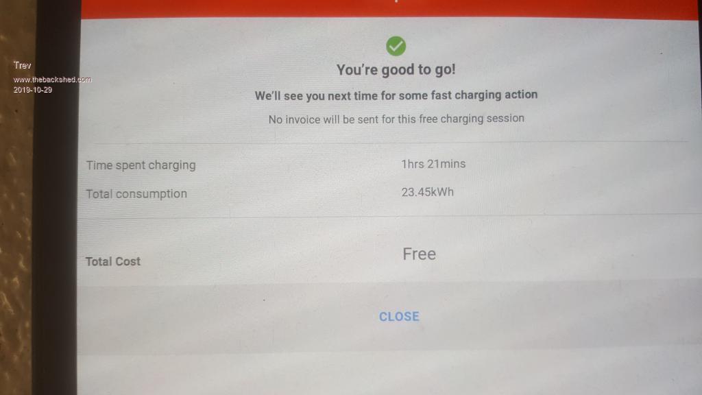

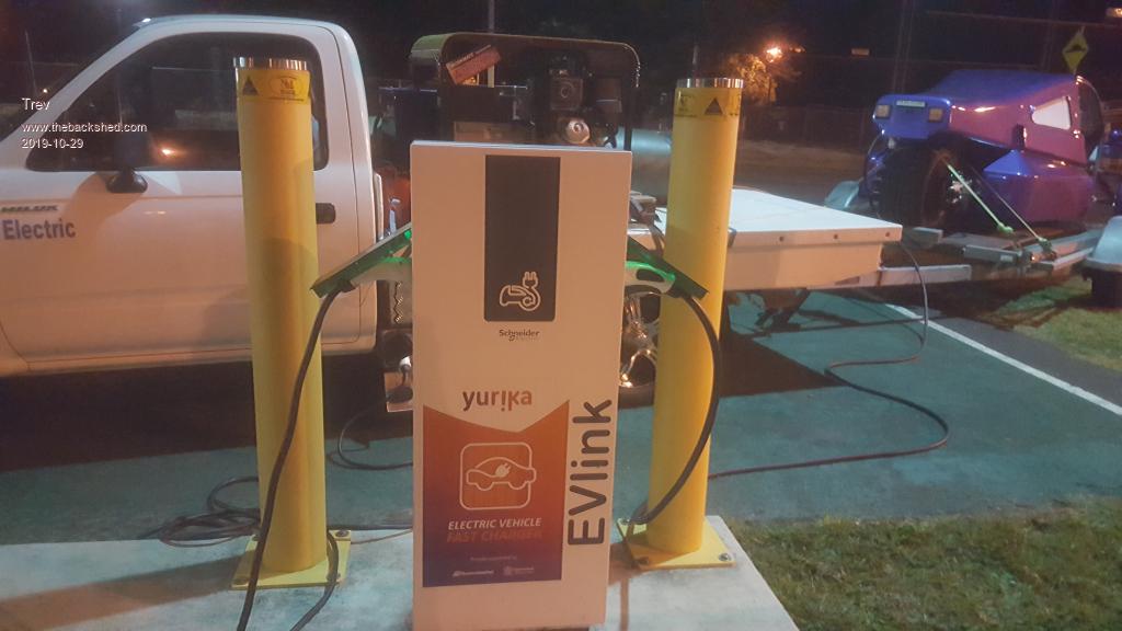

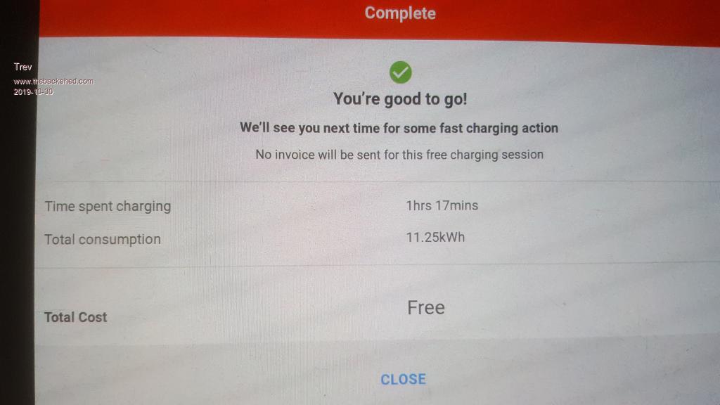

Chargefox data for Hamilton Northshore
Left Hamilton Northshore at 7.40pm
Arrived at Cooroy at 9.45pm
Drove 130km
EV Hilux used 18.6kW
T-Rev used 75Ah
Trev @ drivebynature.com

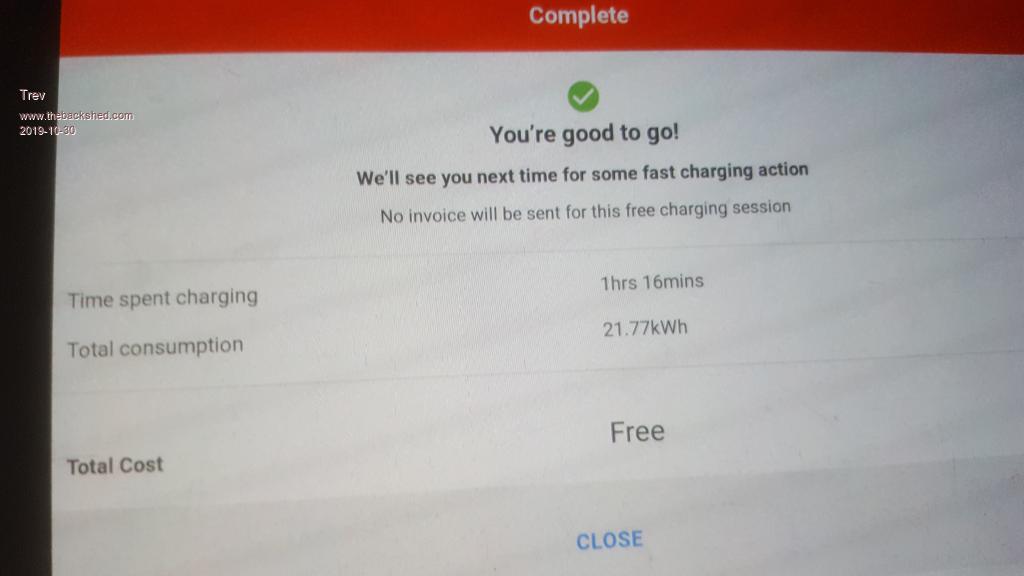

Posted: 11:33pm 29 Oct 2019

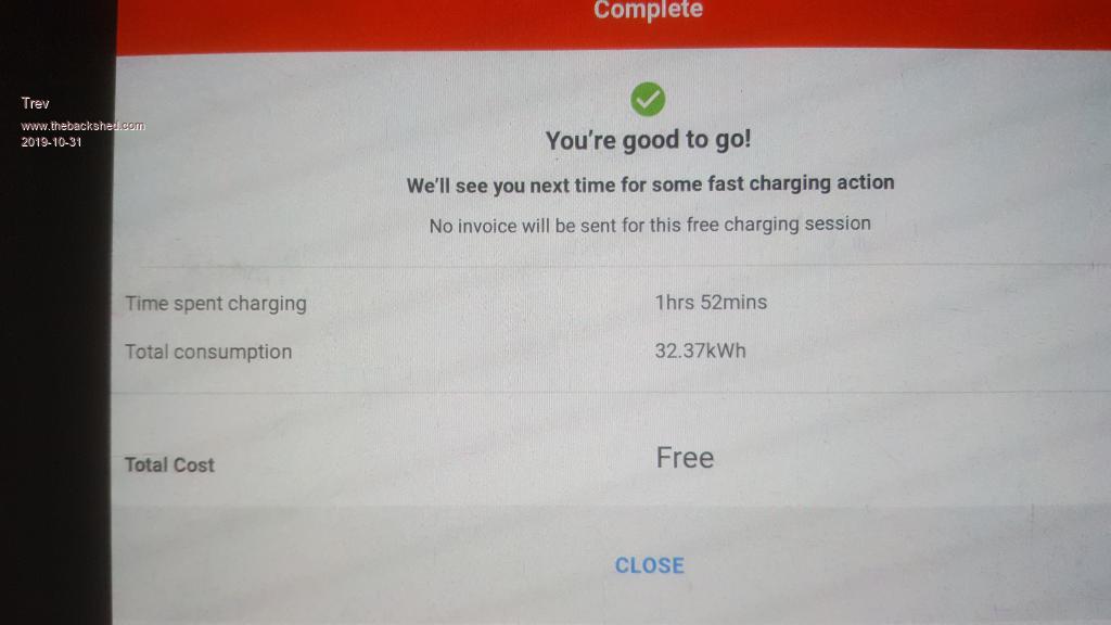

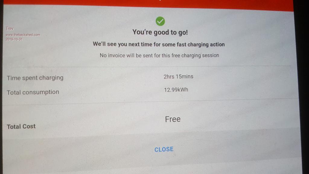

Here is the Chargefox data for Cooroy
It would have been good to sleep at Cooroy while charging, but I don't feel safe there. The police turned up just as I was finishing the packup. Just ckecking to see if I was ok.

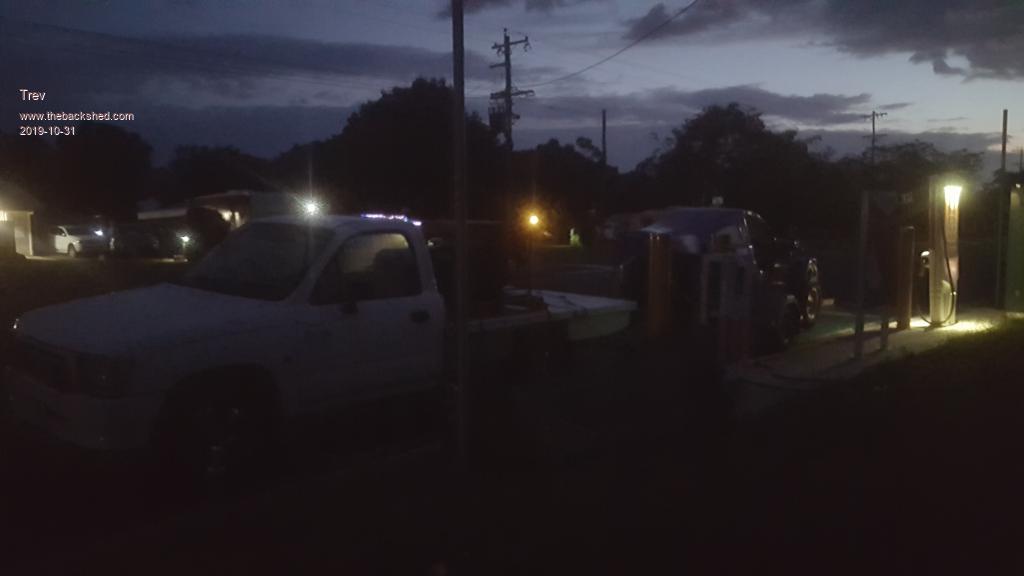

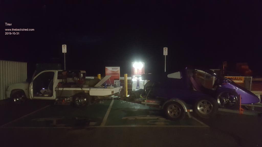

Quickly got it plugged in and setup swag for a sleep while charging. photo taken thismorning, day 3 from Sydney.

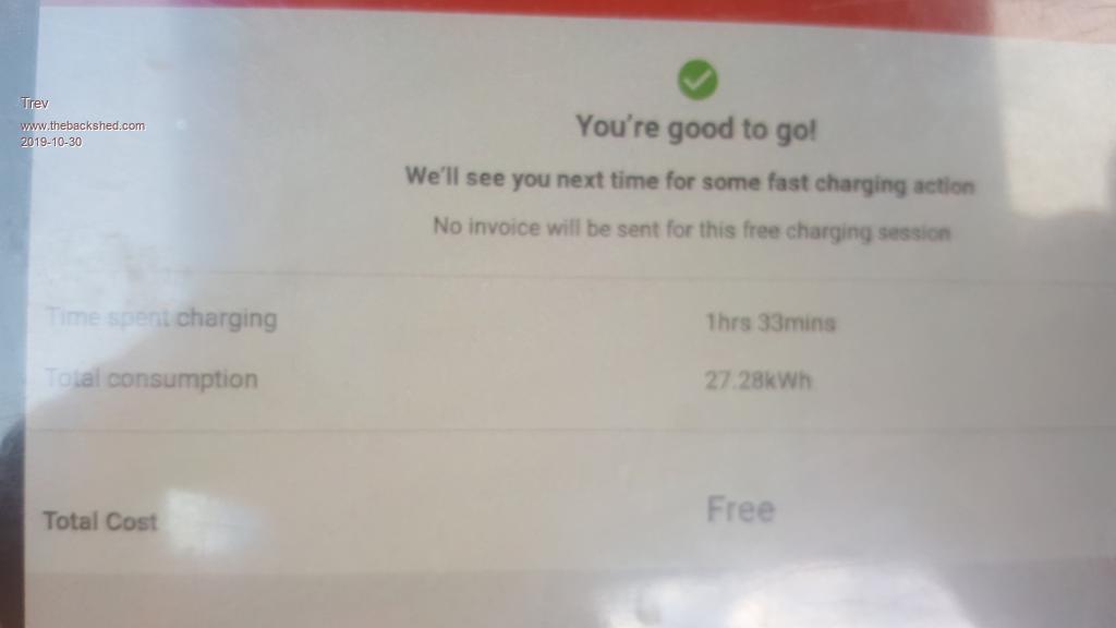

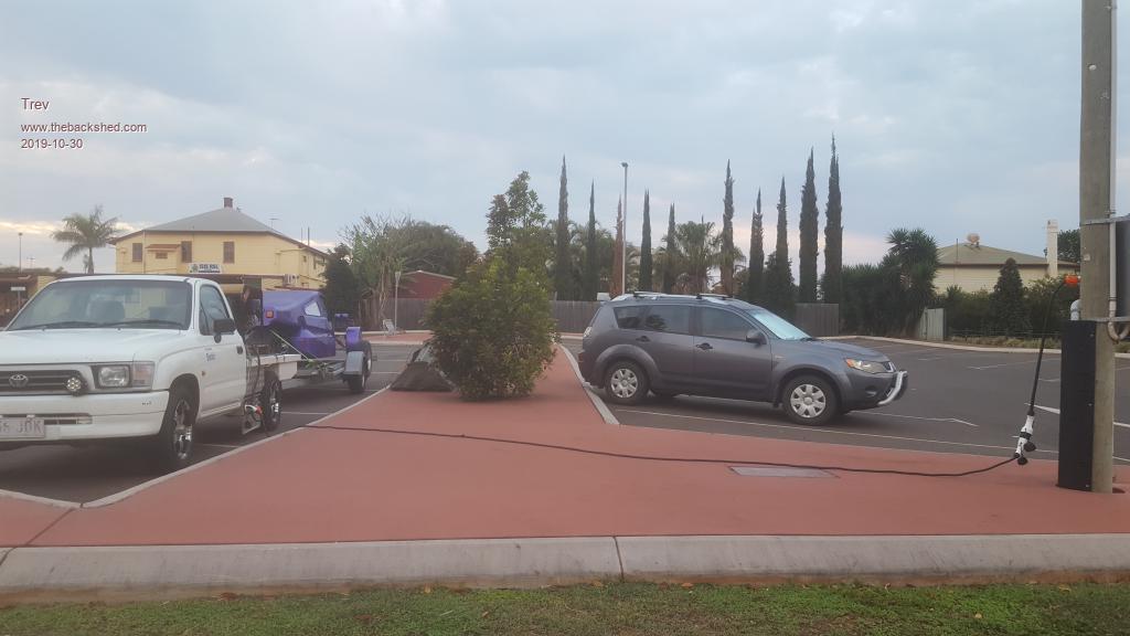

Here is the Chargefox data for Miriamvale.

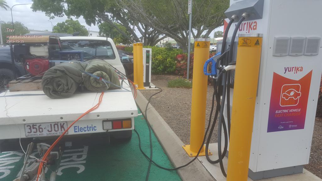

Arrived at Rockhampton at 12.58pm
Drove 169.3kn
EV Hilux used 23.3kW
T-Rev used 112Ah
Rocky Type 2 Schneider charge station does not work. Chargefox support couldnt make them work either.
I managed to work out the big box (DC fast charge box) Type2 outlet. It is supposed to be 32A 3ph but only runs 2 single ph chargers. So it is a very slow charge. I will only put in enough to make the next 100km to Marlborough.

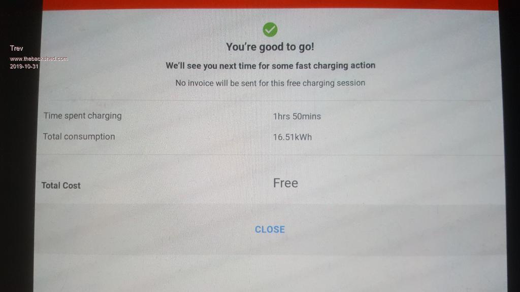

Chargefox data for Marlborough

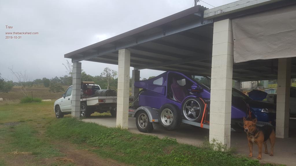

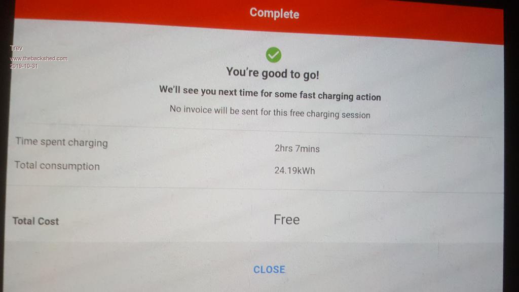

I got it plugged in and set up swag for a sleep. Picture taken thismorning at 5am.
Chargefox data
Packed up and driving by 5.15am
Arrived home at 7.30am.

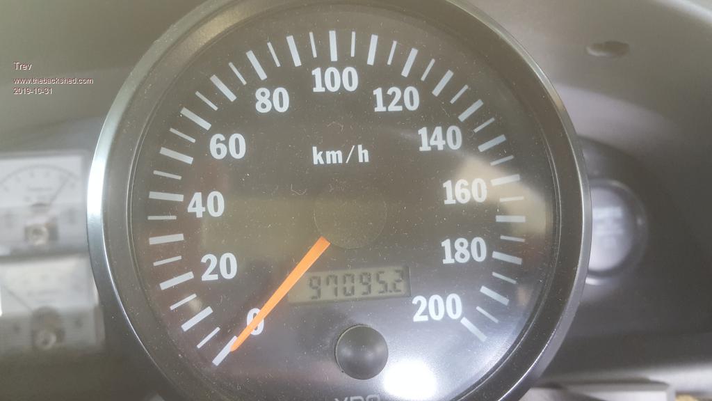

Total distance for the trip is
97095 - 92902 = 4193km
THE GENERATOR WAS NOT USED AT ALL, FOR THIS TRIP. It was taken, just in case we needed it. Fortunately, we managed to not need it.

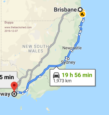

I gotta go to Melbourne to pick up my new trailer..
Identical hilux to all intents and purposes...
The fuel alone is going to cost me  close to a grand... (on top of a 6g trailer cost..)
CRIES...
A grand in fuel alone...
anyone who says EV is 'pie in the sky'- well I'll be happy for you to pick up my trailer in Melbourne and bring it to me in Brisbane for exactly the same cost as Trev had for his trip...... (almost exactly the same distance in total)
Time isn't an issue- as long as it is in in Brisbane before May... pushbike might do it even...
DAVO99- looking at you- up for the challenge???
This is a serious challenge- I will pay you EXACTLY the same as Trevs 'fueling' costs to pick it up (it is a 2.4 x 6m trailer- 4.5t gross, 850kg tare)and deliver it to my house- (a corolla wont cut the mustard with a 6m trailer on it)- or alternatively- I will drive it- and you pay ALL the fuel costs above Trevs recharging costs in my hilux... no other costs- no accommodation, no food- just the fuel cost alone...
Willing to put your money where your mouth is???
(You might come out ahead- but I doubt it...)
