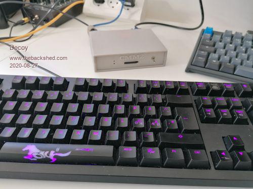

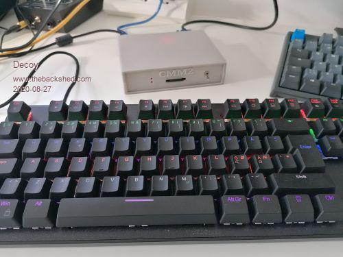

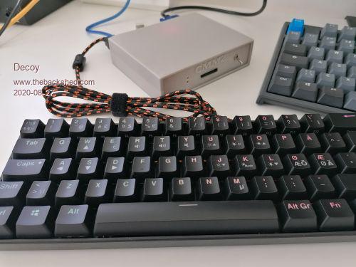

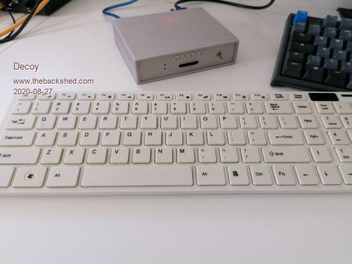

Decoy
Joined: 02/08/2019
Location: Denmark
Posts: 109
Posted: 04:43pm 26 Aug 2020
The following keyboards work on CMM2:
Ducky Shine 2014 Year of the Horse Mechanical keyboard
ADX RGB Mechanical keyboard (60%)
Zar Mechanical keyboard TKL
Generic chinese wireless keyboard (The back says Way of working: Wireless 2.4GHz)
/Decoy

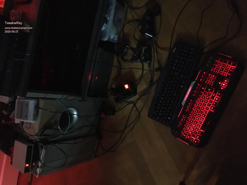

TweakerRay
Joined: 01/08/2020
Posts: 138
Posted: 05:52pm 26 Aug 2020
  darthvader said  @TweakerRay.
Have you test you KB with the latest version Peter uploaded sooner ?
latest version before the next one ...
Hi ! I have uploaded the latest Beta Firmware and now my keyboard is working fine on the # and ' sign... I just checked my old "Tecbean" gamerkeyboard with LED works fine too now... before the firmwareupdate the # and ' sign would simply not work... now everything is fine thanks to the fix in the firmware.
http://tweakerray.bandcamp.com
