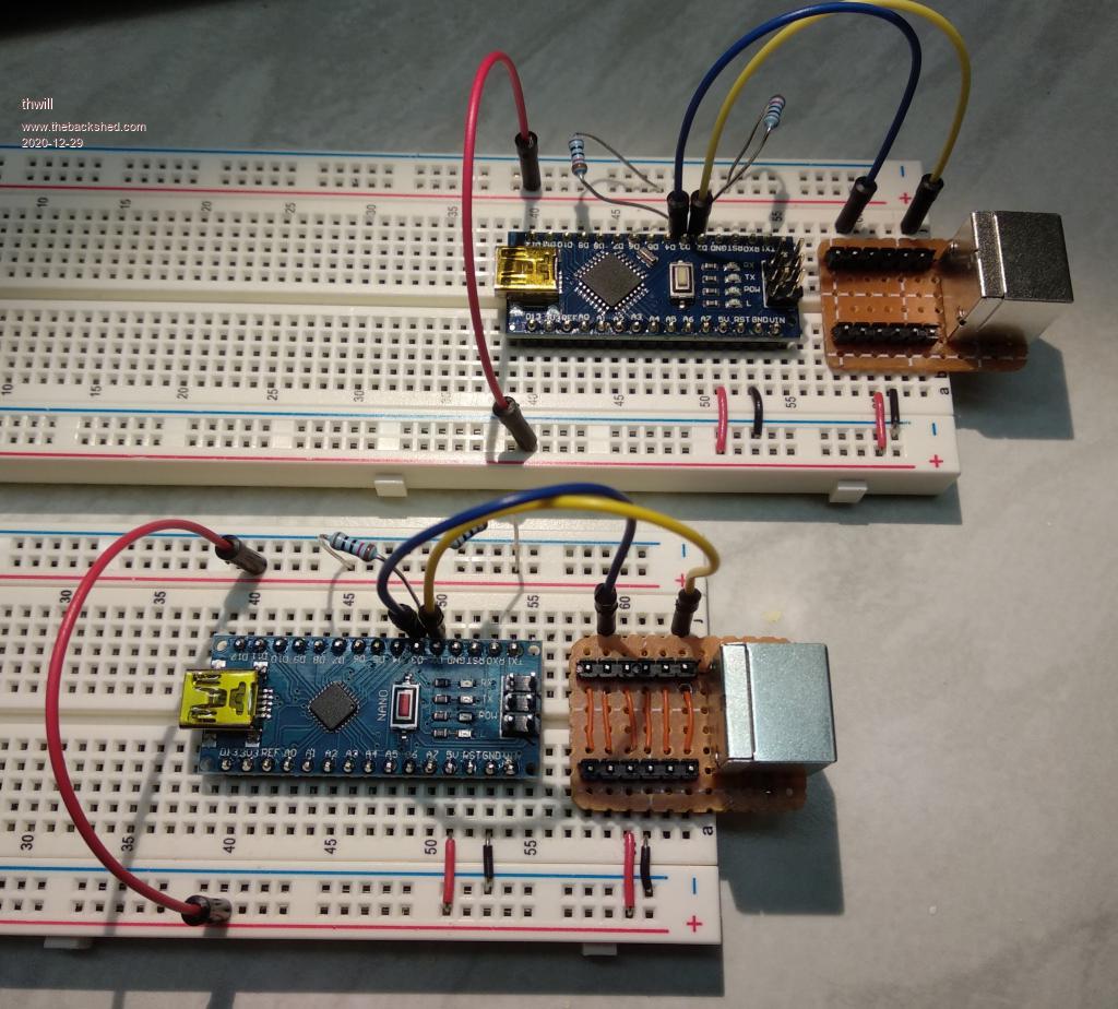

Posts: 11947
Posted: 04:40pm 25 Dec 2020
Have you got pullup resistors on the mouse clock and data lines? If not try 4K7 to 5V

Posts: 3884
Posted: 10:55pm 25 Dec 2020
  mclout999 said  I just put them in line with the data pins D2 and D3 correct? I will have to find some resister.
Not in-line--pullups. If one 8.2K (per signal) doesn't work, try two pullups per line in parallel.

mclout999
Joined: 05/07/2020
Posts: 523
Posted: 05:56am 26 Dec 2020
[QUOTEConnect then from D2 to 5V and D3 to 5V]
I did that and now I can start with my new optical plugged in and it works right off. There are 3 other optical mice models that will not work but I can live with that. I did not have to use the pause at all. It is a good solution but we should note that not all mice will work.  I have 7 mice models and now 4 work without a reset or anything. I am still researching mouse code for my own edification as I am beginning to understand a little how microcontrollers work. Now I just want to reorder some parts to be able to button this little beauty into a sleek small safe box. The only parts that did arrive were the NANOs. After 3 months 9 other parts orders never came from China.
 Thanks.
Posts: 6620
Posted: 06:42am 26 Dec 2020
  mclout999 said  [QUOTEConnect then from D2 to 5V and D3 to 5V]
That's good news.
I should have included the pullup resistors in the original circuit.
I was led astray by the knowledge that my 3 ball mice and 2 optical mice all worked without them.
The optical mice use a USB to PS/2 adapter and that does include 4.7k pullups in it which explains why I didn't need the pullups for them.

Posts: 4405
Posted: 11:24pm 28 Dec 2020
Hi Jim,
Just a few lines to say I'm still playing with this.
I think I now have the Nano <-> PS/2 working with a nasty old mini/laptop USB mouse that I dug out of a crate and a green Microsoft PS/2 <-> USB adapter, looks like I am getting the expected output on the Serial monitor but haven't had opportunity to connect it to my CMM2 yet.
My new PS/2 mouse still isn't co-operating and the Nano appears to "hang" after printing the initial Mouse OK. I'll get back to you with some more information the next time I find time.
One thing I notice even in the working case is that I sometimes have to Reset the Nano two or three times before things get moving.

On the nano, comment out the lines at the start that do the checkMouse()
leave the mouse.initialize(); as the only active line in that area.
if (in_mode == 0) {
   // Serial.println("Start here ");
  //  mouseOK = checkMouse();
  //  Serial.print("mouseOK ");
  //  Serial.println(mouseOK);
  // readStart = millis();
   mouse.initialize();
  // readTime = (millis() - readStart);
   // Serial.println(readTime);
 } else {
   joy_initialize();
connect CMM2 pin 8 to PS/2 clock line (nano pin D 3) via 100k resistor
connect CMM2 pin 10 to PS/2 data line (nano pin D 2) via 100k resistor
connect CMM2 pin 12 to clk_pin (CMM2 pin 8)
Once the program is running on the CMM2, do a reset on the nano to force the initialize routine.
