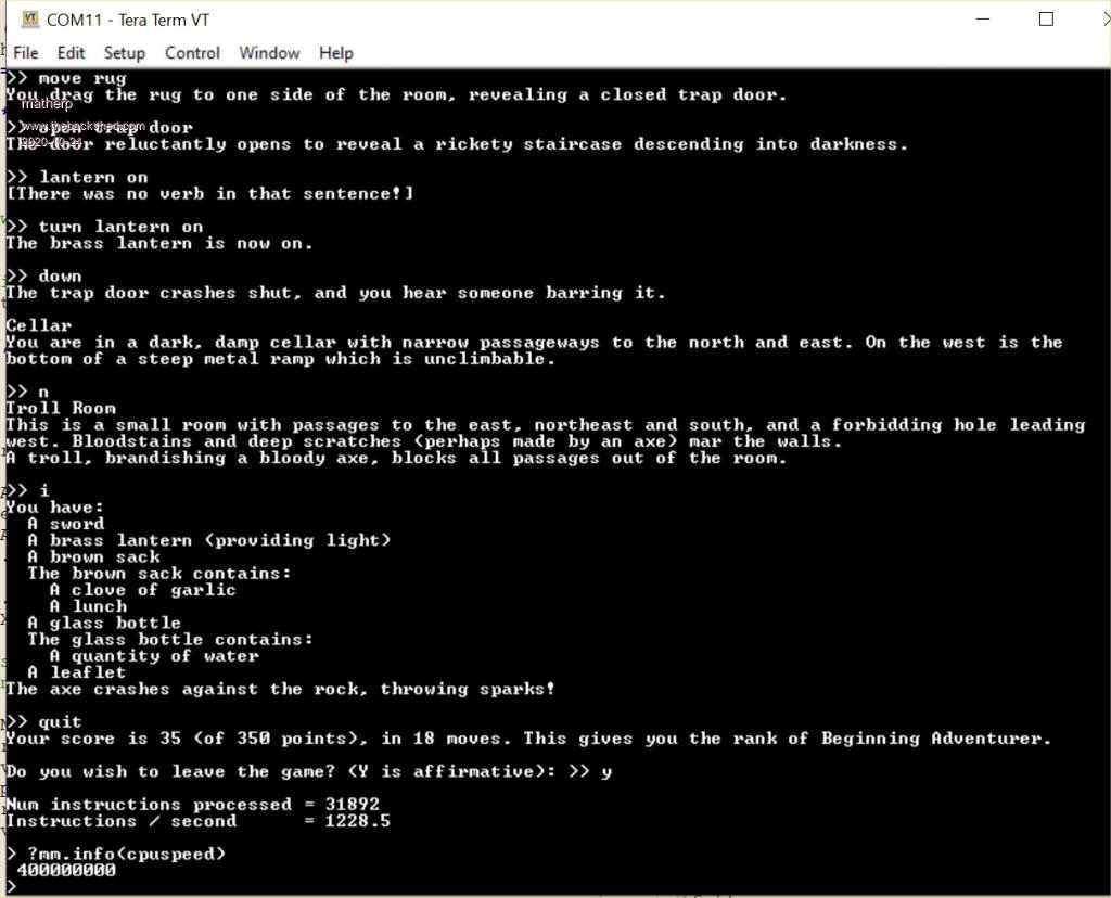

Posts: 11914
Posted: 03:54pm 23 Oct 2020

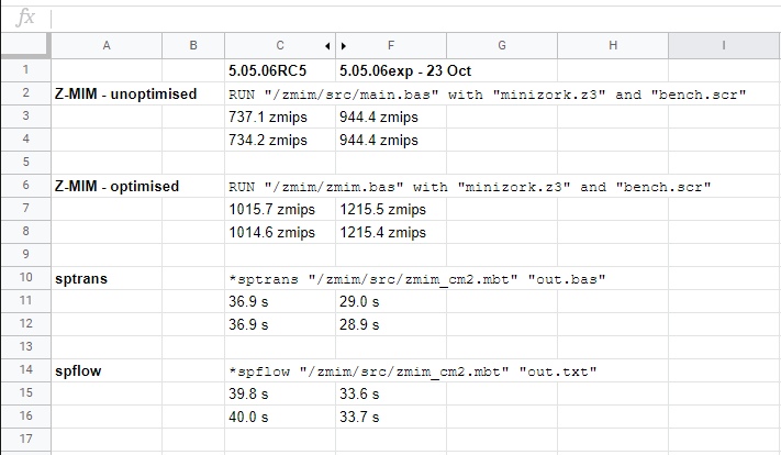

Posts: 4404
Posted: 03:58pm 23 Oct 2020
Very nice, but did you optimise the firmware? ... or have you just spent the last 24 hours hand optimising my code? ... please don't tell me it's the latter.
Edited 2020-10-24 02:00 by thwill
Posts: 11914
Posted: 04:02pm 23 Oct 2020
Haven't touched your code - just improved the hashing
Posts: 4404
Posted: 04:05pm 23 Oct 2020
  matherp said  Haven't touched your code - just improved the hashing
In that case we are truly not worthy to be blessed by your greatness

Is there a way of telling which I have from a query (rather than opening the case  )
Posts: 11914
Posted: 06:46pm 23 Oct 2020
  Quote  s there a way of telling which I have from a query (rather than opening the case
Look at the last line on the screenshot I posted
Doh!
