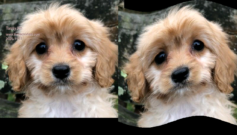

I always knew my dog was a bit warped:
 MODE 1,16
 LOAD JPG "face"
 FOR n = 0 TO 390 STEP 10
   shift = SIN(RAD(n))*20+20
   shift2 = SIN(RAD(n+10))*20+20
   IMAGE WARP_H n,0,10,390, 400+n-1,shift,390, 410+n-1,shift2,390
 NEXT n
DO:LOOP UNTIL INKEY$ <> ""
