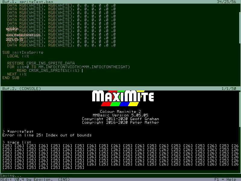

You can see the console screen in the editor by pressing F6, which is less than what you want, and more than what you want.
For instance, you can see any debug messages leading up to the error, or you can do a TRACE LIST prior to invoking XEdit. I usually do TRACE LIST, open the basic file in one buffer of the editor and the console with the trace list in the other buffer. See screenshot.
But the editor does not jump directly to the offending line. To achieve that, I think I would have to do some kind OCR-like scan of the console screen and parse the result. Doable, but tricky to get right in all possible cases.
It would be easier if I could programmatically access the TRACE LIST history from XEdit, but the trace history is reset when a new program (i.e. XEdit) is launched.
Anyway, thanks for the feedback. I have your feature request on my to-do list, but it might stay there for a while.
