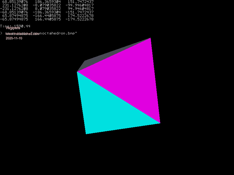

Some times:
full draw        : 1583 ms
by commenting out sections
no triangle draw :  705 ms
no rotation      : 1235 ms
no image erase   : 1419 ms
no hidden face   : 2475 ms
The 'no hidden face' result is interesting. It looks like it is because only 4 triangles are drawn when hidden faces are removed, all 8 are drawn without hidden face removal. Suggests an average of about 120ms per triangle over the 720 iterations.
My triangle code is
triangle tx0+cx,ty0+cy,tx1+cx,ty1+cy,tx2+cx,ty2+cy,c(&h0),c(&h0)
which includes some calculations to center the image on the screen.
And of course my vertex coordinates at iteration 650 don't match anyone else's, plus my end position seems different too.

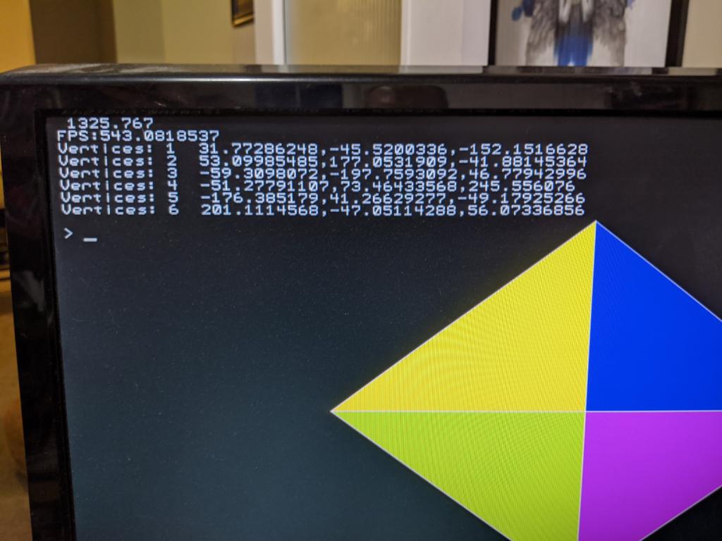

  vegipete said  Oh yeah! Some serious unrolling and matrix shrinking gives me under 1585 milliseconds. And that's at 400MHz.
That's absolutely fantastic! Brilliant job.
  vegipete said  I gather you are finding too that the end position is not the same as the start position?
Mine ends up matching?
Here are my iteration 650 numbers... but of course I have no idea if they are right or wrong as none of us have matched

z = 0? Those are projected coordinates?

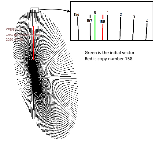

I get one rotation of the octahedron every roughly 157 iterations. Which, curiously, is about pi divided by 2, multiplied by 100... ???

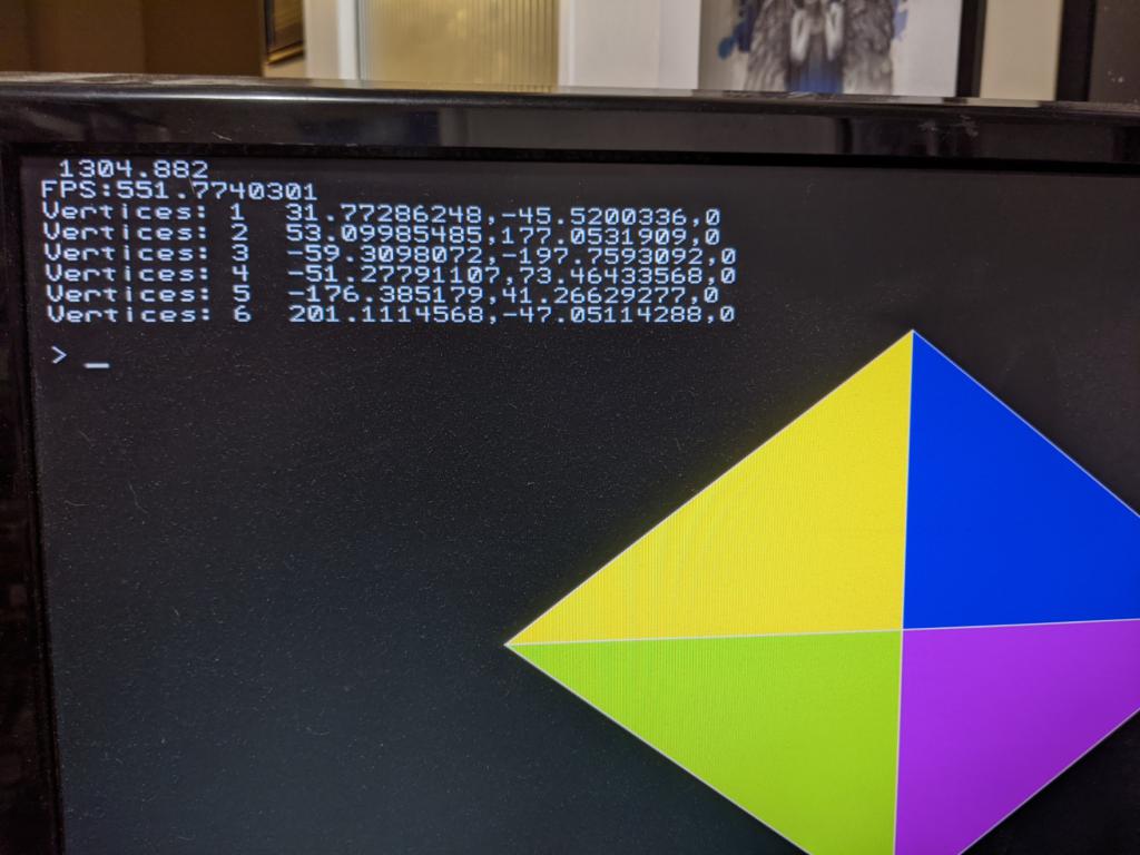

  vegipete said  z = 0? Those are projected coordinates?
Well spotted! I just realized I calculate and discard the z value with each rotation once I have calculated the perspective positions. So I added a bit of code to store them. It added 20ms to my time, so I'll remove it once it's done it's job, but full set of co-ordinates below. Thanks for spotting that!
  vegipete said  I get one rotation of the octahedron every roughly 157 iterations. Which, curiously, is about pi divided by 2, multiplied by 100... ???
I used "option angle degrees" to make my life easier. I'm guessing you're seeing a rounding error?

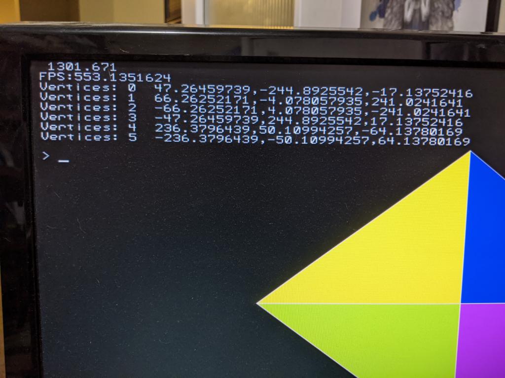

There is something strange with your vertex coordinates. I just checked the first one and the vertex is not 250 from the origin. I would expect the square root of the sum of the squares of x, y and z to be 250.
I can't tell for sure but I think LeoNicolas is getting a similar result to me, just with a reflection difference, perhaps from dealing with y axis up or down, etc.
In one of the posts, matherp described which direction the image should rotate for each of the x, y and z rotations. I made sure my orientations matched that.
Ah, tenth post, on first page
  matherp said  angles to be considered as follows:
X + 2 degrees rotates the top of the tetrahedron away from you
Y + 1 degrees rotates the left of the tetrahedron away from you
Z + 0.5 degrees rotates the tetrahedron clockwise from the perspective of the viewer
My intuition suggests the combined moves will rotate the object faster than individual moves, hence the non-alignment after 720 iterations.

  vegipete said  There is something strange with your vertex coordinates. I just checked the first one and the vertex is not 250 from the origin. I would expect the square root of the sum of the squares of x, y and z to be 250.
By Jove you're right! I worked out that I was displaying the values after they had been adjusted for the viewplane at 800 pixels (therefore the massively distorted perspective values). Here's the pre-perspective values.
  vegipete said  In one of the posts, matherp described which direction the image should rotate for each of the x, y and z rotations. I made sure my orientations matched that.
Thanks, another good catch. I had my Y going the wrong way. Fixed in the below picture.

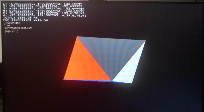

Finally, I got a time less than 1600ms... and I have some new ideas to optimize the code

I just ran a check in a CAD program that allows scripting.
I created a vector from 0,0,0 to 0,0,1
I wrote a short script that:
1) duplicates a selected object,
2) rotates the new object 2 degrees around the x-axis,
3) rotates the new object 1 degree around the y-axis,
4) rotates the new object 0.5 degrees around the z-axis.
This shows the same, slightly over 157 iterations for a single orbit. Slightly over means that at 157 iterations, the vector hasn't quite made it back to the starting vector, 158 iterations has moved past the starting vector. (157.39 iterations for 1 orbit, as a first approximation.)

You are right, I'll fix the rotation direction.
The rotation process has different results depending on the axis rotation order.
X->Y->Z will result in a different position compared to Z->Y->X rotation. Am I right?
And I guess if I apply all the three axis rotation at once the result will be different as well.
Another thing that I noticed was the difference between my vertices values and yours.
Should the vertices, after calculating their value using viewplane and Z distance, be equal 200 or -200?

I'm doing exactly the same process and my end octahedron position (after fixing the rotation directions) is the same as yours image.
My concern is the polygon size. Before any rotation my octahedron has 200x200 due the viewplane and z distances.

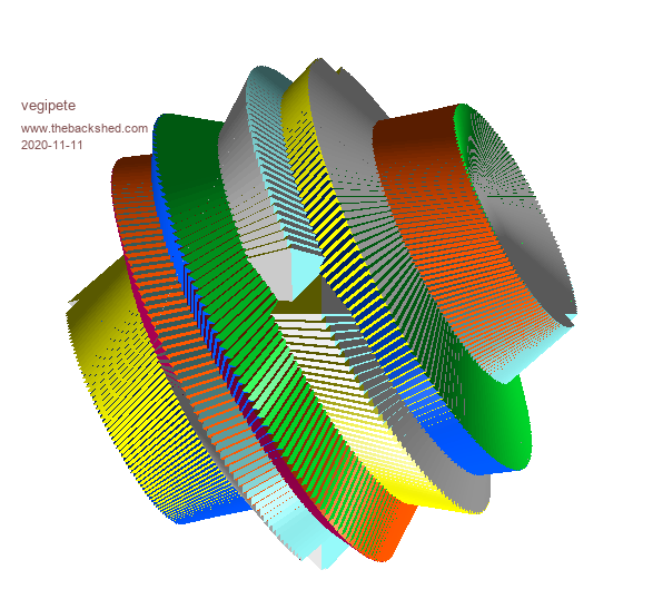

Yes, Set3DRot can do all three at once:
Set3DRot(h2, 2,1,0.5, 0,0,0);
The result appears identical to first x, then y, then z.
The result _is_ slightly different if I change the order of x,y and z.
If I superimpose 150 iterations of an octahedron in the CAD program, I get the image below. The rotation direction is opposite of my CMM2 version, but the resulting shape matches, except for perspective issues - the image below is orthogonal.
(Comment out your image clearing BOX command to see the CMM2 equivalent.)
