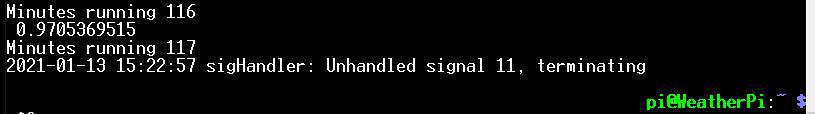

Sorry to report failed again
It ran for 117 minutes before crashing with the time

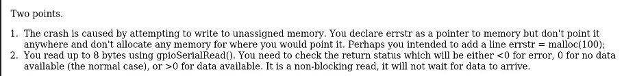

11 is SIGSEGV i.e. a bad pointer

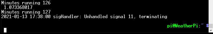

Lasted longer this time  127 minutes
However Peter if you're watching this, I remembered to run Screen this time and once I reopened the console and did the -D -r it came back up with this with the same flashing cursor
No mention of parsing error or crashing because of it
I wonder if the processor is getting too hot and bugs out?
