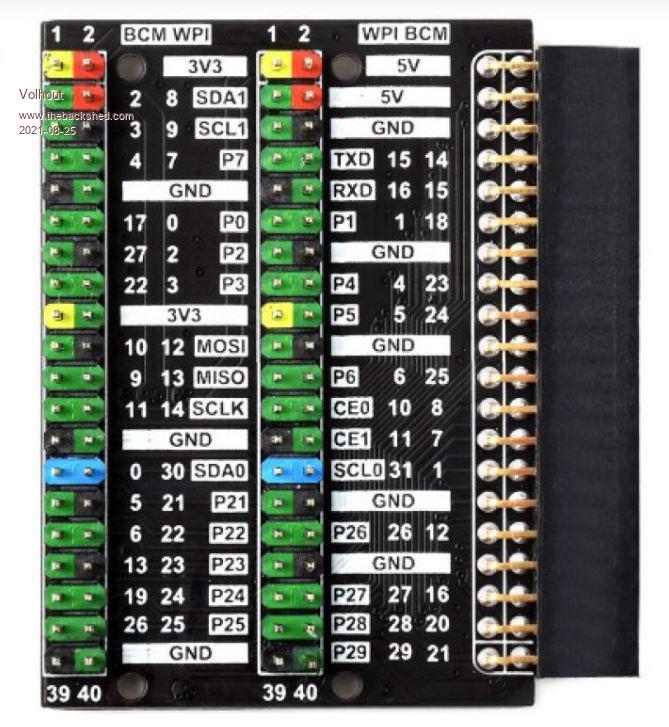

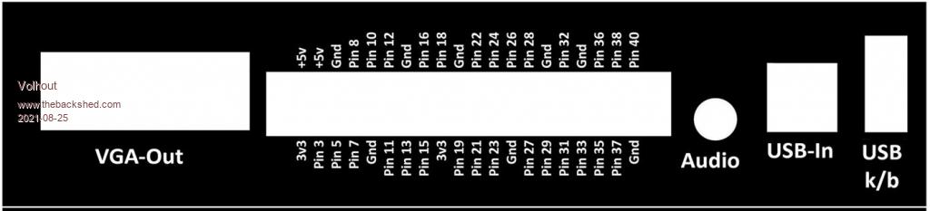

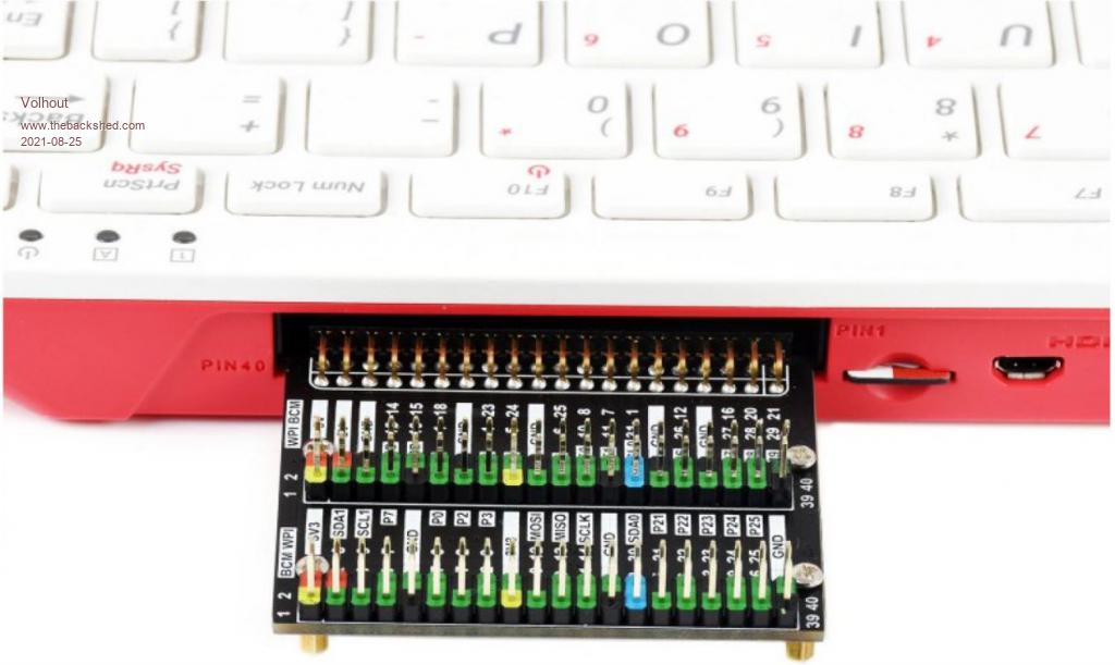

Posts: 6245
Posted: 12:19pm 25 Aug 2021
Apparently the CMM2 GEN-1 is compatible with the Raspberry PI-400. Raspberry Pi Foundation made the same change. But they did not correct it in a new gen.
CMM2 GEN-1 rear panel.
Raspberry Pi-400 breakout board
