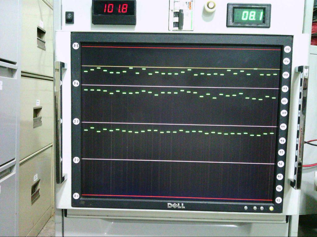

Off The Grid
Posted: 03:07am 05 Nov 2021
I never replaced those three cells, the system still runs with only 27 cells but I have had to turn down the inverter to 220v. I am off grid right now, but it would not work like this through mid winter. I hope to get a couple of fork lift batteries after the Christmas break, maybe mid February.
The other poster here that has had identical cell failures asked the Australian supplier of his Winston cells about these failures.  The reply was that he had NEVER ever even heard of such a thing. Yet I have had three identical cell failures myself.
Apparently its due to dendrite formation. Sharp crystalline spikes grow and short out a cell. The voltage drops to zero with slight cell swelling. There is no information that I can find about what causes this.
The most worrying feature of all is the suppliers denial that the problem even exists.
Once the voltage drops below 2.0 volts, permanent cell damage occurs, and blasting away the short does not lead to cell recovery. Also cell voltages over 4.0 volts lead to permanent damage too. I have never come anywhere near that.
So one little voltage mishap can cost you very dearly by destroying a battery worth thousands.
I thought being paranoid with all my multi layered individual cell voltage protection, would prevent any cell damage, but not so. Its been a very expensive lesson.

Posted: 09:42am 05 Nov 2021
  Quote  Did you actually have a voltage mishap, that you know about?
No perfectly normal operation one day, the next day zero volts across one of the cells.
I mean truly zero, not even 0.1mV measurable.
This is an old picture from Jan 2019 showing how I monitor the voltage of each of the 30 cells continuously. Upper and lower readings are the max and min voltages ever reached. Middle trace is real time cell voltage.
One day perfect, next day middle and lower traces of one cell completely gone, right off the bottom of screen.
The cell just spontaneously shorted out.
The other Forum member that has had this shorted cell problem is using much larger Winston cells.  So its definitely not limited to one cell size or one batch.
Edited 2021-11-05 19:45 by Warpspeed
