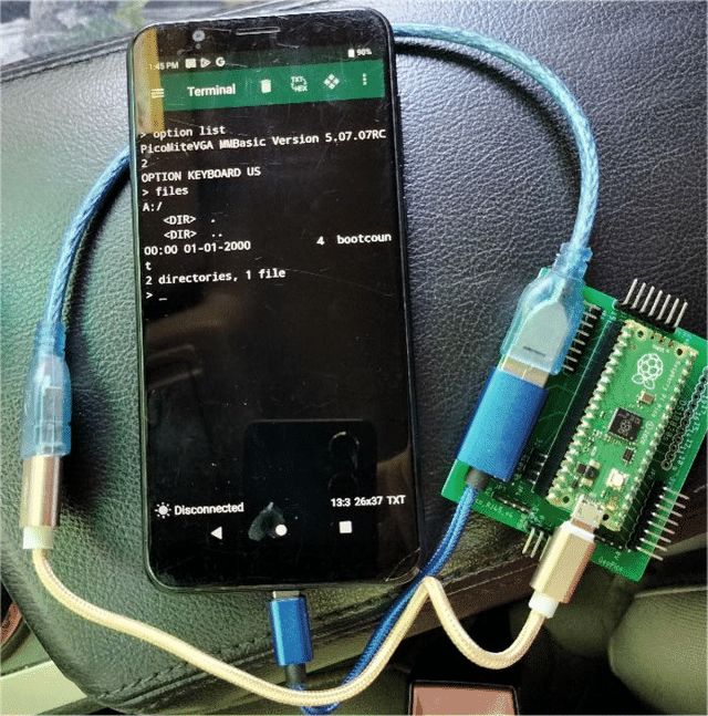

Works for me. My phone and tablets have USB C sockets, and all my OTG cords are micro-USB for Raspberry Pi--but I dug out and old phone, so:
I've ordered a couple of USB C OTG cables from Amazon--supposed to arrive tomorrow.
I'm not sure whether or not I have any programs which do ASCII screen drawing--I'll look.

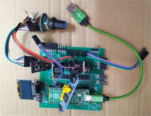

This might be a better PCB to use for experimenting with different I/O modules:
Edited 2023-04-19 05:38 by lizby

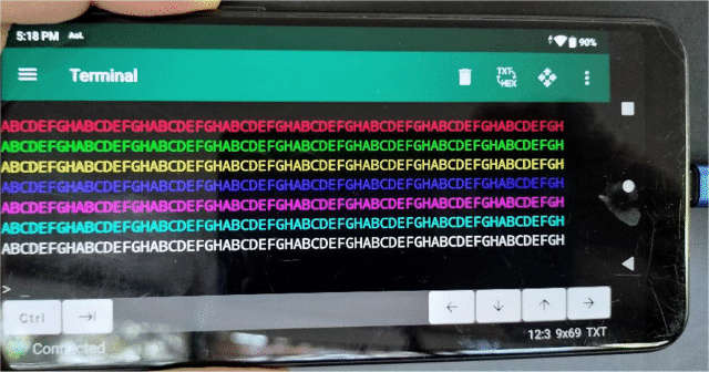

A program which produces the following when run with a TeraTerm terminal crashes the USBterminal app on the phone when the same code on the same PicoMite is run.

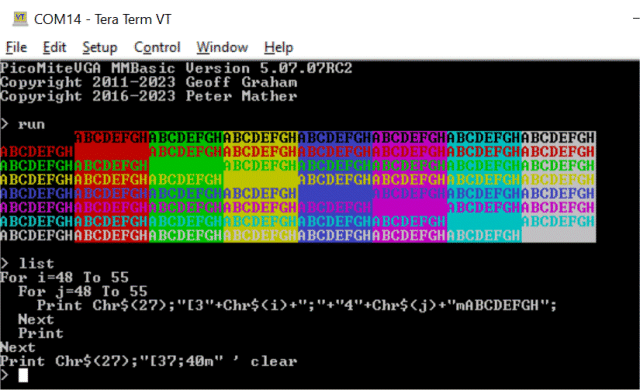

Code which produces this on PicoMite in Teraterm:
Produces this in USBterminal app (so background colors not honored):
For i=48 To 55
 For j=48 To 55
   Print Chr$(27);"[3"+Chr$(i)+";"+"4"+Chr$(j)+"mABCDEFGH";
 Next
 Print
Next
Print Chr$(27);"[37;40m" ' clear to white on black
Note that whatever shortfalls USBterminal may have right now, it looks like a pretty useful terminal for PicoMite development with just a cell phone.
Edited 2023-04-19 07:35 by lizby

  jaybek said  I too have a vision ... It's a combo of 4 elements, - a smartphone/tablet, usb-cable, picomite and a breadboard
You might have an interest in looking at this: PicoMite Experimenter Mini PCB
