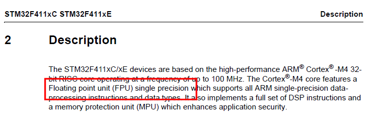

alas not backed up by the CPU datasheet. One hopes a mis-print.
Micromite floats are single (4 byte) in software. Double precision can be done in software but then the FPU is redundant - at least on the face of things. Unless double and single are supported but that would be a massive change to the firmware, affecting every point where numbers are evaluated (a lot).
using a SP FPU is a missed opportunity by ST I think, especially as they already have a potentially suitable fab from other CPUs

Only the M7 CPU have double precision floating point. FP on the 411 (M4) is actually disabled in my build as it slows performance when using DP

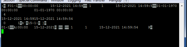

I loaded up my torture code but I am getting weird lockups (have to reset to recover). I can't seem to pin it down as they change each time. Nothing fancy in the torture code just stock MMBasic - I have attached it on this post. Can others download it and test on the BP? (it runs fine on all other platforms I have tried). Test 3.zip
> ? now()
15-12-2021 14:27:22
> ?unixtime(now())
15-12-2021 14:27:35     15-12-2021 14:27:35
0
Error : Invalid font number #8407069
> ?unixtime(now())
15-12-2021 14:57:52     15-12-2021 14:57:52
0
Error : Invalid font number #8407070
> ?unixtime(now())
15-12-2021 14:515-12-2021 14:57:54
0
Error : Line is too long to edit
and lockups after random output:
(needs a reset at this point)
that is more than enough for now, if you need more just let me know what and I will sort it.

Bug: your code is too complex and you are trashing the stack. The current version doesn't have stack checking. If it did you would see
  Quote  Error: Expression is too complex
Only solution is to reduce variable space and therefore program space from 72Kbyte downwards
