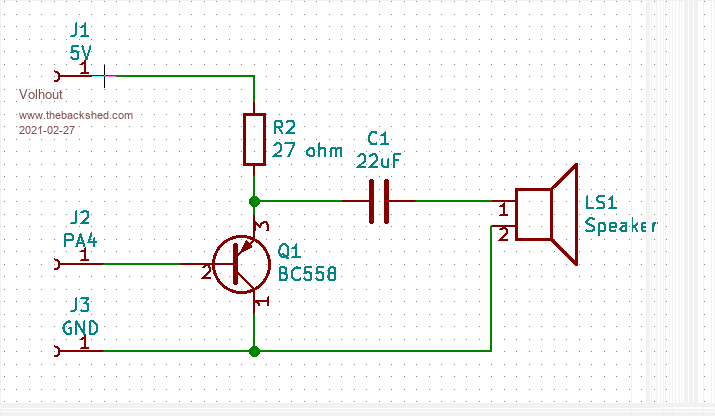

Posts: 6254
Posted: 12:20pm 25 Mar 2022
  Mixtel90 said  (Remember that you are looking for a linear sine wave output, ideally. Non-linear diodes and level shifters are not the best idea when what you really want is a low pass filter. :) )
Try it, you'll be amazed. With 1k resistor to the picomite current is around 2mA. The Ri of the diode is 25/2=12.5 ohm. This gives a 40dB rejection of the ripple of the 3.3V. Non linearity is of no importance, it simply clips the 3.3V PWM to 0.7V PWM. So amplitude is 10dB down, but noise floor is 40dB down -> 30 dB improvement.
I you want to drive headphones, try this circuit. Simple, cheap, and works fine.

Posts: 9329
Posted: 04:36pm 27 Mar 2022
@Volhout
I just got round to using your headphone output circuit while messing about with my VGA mini design. I think you might have a problem if you use it as shown with a Pico. A PNP transistor emitter junction will be forward biased and conduct the 5V directly to the Pico output pin, putting an overvoltage on it. If you swap the transistor for a NPN, with its emitter grounded, it should be fine - especially with a 1k base resistor to limit the current out of the pin. Another possibility is to use an intermediate NPN stage or to use a 3V3 supply and accept a drop in output.
Note that if the PWM output is held low (in the original circuit) or high (if using an NPN) then the transistor will pass 180mA from a 5V supply. You need a 1W resistor to be safe as it could dissipate almost 900mW.
The 27R resistor could be a constant current source of around 100mA or so to get a more linear output.
This configuration of output stage is horribly inefficient. :)  The transistor should be biased to get the junction of the transistor & resistor/current source at half the supply voltage with no signal. That would mean using a DC bias and capacitively coupling the PWM. The amp runs pretty warm and in class A so the quality can be good.

Posts: 3430
Posted: 11:31pm 27 Mar 2022
If I understand @Volhout's circuit it isn't linear, it is a digital current amplifier for PWM output. The filtering is done by the inductance & inertia of the headphones and by your ears, you just can't hear the PWM frequency.
The max. current through the resistor is (3.3 - 0.6) / 27 = 100mA = 270mW The average will be half that.
Edit - messed that up.
The max. current through the resistor is (5 - 0.6) / 27 = 163mA = 717mW The average will be half that. So a 1/2 W resistor should be ok.
5V won't be applied to the Pico pin as any base current flowing into the pin will turn the transistor on thus pulling the voltage down until the base current (and thus pin current) is a microamp or two. The Pico can cope with this.
Edited 2022-03-28 09:43 by phil99

What is the state of the pin when there is no sound? Logic 0 or 1? I think something a little more is needed, maybe a complementary pair of transistors between 0 and 3.3 volts with a base resistor of (say) 1K and 27ohm and 22uF in series with the output.
Bill
Posts: 3430
Posted: 06:07am 28 Mar 2022
"What is the state of the pin when there is no sound?"
One would expect it to be the PWM frequency with a 50% duty cycle.
As it is only for driving headphones any more complexity is overkill, IMHO.
If there is a low-pass filter between the Pico and the base it becomes a linear amp. However as it is an emitter follower it has plenty of negative feedback so the fidelity will still be very high.
Posts: 6254
Posted: 06:40am 28 Mar 2022
The amplifier circuit I showed earlier is a simple buffer for a high(er) impedance audio signal that is centered around 1.6Vdc. It was used in the ArmmiteF4 tetris game. The armmite has a real DAC output that does not require low pass filtering.
In case it is used for the picomite with PWM, you do need to use the low pass filter (1k+47nf) and then connect to the base of the PNP transistor. Due to the capacitor in the low pass filter (as long as there is modulation) the bias of the base of the transistor will not cause any problems. When the PWM pin of the picomite is switched to INPUT, it will (becuase of the PNP transistor base current) be driven to 4V, whee the current limit is in the 1k low pass filter resistor. I have not tested if this is a problem. I simply have PWM all the time.
For 32 ohm headphones you will be able to increase the 27 ohm resistor to something like 39 or 47 ohm. In a different thread I have shown a buffer that uses a current source, in stead of the 27ohm resistor. Performance of that circuit is better but it has more components.
Do not expect the amplifier to be "hifi". The transistor used in combination with a 27 ohm emitter resistor, will give the amplifier some non-linearity. That is why I improved the circuit with the current source later. But for the typical "game sound" this is good enough. Using a BC327 or 2N2907 or equivalent (relatively high gain, medium current PNP) gives better results.

  Quote  One would expect it to be the PWM frequency with a 50% duty cycle
For a program with no sound?
What happens if the Pico 3.3v supply fails? We have a 27 ohm resistor connected to 5v feeding the Pico input via a 'diode' junction. RIP Pico.
Sorry, not for me.
Bill
Posts: 9329
Posted: 10:28am 28 Mar 2022
There is no "average" output from a PWM pin. It is one of tristate, high or low completely under program control. Consequently you have to assume that the programmer (and it may not be you) has set the pin to something and it will always be worst case. So, the transistor can be hard on or hard off.
In the case of the transistor being hard on the only current limit through the 27R resistor is the emitter-collector drop which is pretty minimal. If it drops 0.2V then the current is 178mA and the power is 850mW. This can be continuous and you won't know about it unless you check the temperature of the transistor and resistor.
The transistor can't be hard off in the circuit as drawn. The maximum voltage on the base is 3V3 if the PWM pin is high and the emitter is 0.6V higher at 3V9. That gives a resistor current of 40mA.
If the PWM pin happens to be tristate then the base of the transistor is floating. Consequently the voltage on it is 5 - 0.6 = 4.4V. This is not good for a pin with a maximum rating of 3.6V. The fact that it's tristate doesn't matter - it still connected to two mosfets on the die, they just happen to be switched off. If you are lucky there won't be diodes formed in the substrate that might cause problems. Do you want to gamble?  :)
The easy getout is simply to run the circuit at 3V3, but watch the current if you are powering headphones from the PicoMite 3V3 rail as it has limited current and there are two channels. It may also be noisy.
Incidentally, there is no voltage gain in this circuit no matter what transistor you use. An emitter follower has to have a gain of less than one. It does have current gain though, which is where you get the lower impedance output. Whether it works better than a simple resistor direct from the PWM pin I don't know yet. :)

Hi Bill,
As long as you leave the collector of the transistor connected to ground, you will never exceed the base current of the transistor. With a hfe of 300, that is maximum (5-0.6)/(27*300)=0.5mA
That won't kill the chip.
But regardless, it is not for you if you .... ;)
Posts: 6254
Posted: 12:25pm 28 Mar 2022
  Mixtel90 said  There is no "average" output from a PWM pin. It is one of tristate, high or low completely under program control. Consequently you have to assume that the programmer (and it may not be you) has set the pin to something and it will always be worst case. So, the transistor can be hard on or hard off.
I like this kind of feedback. People analyze what you propose, and try to shoot holes in it. Thanks guys. You all feel hesitant against it, and that is fine.
But for a 32 ohm headset it is far better than a resistor, since the pico pins simply cannot deliver sufficient current. You can choose to thermally overload the IO pin by driving to much current, or adding a buffer. Any buffer (not specific this one).
The reverse bias current from the "tristate" IO pin however is 40mA/300 (the hfe of the transistor) so it is equal to 0.13mA. This will not kill any IO pin. Definitely not. Understand that these pins are typically soft ESD protected and these diodes will not suffer from 0.1mA. Absolutely not.
Anyway, no one is forcing you to use this circuit.
But .. it works, it is proven(*), it is simple, and free to use (no license involved).
(*) I use it in mu CMM2 for headset output, my ArmmiteF4 to drive a small speaker, and plan to use it on my picomite VGA when I get to layout phase.
Edited 2022-03-28 22:30 by Volhout
Posts: 9329
Posted: 02:08pm 28 Mar 2022
A quick & dirty simulation using Circuit Simulator gives current out of the base at 124.38uA into 3V3 and 525.84uA into 0V (with a hFE of 300). Of course, these are when the PWM pin is driven to its limits so it won't go overvoltage.
The RP2040 Datasheet doesn't give a current rating for the ESD system. If you prefer to put 4V4 on the pin rather than the absolute maximum stated in the Datasheet and trust that the ESD protection will carry the 120-odd uA then fair enough.  :)
