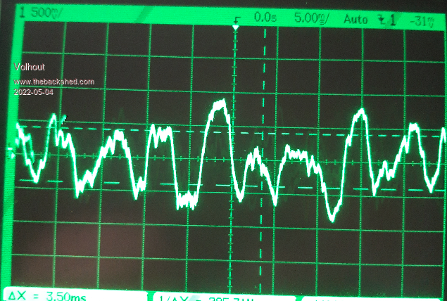

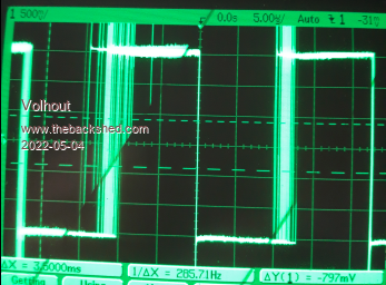

Posts: 6304
Posted: 06:01pm 03 May 2022
Hi Mick,
I just spend an hour measuring the audio, and it is difficult (read: needs big circuit) to get performance.
Just some pictures to paint the picture:
I copied a track from a CD onto SD card, Some guitar music from Harrry Sacksioni, a Dutch guitar player, accompanied by an orchestra. This shows dynamic and wider audio spectrum. Listening on a headset (did not dare my audio setup to this experiment).
1/ The PWM signal from the picomite
The PWM is clearly visible. If applied to a headset (470 ohm series), it actually sounds good. But you can clearly see that the 44kHz is dominant,Not good for a stereo amplifier.....
2/ The audio filtered by 470ohm and 47nf (actually 50nf).
Somewhere hidden in the trangular 44kHz waveforms is the hidden audio information. With this filter the 44kHz is still as large as the hidden audio.
3/ The audio filter (with transistor) I designed gives a much better signal. The 44kHz is still visible (the waveform is thicker than a noisefree waveform) but you can clearly see this is audio (this is on a different timebase scale).
But there are all kinds of noise and rattle audible in the audio.

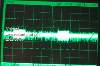

I have been able to lower the "random" rattle  by using.
OPTION POWER PWM ON
But there was still a repeating rattle that is caused by the pico and sd card.
I am not sure if it is the current the SD card uses, or the current the pico uses to read the SD card, but it shows a a lot of noise (in bursts) on the 3V3 and actually also shows on the 5V (due to load variations ?).These bursts are not present when you play tone, or when you stop the wave play.
I have added filters in both 3V3 and 5V to cope with it, but all in all I am not really happy with the size of the circuit. Lots of components.
This is a difficult beast to tame. Maybe the MCP1700 (I will order a few) will improve, probably on 3V3, but the 5V may still be noisy. Maybe it is better to design the audio circuit around a dual opamp (active filter + low impedance out) powered from 5V. Most opamps have good rejection of the noise on the power rails. And soldering 2 transistors and 2 resistors is not much different from an 8 pin DIL socket. And it saves RC filter in the 5V (electrolitic cap.)

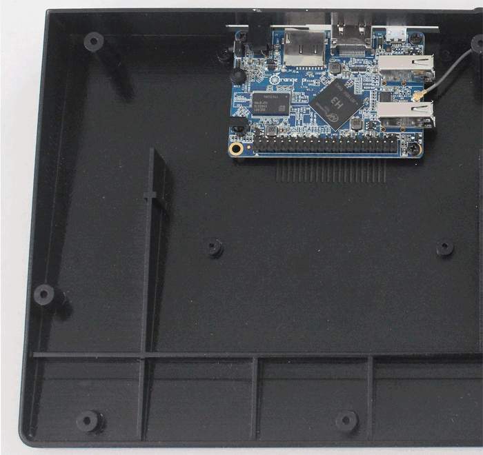

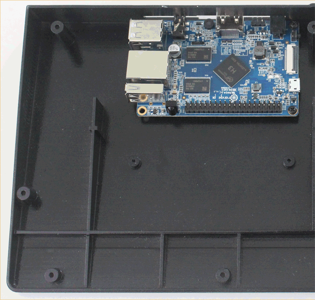

You have the TAUON-PC. Its AllWinner H3 board is removable and you can install Orange Pi Lite, Orange Pi PC, Raspberry PI Zero W, C-Sky board.
