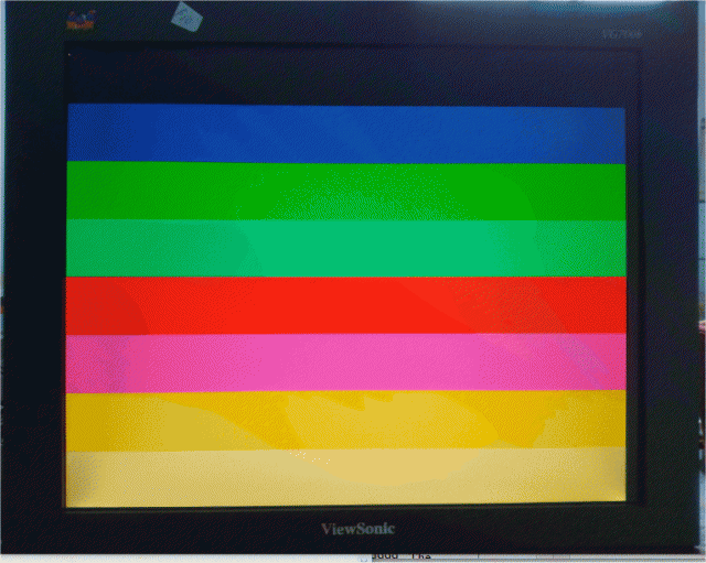

I snipped off all three diodes (D2, D3, D4), and now what I get is a slightly tan-ish white, regardless of use of RGB(red), RGB(blue) or RGB(green). Any further suggestions?

Type "mode 2"
Try again. The picomite is monochrome in mode 1

  Volhout said  Type "mode 2"
Thank you. That did the trick, though white is on the yellowish side (not that it matters to me--yet).

Posts: 6035
Posted: 07:38pm 22 Aug 2022
Hi Lizby,
The white balance should be far better that what your monitor shows.
Maybe you have swapped 2 resistors. Check:
GP21 connects to a 270 ohm resistor
GP20 connects to a 390 ohm resistor
GP19 connects to a 820 ohm resistor
GP18 connects to a 270 ohm resistor
Do not put diodes in

Posted: 10:53pm 22 Aug 2022
No diodes (at D2, D3, D4), but I didn't swap the resistors from what the board having the resistors showed. If I get back to it, I'll swap the resistors for the values you suggest. DMV showed that the resistors are as specified on the board (but correct diodes were supposed, so that may explain the colors I see).
