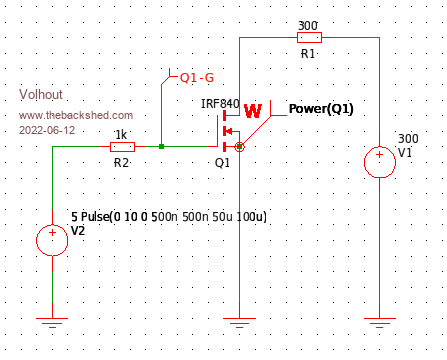

Posts: 6034
Posted: 07:20pm 11 Jun 2022
Hi Guys,
Just wanted to show you some graphs from a simulation, about driving a mosfet from a picomite pin.
There where circuit suggested by several, and I want to shed some light on the proposals, and show what the impact is.
Let's take a standard IRF840 FET (500V 8A) switching a resistive load of 1A at 300V. The gate is driven with 10V.
In the schematics you can see that the series resistance is 1k ohm (just for the demo). The waveform at the gate is shown below.

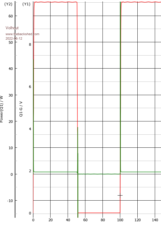

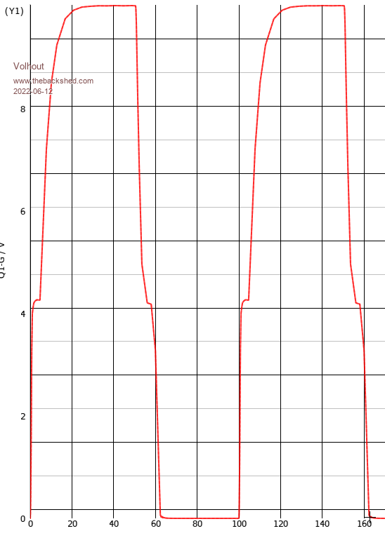

There is no steep switching ON and OFF, but there is a flat area in both rising and falling edge. This is caused by the internal capacitance of the MOSFET. While the gate voltage rises, the FET starts to conduct, the drain voltage falls , and while falling it couples negative charge into the gate. Like a feedback.

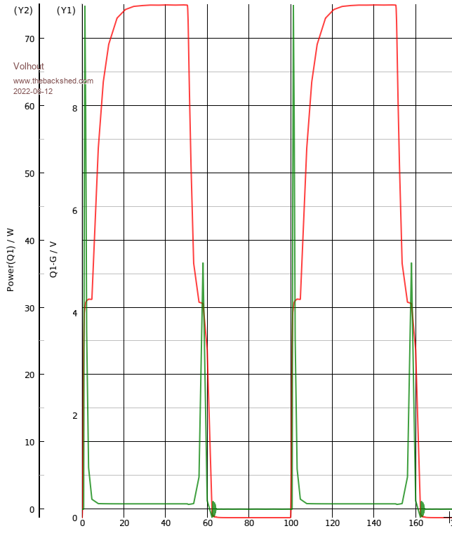

To see the effect on the FET, see this picture
This is the same picture, but in green is shows that the dissipation inside the FET. You can see that despite the FET is only switching 300W, it dissipated peaks of 70W during switching. Again, for a FET of this type, that is not dagerous, but you will be able to feel that the part is a bit warm if you drive it with 1k in series with the gate.
If you drive the gate with 50 ohm, the FET switches faster, and although the peak dissipation is 60W, the duration is far less, so the part will not heat up at all.
So if someone wants to drive a FET with 10k series resistance, using an optocoupler, you may want to look at a heatsink for the FET.
Needless to say that the bigger the FET (more current) the bigger the silicon, and therefore (most cases) the bigger the capacitance. If you want to drive your MOSTFET from a picomite, you should use a high current capable driver. -or- accept the FET heats up.
