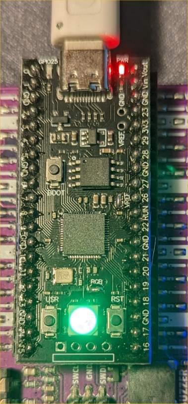

Posts: 6619
Posted: 02:26am 23 Jan 2023
  Quote  I've just got a few of these (16MB version) from Ali Express and they appear to be OK
Mine arrived today so your post was timely.
My attempt at CPUSPEED 250000 also failed.
I haven't tested all options but when I ran this program at 200000, the led flashed green bright once per cycle.
at 133000, the led flashes white.
With the faulty line of code changed to the commented out line, both speeds were the same.
Because of the difference in operation at 200000, I will treat any speed increase with caution.
DIM b%, n% =1, k% = 1
SETPIN GP23, DOUT
DO
BITBANG WS2812 O, GP23, 1, b%
PAUSE 300
b% = RGB(n%,n%,n%)
n% = n% + k%
IF n% >= 32 THEN k% = -1
'if n% <= 1 then k% = 1
IF n% = 0 THEN k% = 1 ' this is the faulty line
LOOP UNTIL INKEY$ <>""
BITBANG WS2812 O, GP23, 1, 0
I added a flying lead to the WS2812 instead of closing the link so I could use any IO for it.
The same abnormality is observed when using another IO pin sometimes resulting in a different colour.
Edited 2023-01-23 12:27 by TassyJim

Posts: 9152
Posted: 08:15am 23 Jan 2023
My own suspicion is that the speed limitation might be due to slower flash reading or access time. The RP2040 is probably the same chip - it probably isn't worth cloning them. That only leaves the clock oscillator and the flash - and China has a long history of producing both.
The difference in temperature could possibly be down to whether the RP2040 package was bonded to the pcb prior to soldering and if so what with.
Peter probably did the code for the WS2812 from the data sheet as the B version is more common. It may not have been tested with an actual O version until now - and there's no guarantee that the ones used on these boards are up to spec anyway. :)
Still, for the price....

Posts: 6619
Posted: 09:35pm 23 Jan 2023
  matherp said  PS: If is doesn't run at 252MHz try 378MHz. For the higher speed I halve the flash clock speed ( so 189MHz) whereas at 252MHz I don't
378MHz results in a lockup so it looks like I will be staying at ~180MHz for my units. That's not a problem, I rarely need the speed.
I tested the onboard WS2812 on a 'normal' picomite. Having it on a fly-lead instead of closing the link came in handy.
At 378MHz, the led showed the same flash of (usually) green when it should be off.
Posts: 11914
Posted: 10:43pm 23 Jan 2023
I assume this is the same? Works perfectly at 378MHz and with BITBANG WS2812 O,GP23,1,RGB(whatever). Sounds like you have them out of a duff batch.
