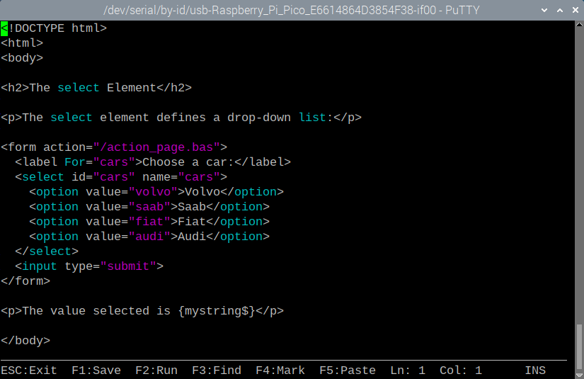

This is probably a trivial thing for most, but when I want to make a quick change to the HTML page I am testing, I bring it into the editor and then save it out to the sdcard.
Example;
The /action_page.bas is WIP (don't ask).
Thought I would just mention this,
Hans ...

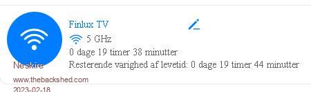

Joined: 17/04/2022
Location: Denmark
Posts: 9
Posted: 10:11pm 17 Feb 2023
Test PicoMiteWebV5.07.07a18.uf2
Clean_flash and start from scratch.
Terminal Teraterm
> OPTION TCP SERVER PORT 80,4500

After a few minutes no response in Firefox/Crome
Disconnected from router
Ctrl C
> run
ntp address 162.159.200.123
got ntp response: 17/02/2023 21:13:49
Not connected to router
No response to Firefox/crome
Ctrl C
> ? mm.info(ip address)
192.168.8.105
> run
ntp address 194.58.207.20
got ntp response: 17/02/2023 21:16:11
No response in Firefox/Crome
Power off, power on

Working again for a few minuts, then the same history again.
Testet V5.07.07a17 and V5.07.07a16, same behavior.

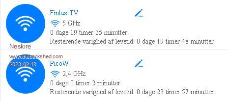

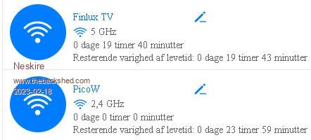

@matherp
I am running your 2023-02-07_040659_simpleweb.zip on PicoW using PicoMiteWebV5.07.07a18.uf2 as firmware. It works exellent and fast, but after some minutes idle (no request from browser ca.2 - 20 minuts) it no longer respond to a request from the browser. In the router PicoW has disappeared from the device list. After a powerreset the PicoW is working as server flawless again. In the router PicoW is again in the device list. It seems to me as some kind of timeout when in idle.
Browser problem ? using Firefox/Crome
Best regards
Erik

  Quote  In the router PicoW has disappeared from the device list.
Anyone else see this? I'm not aware of any timeouts in the wifi code but there may be.

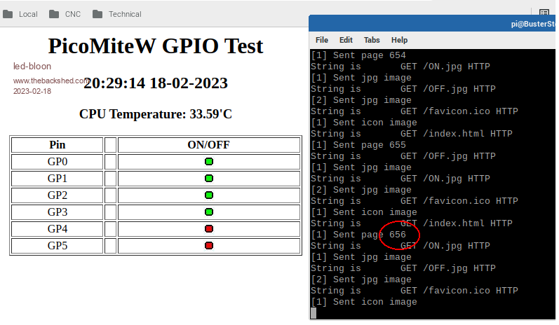

I've now run the self-updating web page all night at 5 second repeat and it is still working happily this morning - PROGRESS

Posted: 09:39am 18 Feb 2023
BIG PROGRESS! Not overnight yet, but doing great.
Thanks Peter...
2 browsers hitting it.
led
