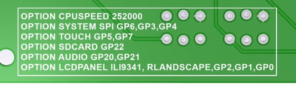

Posted: 08:39am 25 Jul 2023
  thwill said
Final(?) schematic and gerbers will follow once the kinks have been ironed out.
Hi Tom,
Unfortunately, this cannot be read exactly on the photo.
What "options" did you use?
Edited 2023-07-25 18:40 by Martin H.
'no comment

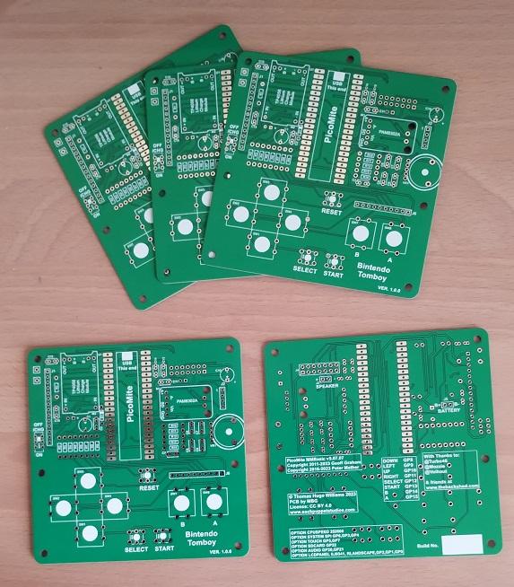

Posts: 4412
Posted: 09:14am 25 Jul 2023
  Martin H. said  Hi Tom,
Hi Martin,
Note that despite my recent silence I haven't "gone away" or given up on this, though the day job is more of a time sink at the moment.
We're just waiting for samples of v1.3.0 of the PCB to arrive from JLPCB, and are hopeful this will be the "final" version. It has a more conventional sound circuit that no longer requires the use of the MONO flag to PLAY SOUND, this means that a programs sound routines don't need to be specially written. In addition it now has a choice of the 2.8" or 3.2" ILI9341 display.

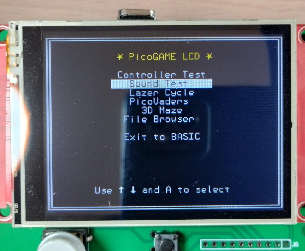

I'm still working on the software, your works play a starring role:

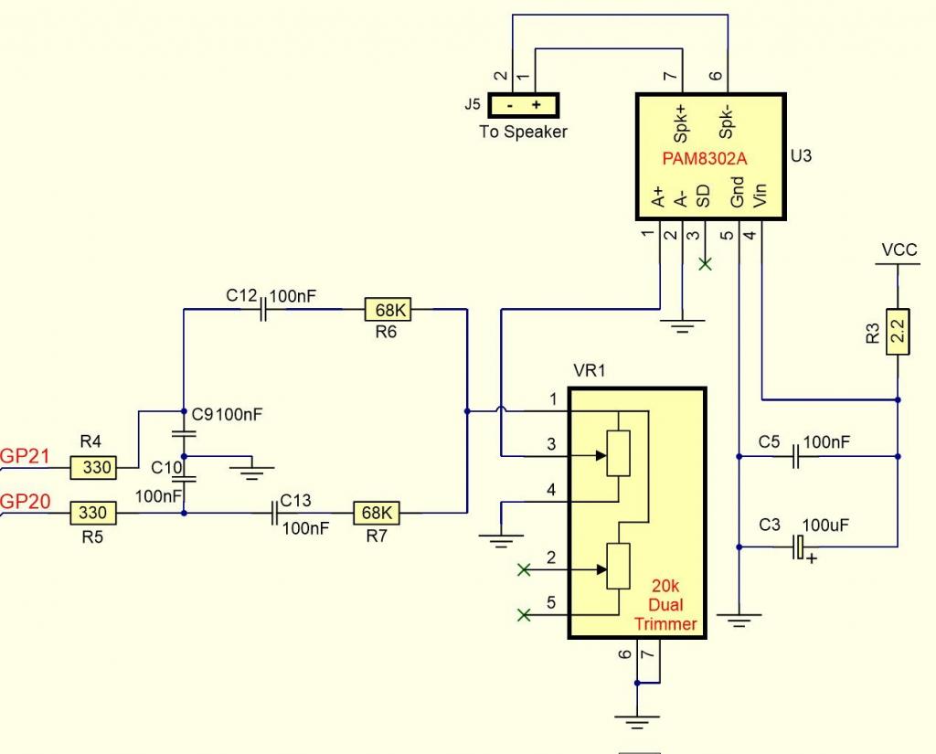

Posts: 3891
Posted: 10:48am 25 Jul 2023
Can you post your "more conventional sound circuit", Tom? I got lost in all the variations.

Posts: 4412
Posted: 11:39am 25 Jul 2023
  lizby said  Can you post your "more conventional sound circuit", Tom? I got lost in all the variations.
I got lost too, I'm still not sure I've been found .
Basically it mixes the PWM stereo signal and then amplifies it using "half" of the PAM8302A (and half of the stereo pot. which can be replaced by a mono pot.)
Please don't start another endless debate about the audio, at least not in this thread. This works reasonably well, at least for the speaker I'm using, and it is what is going on the PCB. If someone wants to do differently then there will be opportunity to play after I have "released" it.
Posts: 4412
Posted: 11:42am 25 Jul 2023
Hmm, now I look at that stereo pot. I think something went "screwball" on the internal diagram at some point, it seems unlikely that pin 1 on the package is attached to both pot's as illustrated.
Posts: 6304
Posted: 11:59am 25 Jul 2023
Pin 1 should be used as common ground pin. Since this is most likely a audio potemeter, it will have logaritmic curve. When you use the wrong pin for ground the curve is wrong, and it will be very hard to adjust the audio level conveniently.
I think you may want to put some wires on the board swapping pin 1 and 4.
Edited 2023-07-25 22:02 by Volhout
Posts: 4412
Posted: 04:00pm 25 Jul 2023
  Volhout said  Pin 1 should be used as common ground pin. Since this is most likely a audio potemeter, it will have logaritmic curve. When you use the wrong pin for ground the curve is wrong, and it will be very hard to adjust the audio level conveniently.
Yes, I agree, that appears to be what has happened. It works because we are only using half the pot. but I'll have to experiment to see if it works better with 1 & 4 swapped.
Posts: 2984
Posted: 04:54am 26 Jul 2023
Hi Tom, Volhout, All,
I can confirm that the Dual pot (at least the ones I have) are indeed 'Internally' wired as per the diagram above, Further to that the taper is Linear as at the half way point I get 10k from Pin 1-2 (and 2-5) and Pin 1-3 (and 3-4).
If you remember Tom I mentioned that the Pot seemed to work in reverse, Fully anti clockwise was full volume and vice-versa. However as it is a wheel sticking partially overhanging the PCB it `also' makes sense as UP is louder and DOWN is lower.
IMHO, the pot does quite a good job and is easy to adjust to your desired level.
My speakers like the ones you bought Tom arrived today and they are marginally softer than the old transistor radio one I used, however they are still reasonably loud and when put in the sandwich of 2 PCB it will probably make a bit of an echo chamber.
Kind Regards,
Posts: 9407
Posted: 07:57am 26 Jul 2023
It would be interesting to try adding a resistor directly across the amplifier input (slider to ground on the pot. About 3K3 or 3K9 should be about right. This will make the control more logarithmic and make the volume a little easier to adjust. You generally use 12% to 20% of the pot value depending on the impedances so it's something to experiment with. You may lose a little output with the lower values.
Posts: 4412
Posted: 10:10am 26 Jul 2023
Hi folks,
I've had another play with the device this morning and as illustrated by the above schematic and built from the parts I've got, the volume control is "just fine".
I will admit that now I've noticed the fact that the signal (rather than ground) is on the common pin 1 does cause my OCD discomfort however unless @bigmik and I have other cause to respin the PCB I'm going to let it lie.
  bigmik said  f you remember Tom I mentioned that the Pot seemed to work in reverse, Fully anti clockwise was full volume and vice-versa. However as it is a wheel sticking partially overhanging the PCB it `also' makes sense as UP is louder and DOWN is lower.
Yes, I recall, thanks Mick.
Posts: 9407
Posted: 10:23am 26 Jul 2023
If it's working nicely then don't change it. :)
