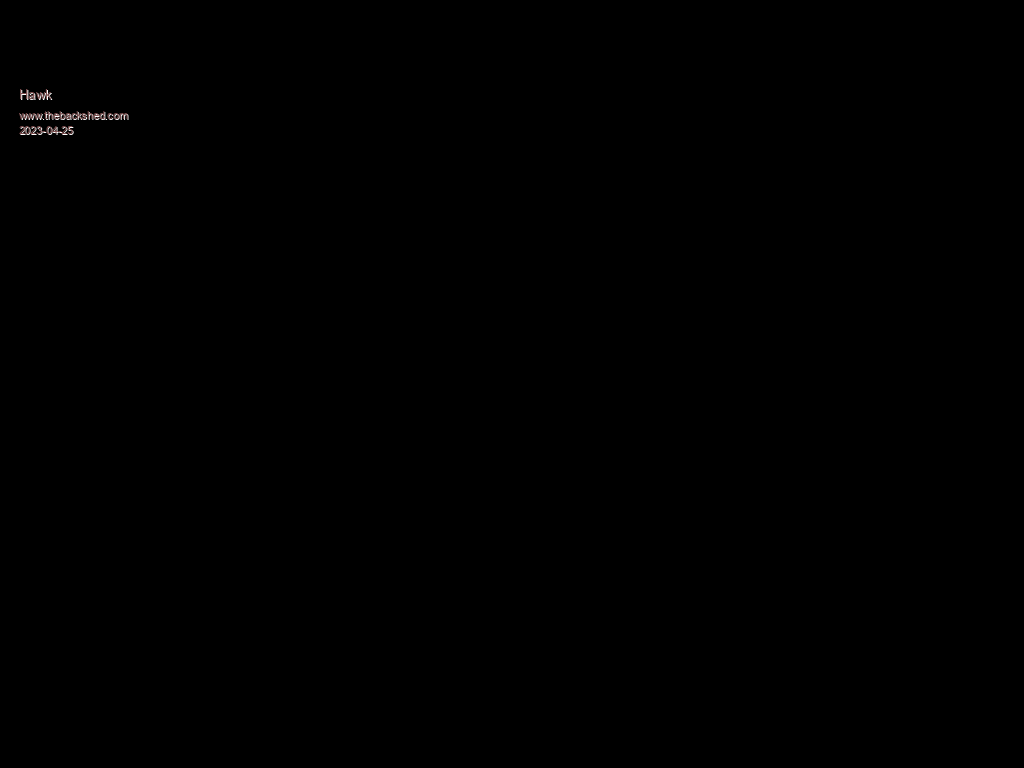

OK so I finally finished my Silicon Chip kit build.
It was super easy, right up to the point where they left the 2N7000s out of the kit.  At first I wondered why the keyboard wasn't working.  I worried that my power supply wasn't big enough.  Then I noticed the empty holes!  Luckily I had some on hand from another project.
Anyway, here it is all setup and operational.
No sound (of course) and I haven't configured the SD card yet.  Time to learn how this baby works!
One of the first things that I did notice is that the fonts are different sizes in Mode 2.  The test printed from the program is one size, but the text typed in at the command prompt is a larger size.  That was unexpected.
Posts: 3466
Posted: 08:40am 25 Apr 2023
Mode 1 is 640 x 480 and Mode 2 is effectively 320 x 240 so the console font is double size. Console font size can be adjusted.
