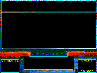

Here is the adjusted replacement image for game_c.bmp.
Edited 2026-03-11 18:16 by Martin H.
'no comment
Posts: 6227
Posted: 08:34am 11 Mar 2026

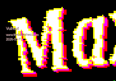

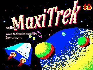

Do you have tools to smooth out "title_c.bmp" ?
It looks like when expanding the original BMP to 320x24 some irregularities where caused. This is especially visible at the M and a in MaxiTrek.
Or can this only be done bys pixelpainting manually ?

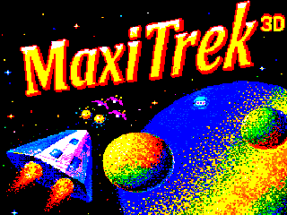

Martin H.
Joined: 04/06/2022
Posts: 1574
Posted: 09:19am 11 Mar 2026
The spaceship and planets have been made a little more vivid, and the font has been adjusted.
Without straying too far from the original.
Edited 2026-03-11 19:24 by Martin H.
