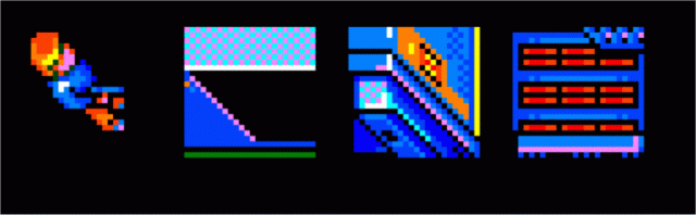

Martin H.
Joined: 04/06/2022
Posts: 1570
Posted: 05:56pm 21 Sep 2023
  lizby said
  Volhout said  This is research...
Following these steps with a Picomite with ILI9488 and adding FRAMEBUFFER creation and writing results in this (small portion of otherwise blank screen):
Does this make sense? Does it include everything you would expect?
as the N-Screen on Pico (without VGA) uses the Memory of the LC Display, you should be able to use the Framebuffer for the graphic-operations and Framecopy it to N.
AT the Moment i have no Pico with LCD Working, but I will test the implementation, when Toms Game*Mite arrives :-)
'no comment
Martin H.
Joined: 04/06/2022
Posts: 1570
Posted: 06:15pm 21 Sep 2023
  Volhout said  Hi Martin, Lizby,
Once you have the library filled, it will remain until you do "LIBRARY DELETE".
For this code to work you need the world map that martin provided in the Data folder.
So copy previous ZIP files in the game root directory.
And run above program.
I will test it tomorow, No Pico today, just MMB4W
At the moment I'm in the process of giving the sprites a frame so that they can stand out better from the background.
From                      ---->            To
Like Imagine / Ocean often done for Spectrum
'no comment
