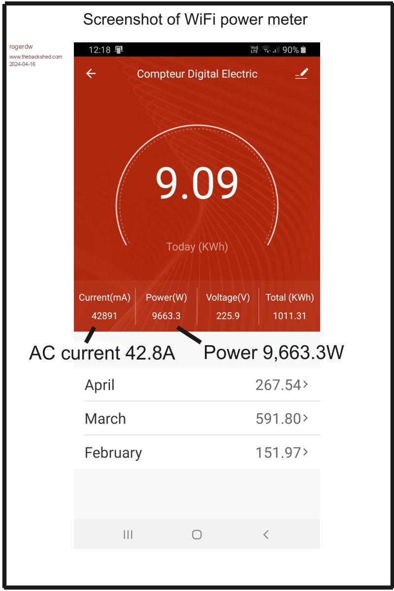

Yesterday we had two segments of underfloor heating running (6,000w total) along with the normal house load for 4 and a half hours  ...  then turned half off and ran the other for an extra hour.
Seemed to handle it okay. The electronics stayed cool  ...  just a few degrees above ambient, but the larger two toroids started to warm up to around 50C  ...  so turned on a pedestal fan which brought them back down to lower 40's. I need to fit the barrel fan I have planned.
Today I'm running both heaters again and I happened to spot the total load right up at 9,663 watts at one stage. Gulp!!
The load pulled the output voltage down to 225.9v at the inverter  ...  and lower again up in the house at the heater connections  ...  so it's time to fit the "feed forward current correction" that Klaus used.
I have the current transformer on the input bus, so just need to find/work-out the rest of the process.

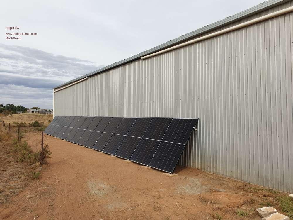

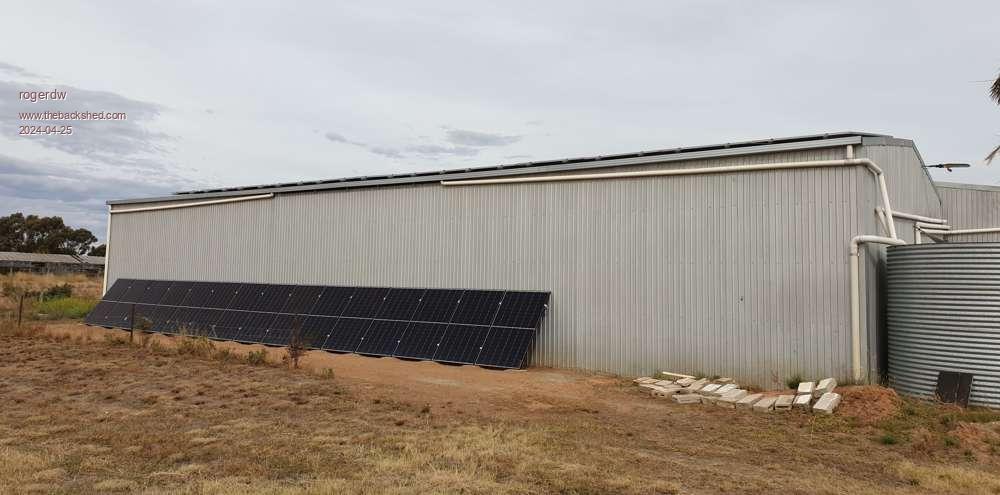

I picked up another batch of panels, rails and a 5kW Growatt GTI from Marketplace last weekend. 15 x 440w Jinko panels for an extra 6.6kW. It cost me $1,000 but I had to remove them from the house which is slated for demolition.
I've leaned them up against the north facing wall of the shed and fed them in two strings into the GTI. They are all clamped together with a rail all the way through and all the bottoms clamped together  ...  then tied to the shed.
It was time to jump into ac-coupling so I hooked it up and turned it on  ...  and stood back. It all seemed to go smoothly and very slowly started to ramp up  ...  and as its output rose, the Warpverters dropped correspondingly. Was exciting to watch.

24 x 250w = 6kW
24 x 275w = 6.6kW
15 x 440w = 6.6kW
Of course now that I want to see what she'll do, the weather has been very uncooperative  ...  though I did have a period where it was very impressive. I had both lots of underfloor heating turned on (6kW) plus the normal household load 1-2kW.

Yes it faces directly north  ...  very convenient layout. I was being lazy I suppose but the inverter is only a couple metres inside the shed from the right hand end of the panels, so it certainly saves in cable too.
