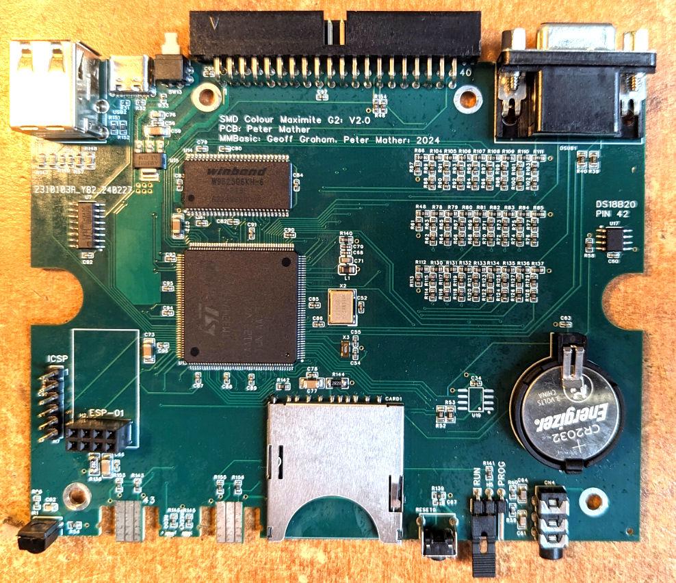

Hi Peter,
- no RTC
- solder mask on the rightmost contact for the nunchuck
- R144 seems retrofit (is soldering okay ?) feels like it has solder on the part, but maybe not on the pads. -or- the footprint is too small. Similar to the 2.2 ohm resistor at the ESP-01.
Posts: 12008
Posted: 01:36pm 06 Mar 2024
Didn't ask for the RTC as they are expensive and I wanted to minimise cost if there might have been issues.
Nunchuk connectors should be fine, just the way I laid it out
R144, R138, U7, U17 + all through hole were soldered by me - extended range parts that I had stock so omitted from the build
Video beautifully clean and audio no discernible noise

RTC now added and working
Just checking out the performance of the new board
The CMM2 G2 normally runs at a CPU speed of 480MHz but will overclock to 504MHz
The PicoMite normally runs at a CPU speed of 133MHz but will overclock to 378MHz

Whats the advantage of the external RTC in comparison to the internal RTC of STM?
Posts: 12008
Posted: 03:38pm 06 Mar 2024
  Quote  Whats the advantage of the external RTC in comparison to the internal RTC of STM?
Much more accurate. The internal relies on a typical 32Kz crystal which is subject to the usual temperature variations whereas the DS3231 includes an integrated temperature-compensated crystal oscillator (TCXO)
