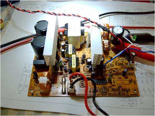

This is a generic 350W ATX PSU I re-wound for 48Vdc output. Worked, but needed better current control:

Looks like a 494 unit. the oztules current control will work on that I suspect. a few components and you will know. It'll make it very useful I should think.

yeah it was a TL494 system. I have a carton of Yaha units. I've played with the 494 since the mid 90's when we learnt SMPS in tech. Simple enough creature, but at the time I played with the ATX, I just wanted to see if it was possible. Scrapped it once I proved it would make 48Vdc.
On a side note, when I get time I'd like to map out the circuit for the aux +5 & +12V system that runs all the time. I'd like to make some pcb's and move the transformer (and useful bits) over to it. Would make a handy PICAXE PSU for various projects. Then again, I might go Oztules on its a$$ and cut the whole circuit out of the ATX pcb with a 9inch angle grinder

The circuit Dinges pointed to will give you a fair idea of a generic type. The ones I have bothered to take notice of use 2 transistors to create the free running oscillator.. but makes no material difference.

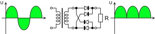

Dinges, as promised, I put a full wave rectifier on one of the ATX conversions. It puts out 44v@15A (very short time... just to get an idea... transformer will be the weak link first heat wise)
I used 4x d92 which gives the rectifier about 40A 200v. I might replace the little switches with some bigger types and push it a big harder.... see what explosions I can get going.
The current limit works perfectly on it as well. It will require a rewind to get any more out of it voltage wise... which is simple, and I would use a bigger core, and I suspect 500w would present no problems at all.
As it is it will do as a soft/float charge for a 36v battery bank (car) if the wind don't blow.
So the circuit as such seems to be quite stable. I may wind a bigger transformer... use bigger transistors, and see if we can get up to 1kw..... aiming for 108v@10A, and one at 56v@20A..... Heavy switching currents may introduce too much instability.... but it costs nothing to find out.

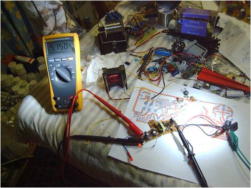

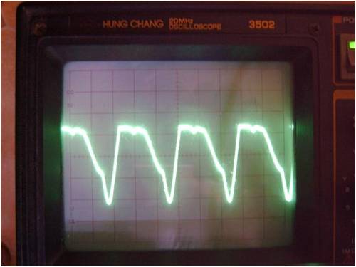

Couldn't help myself:

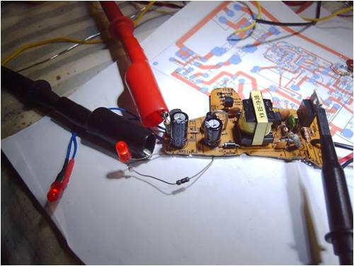

Marked out the PCB for angle grinder violence. Interesting to note the aux system uses about 25% of the board space:
PCB with 150ohm resistor on 5V rail & some LEDs for load. Once cut out, I used the bench grinder to clean up the edges:
Making 5.1V and about 18V on the other rail:
Waveform running at ~350Khz:
Transistor gets mildly warm, I suspect this is because it's almost a sine wave, as compared to if it were running from a PWM IC.
I ran it on 40Vdc first to make sure it was OK, but it would randomly not turn on, or only output a few volts. Thought it was the opto coupler, turned out it is truly tuned for 340Vdc supply. Once on mains, it ran quite nice. Its not exactly efficient, but it works and could be useful on wind gens for powering monitoring gear or something. I suspect that the little transformer would work well if I drove it with a UC3842 or such PWM IC.
Fun never the less.
PS: The 9inch catfish is enough of a handful - chainsaw only good for spectators.
sPuDd..

I just came in from playing with the full wave rectified unit. The waveform on the output is a perfectly clean square waveform... eventually... it wasn't always so.
.........oztules

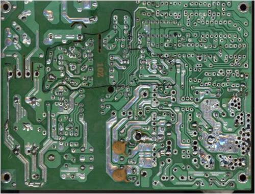

On a side note, I dismantled the main transformer in a genuine 550W ATX I had for a long time. I found both ends of the primary winding ended inside the transformer with an almost full wrap of copper strip. The primary measured O/C. The unit was working, just leaking caps. I'm assuming it was used like the pulse cap in series in most ATX units, but it already had one of them as well... odd.
sPuDd..

Sorry Spud,
That full strip/s is a shield "winding". Some have one some have two .....some have none....what noise???
It is to suppress noise, and is connected to where ever the hell they please.
Some with 2 shields connect both to one of the primary inputs, with each wrapped in the opposite direction to the other, others I have seen connect 1 to each of the secondaries.. the outer to the opposite input and the inner to the other input.... sometimes to the same input. You should of had to chew through the outer primary half to get to the first shield. The second shield should have been before you peeled of the last primary half (the last wires on the bobbin).
Yours sounds like one to each input. There will have to have been 2 windings there of probably about 19T on the outer most, and inner most windings. They will connect as a centertap (blanked off from the world... usually between the two input pins but cut off short). If during dismantling, you disconnect this CT, it will show open circuit... maybe thats where the confusion came from. Pulsed DC needs to have a material path to travel... capacitive coupling wont do.
The capacitor that supplies the DC power to the primary is ok however, as it is pulsed in both +- and then -+ depending on which switch is closed.... 1/2 mains potential each/ opposite way....
Hope that clears it up.
..........oztulesEdited by oztules 2009-05-18

I suspect you may be right, I even drew pictures and took notes as I dismantled it, but perhaps I missed the centre tap. Has me wondering now. I agree that a continuous winding is required for it to work, but there is some sneaky designers out there that have never wielded a revving chainsaw while laughing like a maniac, let alone seen sunlight.... you never know what these disturbed individuals will come up with next

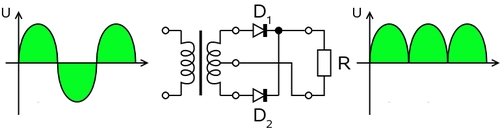

Your full-wave bridge rectifier modification had me wondering for a while; didn't see how it'd nearly double output voltage (from about 24V to about 46V). Till I realized: the transformer is centertapped! Doh!
Normal operation is like this:
which you modified to this, I think?
So, basically ignore the centertap (leave disconnected) and connect the bridge rectifier diodes to the two end-connections of the transformer? Probably is trivially simple for you, but I've been thinking about this for a few days trying to figure out how it could work. Till the centertap thing hit me. Feel like an idiot for not thinking of that earlier.
In that case, we shouldn't expect to get the same amount of current out of the transformer, as the wiresize is no longer adequate. Besides, doubling voltage at the same current would lead to doubling power... probably leading to an unhappy little transformer.
Also, for current-control to work in that case, you wouldn't be using the old flying-lead wire with a bit of wire inserted to lift 'ground' up a few mV, but you'd insert the wire between the negative terminal of the bridge rectifier and the rest of the circuit? Same principle though.
15A at 46V... I hope you wear safety glasses and earplugs when playing with it.

Dinges,
Your assessment is basically correct.
Current control is on the negative to earth (centertap lifted out of the board and terminated). Same piece of wire loop and same circuit.
The output windings see the same currents as before, but the duty cycle is doubled. Being only 4turns and 2 1/2 turns, of pretty thick wire, there will be little extra heat from here. The primary will be expected to do twice as much as before though, and it is 19Tx2... so I would expect that to heat up considerably if you double the output for any period of time. Saturation is the main problem I suspect.
The transistors will need better heat sinks than some I have seen, but generally, the ATX have better cooling fins than some of the flat excuses I have seen in the AT.
The transformer in this particular ATX is pretty robust, with .8mmX2 and X5 for the 11 turns... a lot of copper... very small resistance. The primary though is only .8mm for38 turns... still only 3 or 4 feet of wire... but this will have to carry an average 3A or so if we want 400W out of it.
