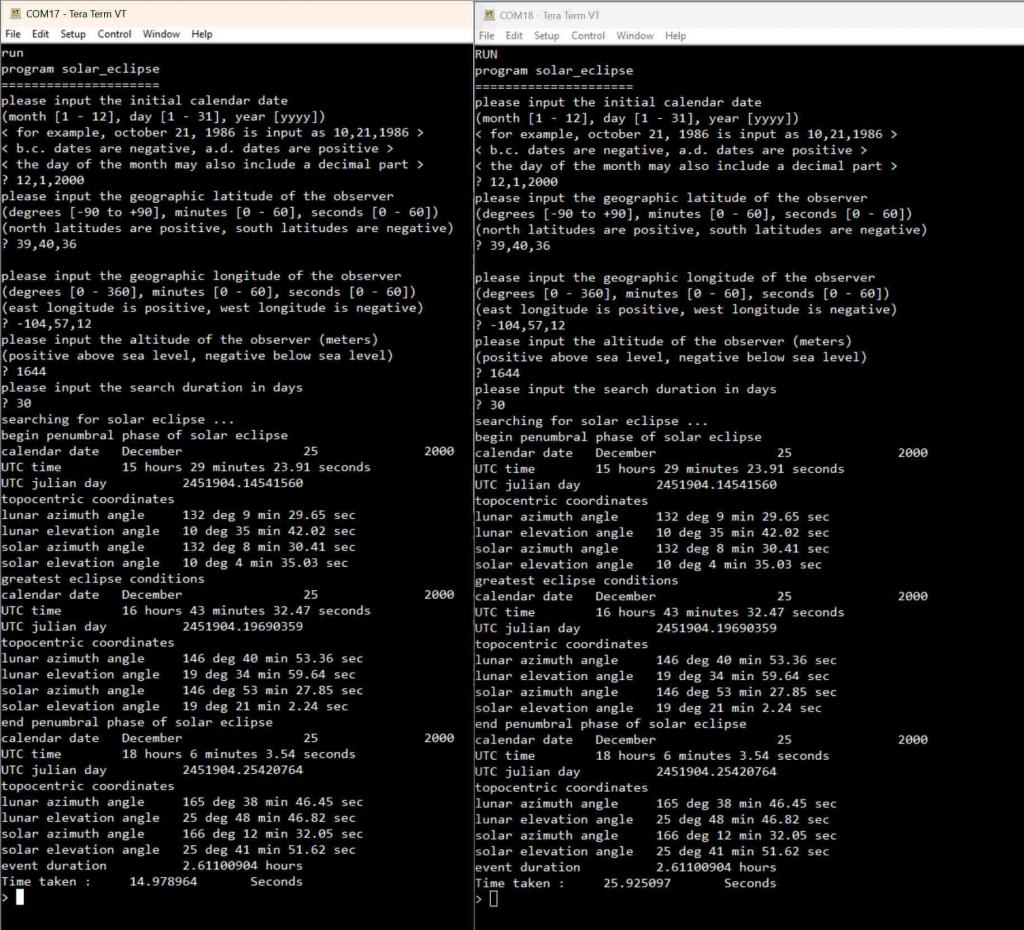

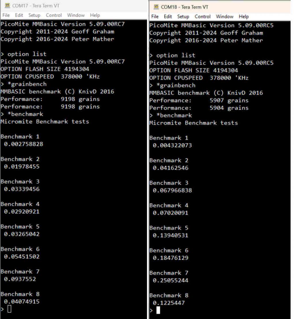

RP2350 on the left
CMM2 Grainmbench 18131
Benchmarks 0.001588,0.01054,0.01778,0.01563,0.01749,0.030488,0.05367,0.02464
CMM2 : 7.227 seconds

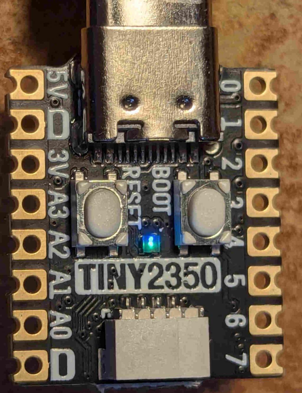

Very nice, Peter. Ok, so not up to CMM2 speeds but we didn't expect it to be - and it's a little bit cheaper. :)
Impressive little board too.

So the 2350 is 1.7x faster than the 2040.
And you succesfully overclocked it at 378Mhz.
Those are both positive signs. Nice work Peter!

I'm sort of surprised that the Solar eclipse calculations aren't a lot faster, as I assume there would be a lot of floating point maths, maybe not.
But looking great already.

Man, BM 5,6,7,8

The difference between BM4 and BM5 is that BM5 has a GOSUB
The RP2040 takes an extra 69µsec for this, whereas the RP2350 takes only <3.5µsec
Actual MMBasic code gets more than a 1.7 X boost in performance
Exciting stuff

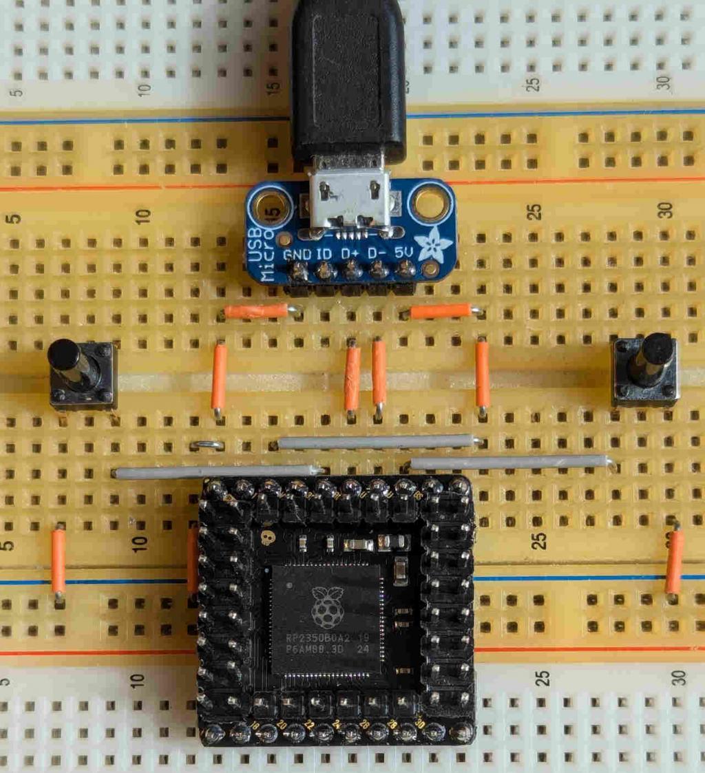

The big change was upgrading the sdk to V2.0.0
The RP2040 code then compiled pretty much as-is, just a few #ifdef clauses to account for minor changes and a bug in the sdk which took a couple of hours to track down.
My intention is to make little of no functional changes other than to support both the 60 and 80 pin chips.
Here is my 80-pin development environment

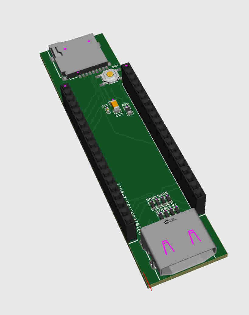

The biggest bit of work will be to try to port the VGA version to HDMI using the new HSTX peripheral. I don't currently intend to change colours as that would lead to program incompatibility with the RP2040.
Waiting on these to arrive from JLC
