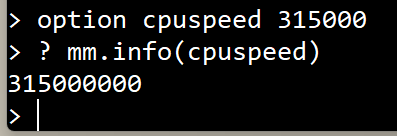

Posted: 11:36am 28 Aug 2024
Pico Plus 2 doesn't like 378MHz (different flash?)
300MHz is no problem.
Posts: 6253
Posted: 11:42am 28 Aug 2024
It was to be expected.
In Pico2 the QSPI bus is between RP2350 and flash chip.
In Pico2-plus the QSPI bus is going from RP2350 to 2 devices 1/flash and 2/PSRAM.
The extra load (PSRAM) may limit the speed at which the bus can be used. Even if the PSRAM is not used, it loads the bus.
I hope it also works at 315MHz, since that is the CPU clock needed for HDMI.
