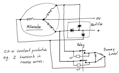

  Gizmo said   No Sparky this type of circuit is best used as a dump controller. One important factor in using a wind turbine is the alternator/generator must remain loaded at all times. You should never let a wind turbine free wheel, because they will over speed, the output voltage will rise signicantly and there is the risk of mechanical damage. Solar cells are a different matter, its OK to open circuit them.
So a dump controller works by draining off the excess power generated by the wind turbine. In Lens circuit, you would use the relay contacts to switch a dump load across the battery. This dump load will drain off a lot of power, keep the windmill spinning at normal speed, and stop the battery overcharging.
You can also use the circuit as a diversion controller, using a set of changeover contacts in the relay. In that situation, the windmill output is fed either to the battery, OR, a dump load. Its a bit more complicated to set up, and there are dissadvantages to a diversion controller, including voltage spikes, mechanical loading, and less safety margin.
With a dump controller, the output of the alternator is always loaded by the battery and occasionally also the dump load. This means no voltage spikes or wild AC to deal with.
Thanks for explaining that Glenn, I had a feeling that Sparkey was asking for a different circuit to my version of your circuit.
So my understanding (& please correct me if I'm wrong) of a Dump Controller is this:-
Using your figures, the relay operates when the generator voltage reaches 14.5 Volt & releases when it falls to 13.0 Volt. This is what my version does.
When the relay is operated, the make side of the change over contact connects a dummy load across the generator output.
So, I assume that there is a diode in series between the Generator & the Battery so the Dummy Load does not drain the battery also.
So, if that is the case, I don't see any difference between a Dump Controller with a diode & a Diversion Controller with a change over contact to divert the Generator output to the Dummy Load. However, there is a difference; since the C/O contact disconnects the battery, then the voltage spikes will be an issue since the battery is not there to attanuate them.

Almost, but omit the diode. The wind turbine alternator is connected directly to the battery, minimising losses. The dump load is placed across the battery, effectively draining it, bringing its state of charge, and therefore voltage, down. If the windmill is capable of making 300 watts, then the dump load would need to drain off more than that, say 400 watts. So in strong winds, when the battery becomes fully charged, the dump load is switched across the battery and drains off 400 watts ( 300w from the windmill and 100w from the battery. ). This keeps the windmill loaded, and discharges some of the battery charge.

Posted: 12:05am 11 Nov 2011
Glenn,
It seems a pity to load both the battery & the generator. This is a waste of energy.
You said above, that my suggestion re inserting a diode is undesirable as it would drop the voltage.
Here are 2 suggestions:-
2. Have you considered using a Schottky diode? As you know, they have a lower voltage drop than silicon ones. If necessary, you could connect several (Schottky's) in parallel to reduce the voltage drop.
2. The alternator has a 3 phase rectifier. So if the anodes of these diode are accessable, then you could connect the load resistors as shown in the drawing & thus a diode would not be necessary & thus there would be no additional voltage drop & the battery would not be discharging into the dummy load.
Moreover, the resistors will dissipate less power & thus can be of a lower power rating than otherwise.
Len

Posted: 07:51am 11 Nov 2011

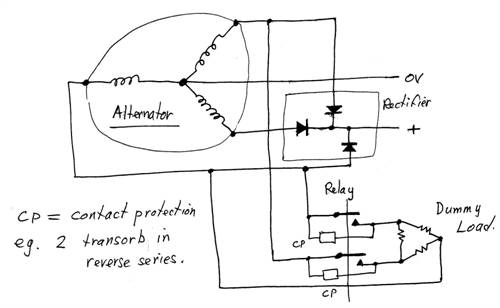

larny
Joined: 31/10/2011
Posts: 349
Posted: 08:19am 11 Nov 2011
  sparkey said   you dont appear to have one of the phases loaded is it that the other phase is not nesscary...
Yes, sorry, you're right. Drawing error.
I'll fix it & replace.
Edit.
I could not edit my previous post, so here is the modified drawing.
Len
Edited by larny 2011-11-12

dont missunderstand me here but has glenn stated which type of generator he is using ...star/delta... i guess a star always has a neuteral well then mine must be a delta because it only has three wires comming from it i did not make it myself it is a bought unit ....500 watts
larny
Joined: 31/10/2011
Posts: 349
Posted: 08:20pm 11 Nov 2011
Sparkey,
No Glenn did not tell me whether he has a star or mesh alternator.
I drew a star configuration as a guess.
However, it makes no difference to my circuit.
The resistors are connected between the alternator & the diodes.
LenEdited by larny 2011-11-13

also a delta has a different wireing configureation and would require a different diode bridge...but the relay load should be the same....
larny
Joined: 31/10/2011
Posts: 349
Posted: 01:04am 12 Nov 2011
  sparkey said   also a delta has a different wireing configureation and would require a different diode bridge...but the relay I think you mean resistorload should be the same....
Yes, it has 6 diodes rather than 3, but there is no difference as far as we are concerned.
The main question is whether you can access the coil terminals.
The secondary question is whether making this mod will affect your warranty.
I can't answer these questions, so I'll leave it to you & Glenn.
