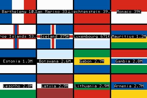

All satisfactory. I said:
Now the "Prime Directive", which I may include with any program specification until I am sure you are following it in every case: Prime Directive: Before presenting any code, scan through it and avoid syntax errors by confirming that any variables used have been declared and that commands or functions used are in the commands or functions text files provided earlier, or are supplied by you, and that syntax conforms to the "help" file provided earlier; also assure that any program presented is appropriate to the specification given for it, or for a subsequent request.
Then today's specification:
An exercise in continuity. Specification: using the uploaded program (Version 17 of the 4x4 flags program, which displays the flags the first 16 countries in the list at  https://en.wikipedia.org/wiki/List_of_countries_and_dependencies_by_population which can be drawn with the box command (having no angled or curved lines)), pick the 16 least populous countries on that list which fit that criterion and produce an MMBasic program to draw their flags in 4x4 format with accurate colors. Only the countries, the flags, the colors, and the text should need to be changed. Follow the Prime Directive.
Here's the result of the program it produced the first time (One&Done!):
No muss and no fuss. 194 lines of unaltered MMBasic code.

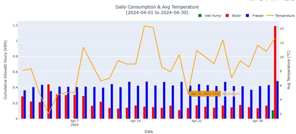

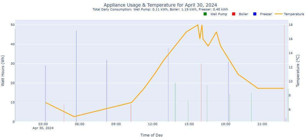

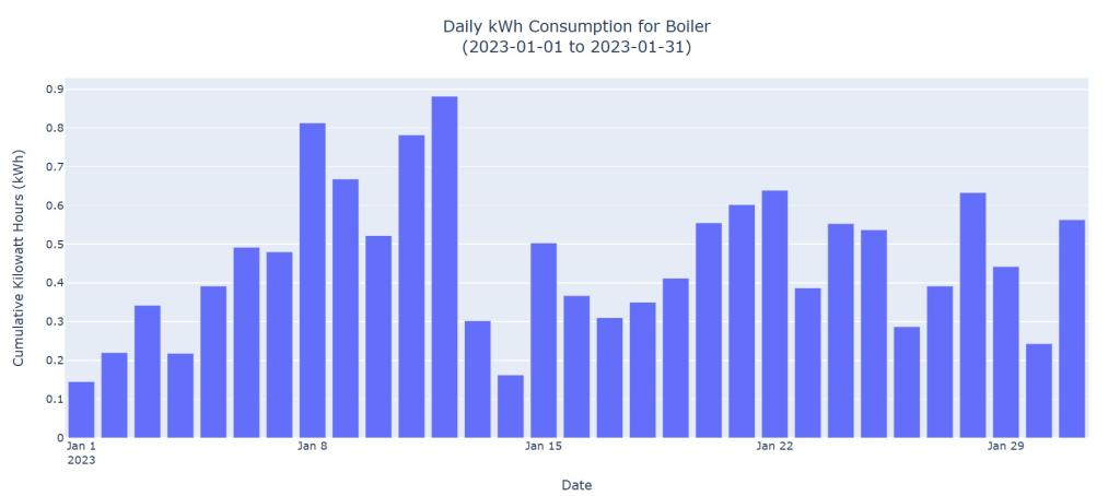

A different path. I have log files which record various sensor readings--mostly temperatures but also current usage for my boiler, freezer, and wellpump. A data record looks like this:
J 3 4 -1 240101071140.
A single first capital letter indicates the sensor/recordtype. In this case, "J" means readings from my barn. The 2nd word is temperature in °C in the barn at floor level, the 3rd is at waist level, and the 4th is outside. The 5th word is a timestamp in the format of "YYMMDDhhmmss". For the boiler, the letter key is "L" and a record looks like this: L 0 25 0.317 241026084155. The second word indicates appliance turned on or off ("1" or "0"); the third is number of milliwatt hours used since turned on, and the 4th is cumulative kilowatt hours for the day. The 5th is always timestamp.
I gave Gemini this prompt: Please produce a python program which will read an input file, "signals23.txt", and produce an html vertical bar chart file of watts consumed per day for one of three appliances. "L" as the first word of an input line stands for "Boiler", "T" stands for "Freezer", and "K" stands for "Well Pump". each record had 5 words separated by a space. A second word of "1" means the appliance turned on. A second word of "0" means it turned off. With a 2nd word of "0", the 3rd word will be the number watt hours used. The 4th word will be the cumulative kilowatt hours for the day, and the 5th word will be a timestamp in the form "YYMMDDhhmmss". When the program is run, query the user for the appliance ("L","T","K") and the starting and ending time periods in "YYMMDD" format. If the ending time period is blank, the period plotted with be the single day and each cycle end time will be plotted. If the ending time period is subsequent to the starting (e.g., a multi-day period), each point in the plot will be the 4th word of the final cycle end time for each day. Provide appropriate horizontal and vertical labels. The records will be like this
L 0 2 0.311 220114100313.
The first pass failed with "utf-8' codec" error. The second pass ignored records with those and produced a plot which included a negative value. I told it to ignore any negative readings of milliwatt hours. The next pass ran successfully and produced this chart of boiler usage for the month of January, 2023:

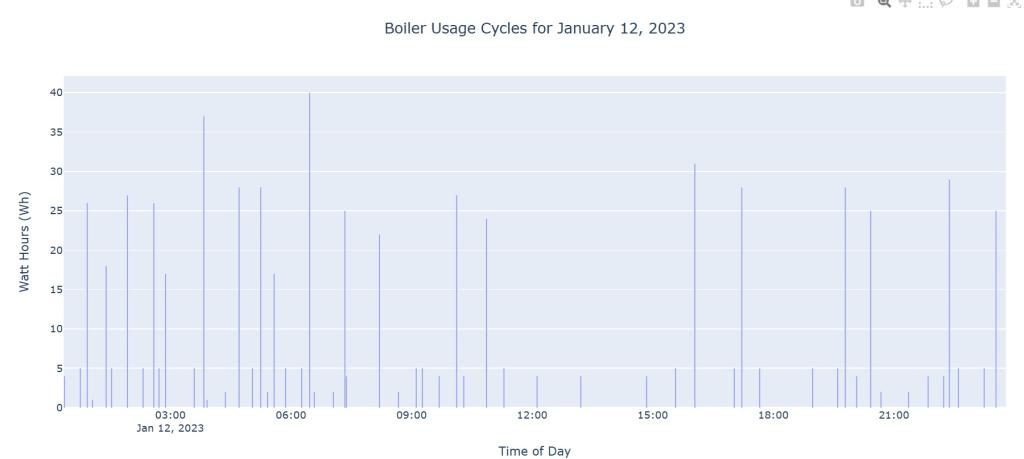

And then this for the day with most electricity used, Jan 12, 2023:

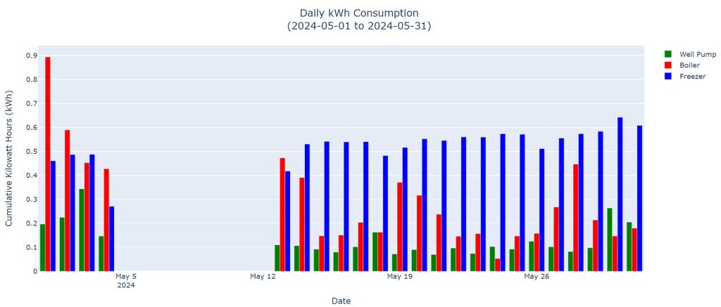

Some cycles of refinement later with only two errors (variable typo and misunderstanding of actual record type codes when I asked it to allow user input of B, F, W for Boiler, Freezer, Wellpump), I got this:
(Unfortunately my data accumulator had failed for May 5 - May 12.)
This was very easy development--few errors, all but two understandable, and a steady progression as I refined and expanded what I wanted the program to do. This particular kind of coding by AI seems essentially complete.
202 lines of python code (which I haven't even looked at).

I went further and asked it to chart a second y axis for daily or multi-day charts, providing the average of recorded temperatures for the day. The temperatures are in records keyed with "Y" in the first character position, and also asked it to accept an alternate input file if included on the command line (e.g., sudo python appliances.py signals24.txt). It did this.
(This chart may look somewhat peculiar, since the boiler usage on the last day of the month is many times what it was on the other days, and the wellpump didn't come on until that day--but this is correct, since we were away for the month, arrived on the 30th, and turned up the heat and used water.)
For a daily chart with temperatures I asked it to provide a second title line giving the total kilowatt hours for the boiler, freezer, and wellpump.
This shows that the well pump came on at about 1:30pm and the boiler thermostat was turned up at around 4pm. FYI .48kWh for the freezer costs about 8 cents Canadian, 6 cents U.S.
