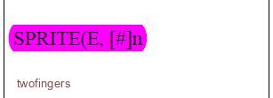

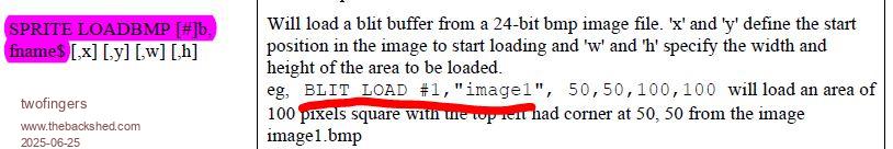

Since this was already overlooked in the last update:
  Quote  p. 149 (Typo)
PLAY LOAD SOUND array%()
You can use the MEMORY PACK command to
create the arrays from a normal 40956 element integer array.
should be: 4096!
An example would be helpful, as it's not clear whether all elements must be filled. It's also unclear how to use a second array or how to overwrite or delete the sound data (not the array!).
and I couldn't get it (PLAY LOAD SOUND) to work with MEMORY PACK, I found some more typos in the description of the sprite commands:
p. 159 (Blit load?)
p. 183 (missing closing bracket)
p. 184 (Duplicate section)
(so1 = s1)
Kind regards
Michael
