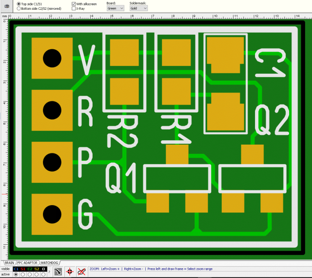

Hi Grogster,
There is sufficient board area to rotate C1 by 90 degrees and use a larger footprint.
It may be easier to get a 1206 10uF ceramic cap. But in case you need longer times (22uF) it is definitely advised to increase the footprint size.

2x 10uF with a solder blob to parallel them.  :)

@ Mick: The solder-pads are on a standard 2.54mm grid, so I could EASILY just add some holes on the pad-centers, then you could have either-or.
Other changes noted, will do.

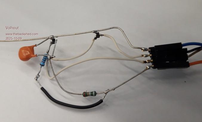

@ Volhout: Can I assume you have actually built this circuit?  It looks electronically sound, but it would be nice to know it has been tested, before I get boards made.
@ Mick & Volhout & everyone else: I will make the C1 footprint 0805/1206, so you can choose whatever works for you.

Hi Grogster,
Yes, I have this running. I was afraid of side effects (the rightmost mosfet is used as an analog comparator with limited gain, so the RUN pin would experience a slow ramp (not a sharp edge). I needed to make sure the pico would behave nicely (reset reliable) on this slow ramp. So I tested it for several hours before publishing the schematics. Used BSS123 for the 2N7002's since these where available. The SOT23's look so tiny compared to the .25W through hole resistors and the tantalum capacitor.

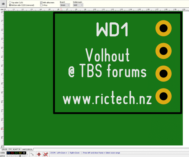

@ Volhout: Excellent, thanks.  I was pretty sure you would have tested it before publishing the circuit, but some circuits are posted as "In theory, this should work" kind of thing, so I just wanted to be sure.
I will get some PCB's made with my next order, and if anyone is interested in these, respond here, and I will start a new thread, with reference to this thread, with the Gerbers etc, so people can get their own ones made if they want.  In the public release, I will remove my www reference on the bottom silkscreen.
