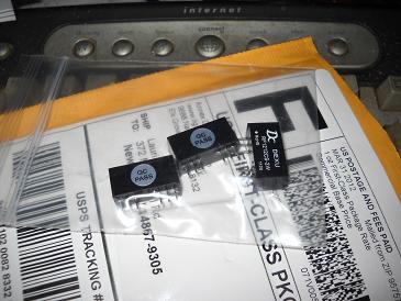

  Warpspeed said   Don has come up with a very good solution.
I would suggest you keep the IR2117, as it simplifies things a great deal, and you already have it.
Get rid of the diode that would normally charge up the bootstrap capacitor, and connect the output of Don's small isolated dc power supply directly across the bootstrap capacitor to keep it charged to a constant +12 volts.
That will give you the best of both worlds, with a minimum of extra components and circuitry.
The IR2117 will then work down to zero frequency, and the buck converter will start up and run happily into either a battery, or ground a referenced load without any problems at all.
Do an e-bay search for "isolated power module" There are quite a few suitable parts advertised for around five to ten dollars.
Typically 9-18v dc input, 12v dc output, one watt.
Greetings, isolated power supply modules have arrived. Hopefully this will prevent the 555 timer from shutting down when a 12 volt battery is used as a load. I did some informal experimenting and noticed that very small changes of the duty cycle control signal had dramatic affects on the required torque for the PMA under manual operation.

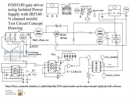

Greetings, using a isolated power supply and FOD3180 does work. I am using a blocking diode between the inductor output and the plus terminal of the 12 volt battery. The gate driver is triggering a N channel IRF540 in a Buck circuit configuration and is charging the battery, current about 1 amp. Then I replaced the battery with the 50 watt halogen light and the circuit was able to illuminate the light after I adjusted the duty cycle, current max about 4 amps. I was manually operating the PMA. So far this is a very happy day. The next step is to drive the PMA with the drill press to determine how the circuit behaves at a higher RPM.
Chapter 4. page 69
http://etd.ohiolink.edu/view.cgi?acc_num=akron1320692738
Isolated power supply with FOD3180 gate driver. N channel Buck converter using a IRF540 mosfet. Bottom wave form is gate of mosfet, top wave form is source of mosfet.
Input voltage max about 40 volts. Output current varies depending on duty cycle. Circuit still needs improvement but it is working. Input voltage is from a permanent magnet alternator and is being manually operated. Comments welcome.
Gate and Source Waveform Edited by govertical 2012-04-09
just because your a GURU or forum administer does not mean your always correct :)
Posted: 01:46am 08 Apr 2012
Now that you have a constant dc supply voltage to the isolated gate driver, you can ditch the battery blocking diode.
Next thing will be to either increase the operating frequency well above the 5Khz you are getting out of the 555, or fit a much higher inductance choke to the buck regulator.
With such a low switching frequency, and very small air cored choke, all you are really doing is shorting the PMA directly across the battery for brief periods of time while the MOSFET turns on.
It will not be operating as a true buck regulator.
There will be some very high peak currents through the MOSFET the way it is operating now, which is neither safe (for the MOSFET) or efficient for higher power operation.

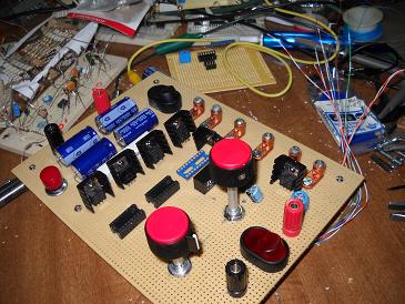

Hi, working on perf_board ciruit layout. Configured 50 volts caps at input to form a 1000uf at 100 volts. Not sure how well it will work. Rotary switch varies duty cycle from 10% to 50%, using 5 k potentiometer so each fixed percent value has small variable adjustment. Results of earlier testing revealed if there was a voltage stored at Vin the mosfet would not turn on. I added a reset discharge switch to address the problem. I am using 4 IRF510’s in parallel just for the experience. I am trying for 15 amps max output. Added 7812 for Vcc to IC's and isolated power supply source. I am including test points to try to verify Buck converter operation. Hopefully testing in a few days.

Hi, I completed fabrication of analog MPPT test circuit. Video shows verification of selectable duty cycle with fine adjustment of each for each selected duty cycle, 10% to 50%. Next step is to test with PMA and battery test load. I am hoping I did not damage the mosfets when I solder them in the circuit.
FOD3180 output for analog MPPT test circuit
Posted: 04:46am 01 May 2012
That looks excellent !!

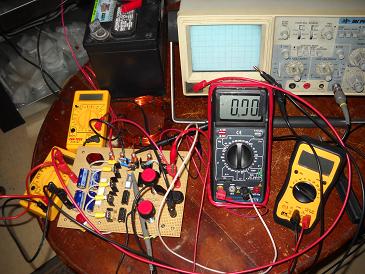

Hi, just a quick video showing test setup. With the PMA at 200 RPM the input voltage was 170 volts, 1.5 amps input current, 12.34 output voltage, and 0.3 output current. Mosfets measured 82 degrees Fahrenheit. The circuit needs major improvements. The input capacitor is only rated for 100 volts and I have to check my inductor calculation. So there are major loses and the buck circuit is not working as it should but the test fixture is working. I am using a 12 volt deep cell for a test load. It does show the control circuit is working and the mosfets are turning on and off. It is a start. Comments welcome.
Test fixture
Posted: 03:48am 03 May 2012
The problem most likely is that the buck inductor has far too little inductance.
Another possibility is the input reservoir capacitor is too small.
What I suggest you try is placing a current measurement shunt in the negative side of the battery to look at the battery charging current.
It should be a sawtooth ripple current waveform sitting on top of a continuous dc charging current.
The amplitude of the sawtooth ripple is directly proportional to the inductance of the choke.
An infinite inductance would give a perfectly constant dc charging current, but that is not going to happen.
Zero, or too little inductance will produce massive current pulses through the MOSFET, falling to zero current during the "off" periods.
Maximum peak to peak ripple amplitude will always occur at 50% duty cycle.
