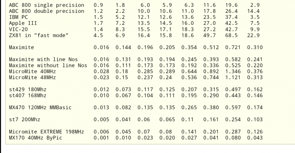

Perhaps time for an update.
                 BM1     BM2    BM3      BM4     BM5     BM6     BM7     BM8
ABC 800 single   0.9     1.8    6.0      5.9     6.3    11.6    19.6     2.9
ABC 800 double   1.2     2.2    10.0    10.6    11.0    17.8    26.4    14.4
IBM PC           1.5     5.2    12.1    12.6    13.6    23.5    37.4     3.5
Apple III        1.7     7.2    13.5    14.5    16.0    27.0    42.5     7.5
VIC-20           1.4     8.3    15.5    17.1    18.3    27.2    42.7     9.9
ZX81 "fastmode"  4.5     6.9    16.4    15.8    18.6    49.7    68.5    22.9
Maximite         0.016   0.144   0.196   0.205   0.354   0.512   0.721   0.310
Maximite w. #s   0.016   0.131   0.193   0.194   0.245   0.393   0.582   0.241
Maximite w/o #s  0.016   0.111   0.173   0.173   0.192   0.336   0.525   0.220
MicroMite 40MHz  0.028   0.18    0.285   0.289   0.644   0.892   1.346   0.376
MicroMite 48MHz  0.023   0.15    0.237   0.24    0.536   0.744   1.121   0.313
MM+ MX470 120MHz 0.013   0.082   0.135   0.135   0.265   0.380   0.597   0.174
MMX 198MHz       0.006   0.045   0.07    0.08    0.141   0.201   0.287   0.126
Picromite ZeroW  0.014   0.058   0.093   0.102   0.184   0.298   0.354   0.127
Armmite H7       0.003   0.023   0.038   0.042   0.067   0.098   0.146   0.065
ArmMite F4       0.011   0.079   0.14    0.149   0.249   0.354   0.528   0.257
MMBASIC DOS      0.0002  0.0017  0.0028  0.0028  0.0073  0.0092  0.0117  0.0058
CMM2             0.00176 0.0118  0.01903 0.01728 0.03611 0.05062 0.07582 0.02851
PicoMite         0.0166  0.1096  0.1800  0.1840  0.3325  0.4715  0.6688  0.3193
Linux            0.0000  0.0020  0.0040  0.0040  0.0080  0.0130  0.0190  0.0070
C-Language
Arduino UNO      0.010   0.010   0.058   0.043   0.043   0.043   0.045   0.284
Arduino DUE      0.003   0.003   0.006   0.007   0.007   0.007   0.106   0.014
ESP32S           0.00007 0.00007 0.00030 0.00011 0.00016 0.00016 0.00016 0.02413
CMM2 has gained many speedups since first introduced. Numbers here from today (400mHz).
Linux version is an unreleased work in progress.
Speeds for Linux, DOS, and Picromite (no longer supported) obviously depend on the hardware.
As Geoff implies early in this thread, it's an astonishing ride we early "home computer" enthusiasts have been on for the last 40+ years. And quite a ride for MMBasic, too.
Edited 2021-09-05 10:25 by lizby
80's computers
MMBasic
Other Recent Basics
ByPic MX170 40M  0.001   0.010   0.023   0.020   0.027   0.041   0.080   0.043
BBC_V Pi Zero    0.0001  0.0007  0.0016  0.0014  0.0015  0.0030  0.0030  0.0036
C-Language
And...too bad... the SD card image for RISCOS PICO (BBC basic without the graphics RiscOS desktop) is taken offline, and is no longer supported, similar to ByPic and PicroMite. The full suite RiscOS is still actively maintained.
Edited 2021-09-08 17:09 by Volhout
