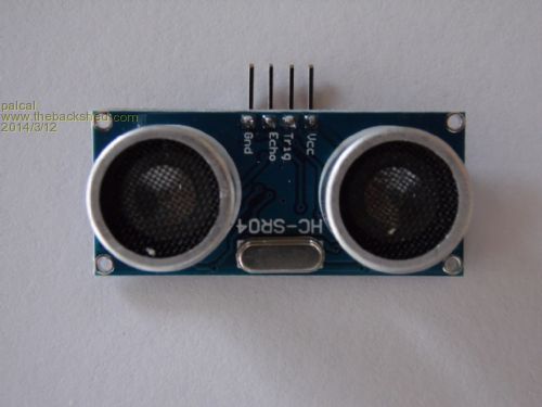

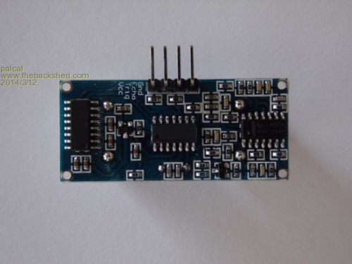

Here is a picture of my module.
Paul.

My HC-SR04 module (4 pins) looks similar to your photos until you study the component layout. I will try take photos of my module and post them so you can see how much the Modules do actually vary.
Bear with me cos my kids keep waking up tonight for some reason so may be a delay posting . . .

Posts: 2994
Posted: 02:51pm 15 Mar 2014
I will post photo of module (front and back) tomorrow once my camera has charged overnight.
