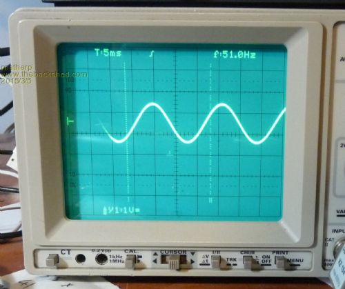

Posted: 09:15am 05 Mar 2015
The main downside is that the usable chip is 100-pin - there is nothing equivalent to the 28-pin MX170.
The big upside is that the quality of the available libraries seem to be excellent.
With the combination of Geoff's superb architecture and the libraries available from Tilen Majerle it has proved really easy to do the port.
As an example, since my last post 1hr20mins ago, I have fully implemented from scratch a new Basic callable command to output a voltage using the two 12-bit DACs on the STM32F4
Syntax is:
DAC number,voltage ' number can be 1 or 2, voltage is a float between 0 and 3.3v
DAC number,STOP ' turn off the DAC
This is built, tested, completely integrated into Basic and includes full error handling
Here is a little test loop I'm running
Dim float x=0,v
x=x+0.05
v=Sin(x)+1.6
DAC 2,v
if x>2*pi then x=0
loop

Posted: 09:40am 05 Mar 2015
I've just done some testing to see how fast this thing actually is.
I changed the step size in the above program to pi/100 so I get 200 times round the loop to output a single sine wave.
Doing this my sine wave frequency is 33.2Hz so each time round the loop is taking:
1 sec / 33.2 / 200 = 0.00015 seconds during which time I'm doing:
2 x floating point additions
1 x sin() calculation
1 x DAC output
1 x floating point multiply
1 x floating point compare
1 x loop
+ all the overhead of the Basic interpreter
NOT BAD!!!!!!

Posted: 11:04am 05 Mar 2015
Now is that a scope OR is it yet another MicroMite powered TFT (CRT?) CFunction you have developed?
Seriously, this is all good stuff Peter. I will PM you shortly to discuss further; I am now sooooo keen to be a tester of this ever evolving beast.
