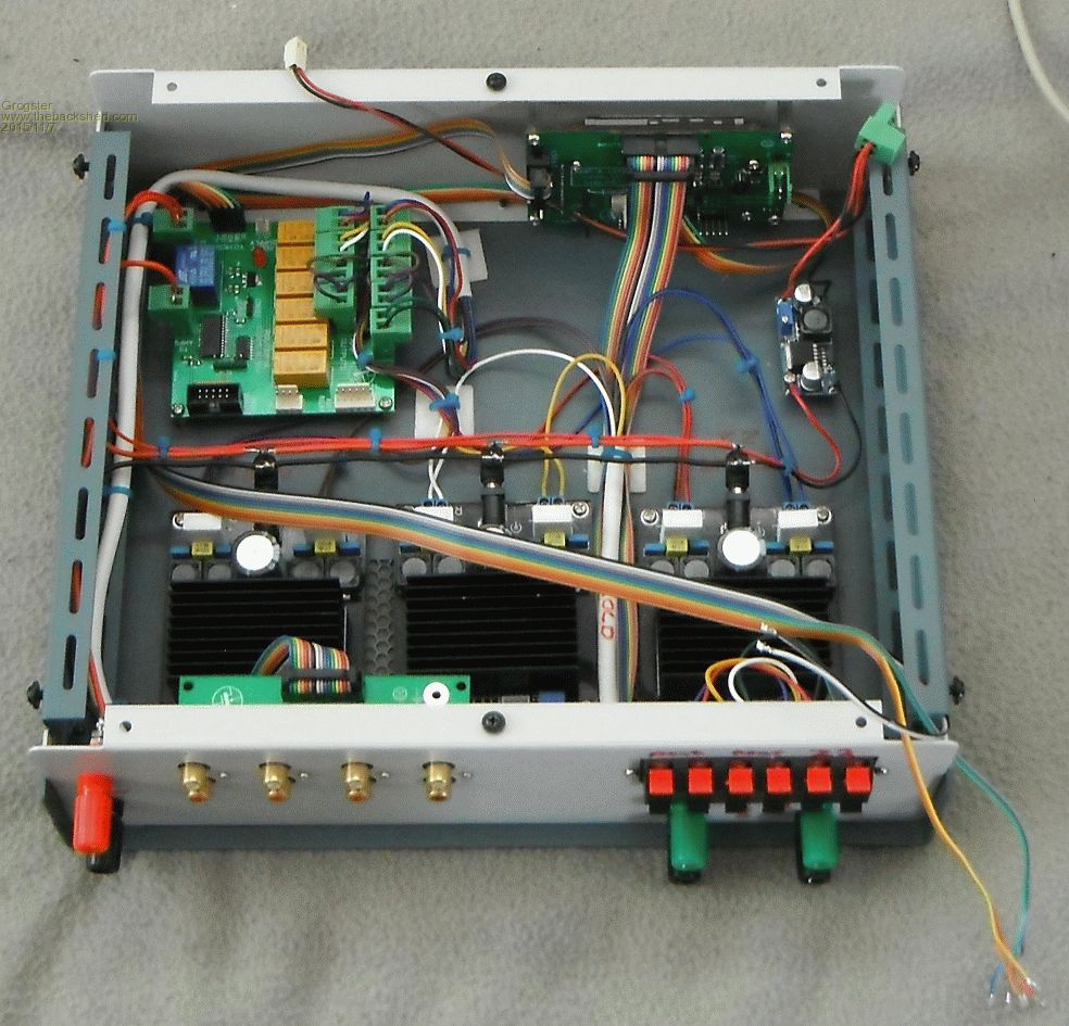

I must admit, that is a neatly wired project there Grogs!
Hopefully you will get some sound out of it soon - you must then do a video of it operating!
Keep up the great work
WW
Posts: 10070
Posted: 04:06pm 31 Oct 2015
Yes, I will do a video once it is working. I am still waiting for my buck converters to arrive for the 12v supply to the MM electronics, but if I get desperate, I can use an external regulator fed from the 32v input. It would just be preferable to have the buck converter mounted in the case with everything else, to keep it all tidy.
Perhaps cable-tying all the wires up is premature - it is not working yet!

UPDATE
Just a quick wee update. The Buck converters and XH-3P plug sets to suit the amp inputs arrived the other day, so I was able to fit the regulator, and prepare the amp inputs:
The inputs have the pins connected, but I have not fitted them to the shells yet.
The buck converter has not yet been adjusted for 12v output, so it's output plugs are also just dangling at the moment.
This weekend, I hope to get enough time to be able to do some preliminary tests. I have the 32v eleven-amp PSU all cased up, so that is ready and waiting. I tend to stretch things out a little more then maybe most others would, as I like things to be correct(or as correct as they can be, anyway) BEFORE initial power-up, to at least minimize initial power-up problems.
UPDATE
Initial power up complete - no smoke.
Buck reg set. At power-up, it was giving 16v output, which is right on the threshold of the on-board regulators, but the relays probably would have handled it OK for a time. Naturally, adjusted for 12v output now.
All system voltages correct, so the next step is to power up the amps with speakers disconnected, and test voltages on the amp supply rail, and making sure there is no significant voltage on any of the speaker outputs.
All that done, I will then connect some speakers to the amps, and begin some actual sound testing.
UPDATE
32v on all amps, 0.05v on each amp output at rest. This all seems perfectly normal and well within what I would expect, so time for some speakers. Edited by Grogster 2015-11-08
