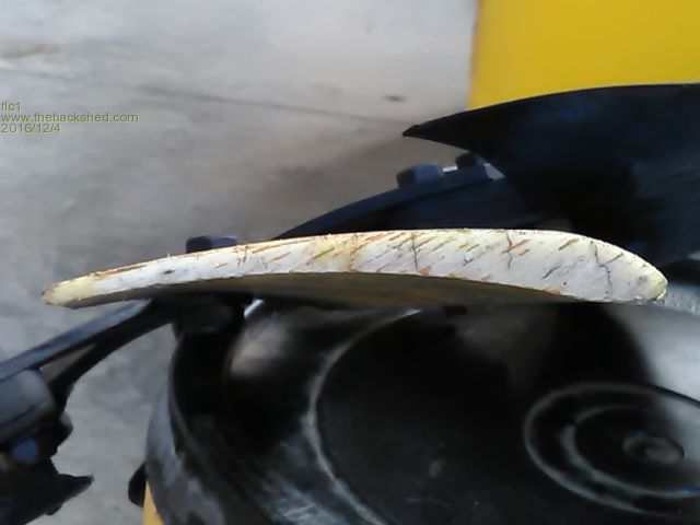

Gday Dave, yea I have a plan to make some changes when its time to overhaul the running gear on turbine, I think I can get away with having both 36pole stators on the geared up shaft ,with a gearing of approx 1.6 or 1.7 to suit the inverters that Im useing,with no stator on the direct drive shaft, both stators will be electricly cut into 3\3 and one stator wired as star and the other as delta.I reckon I should get around 1.5 kw maybe even closer to 2kw, I will have to buy a larger inverter though, probably a 2 kw model, to be safe. With it having 8 blades it has reasonble low wind performance,but the 8 blades give high drag at high rpm,so its almost like a rpm governer,it went through one storm with no load on the turbine at all one night, I was unaware that the inverter had been fried, so it was peak rpm all night ha! No damage the next day,suprisingly. Blade hub came loose recently,put a new nylock nut on and a couple of small welds,just to make sure.Il have to change the mounting design of the shafts ,to take 2 stators on one shaft, but then I can make a better housing for the stators, because the present one is a bit of a pain to open n close. Edited by flc1 2016-11-28
flc1
Joined: 20/11/2011
Posts: 242
Posted: 02:25pm 03 Dec 2016
aerofoil shape of blades on my turbine

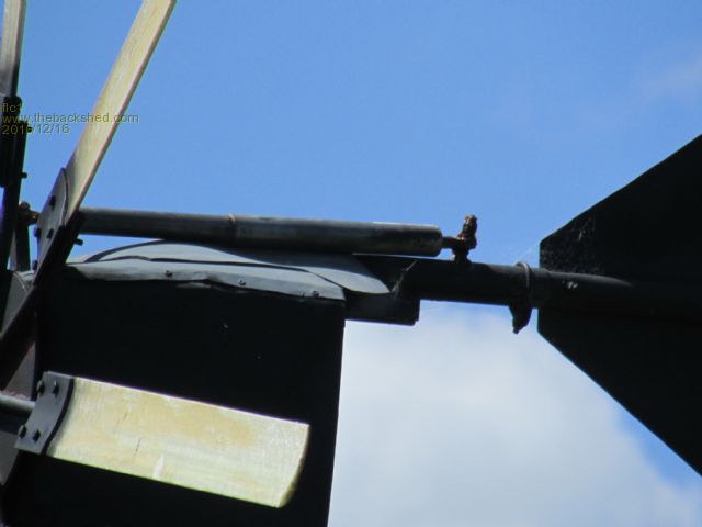

Posted: 12:05pm 16 Dec 2016
photo showing one way dampner fitted along top of the tail ,to stop tail hitting back too hard on seat during storms, my first turbine did not have dampner and nearly snapped off top of pole during a storm.
