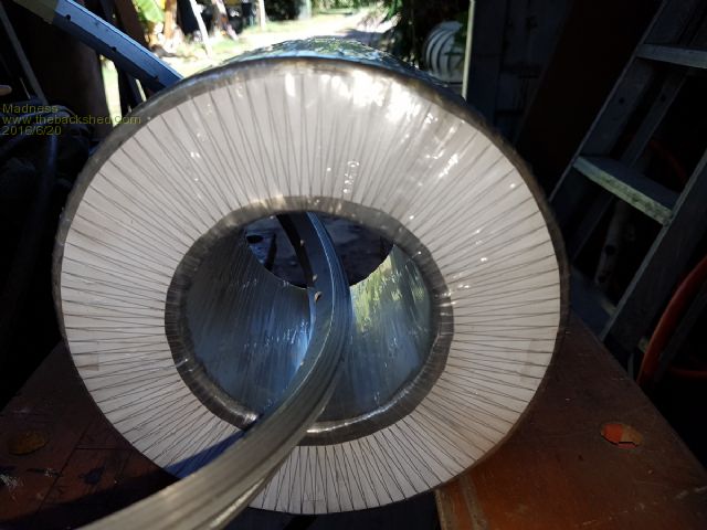

Well I have the first 2 layers of Mylar on and have included my paper guide. Went much quicker than I expected using Frackers bike rim method.

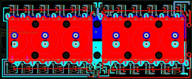

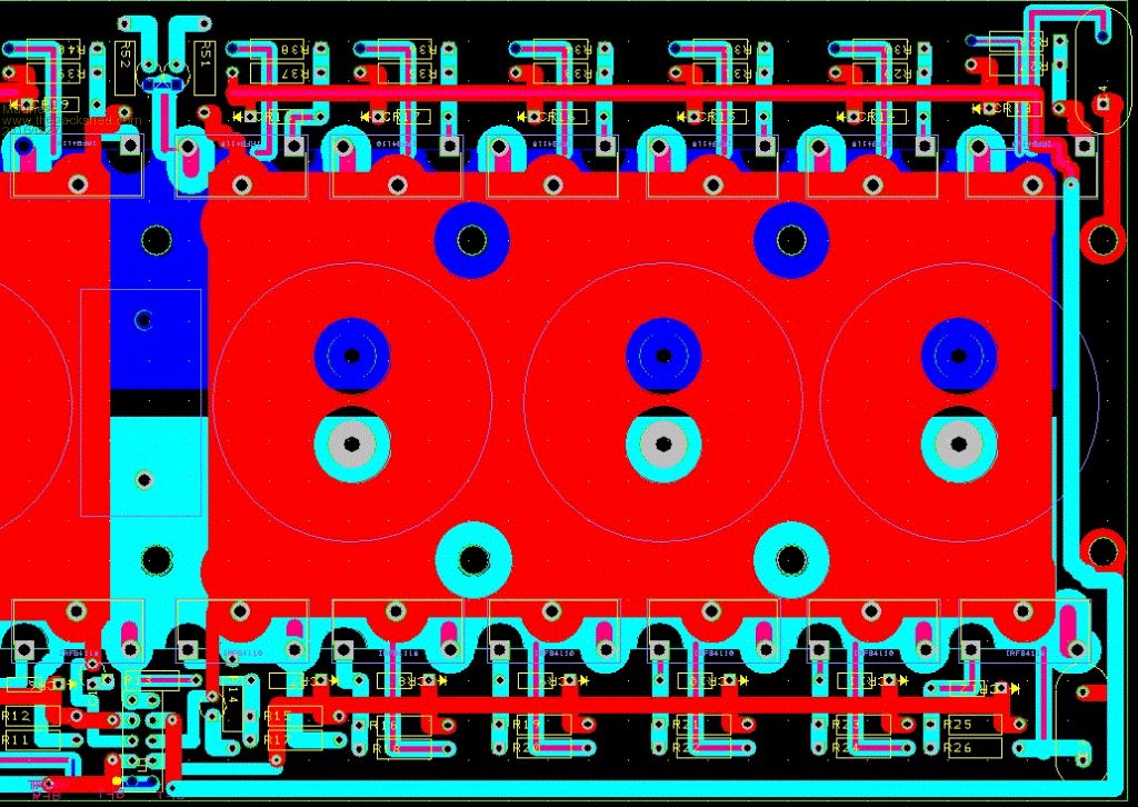

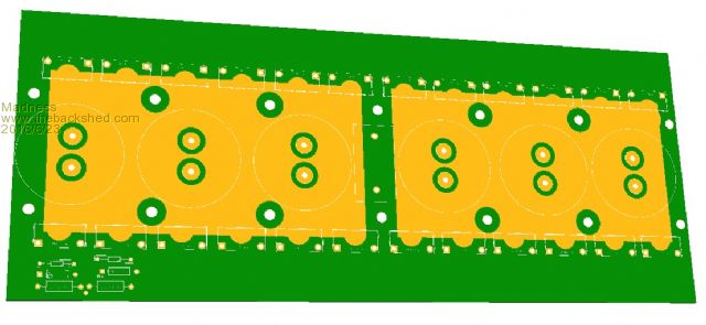

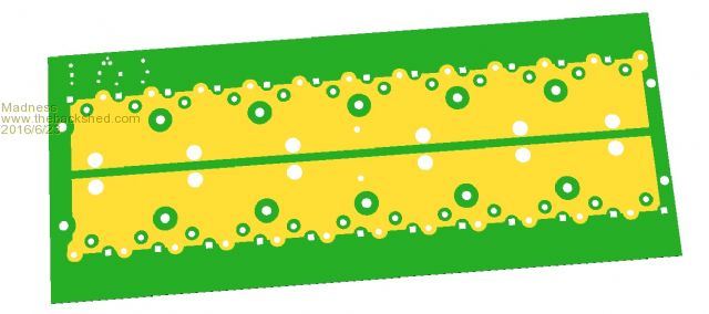

Also been working on the modified power board, been pulling out some hair but starting to make head way. Board is 250 * 150 mm I reduced the length as I have 2 oz FR4 on hand that is 250 mm long.

Looks the goods, but I would reduce the number of holes you have there for the clamp screws to 3 per 6 fets, and make a relief around the holes so you don't need fiber washers like I had to do. You should just screw the screws in with no other hardware needed.
I would consider putting the solder pads on both sides of the bridge, so thinner wire and more of them is a possibility, and copper thickness will not be much of a problem anymore.

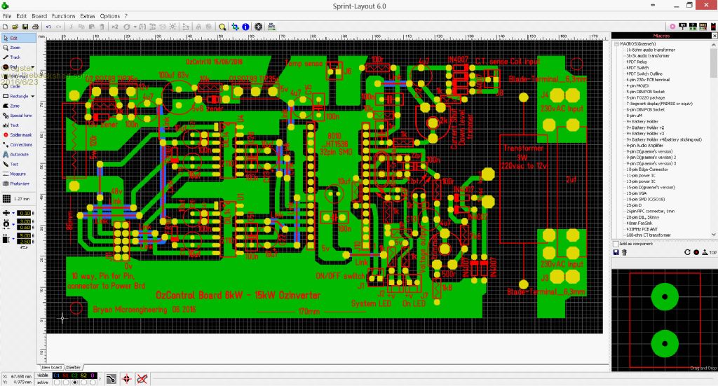

I was able to import them into Sprint Layout. I am not sure what you mean by my undoing the PCB files......
EDIT: Here is the import:
I don't have any Excellon drill data file, so the holes are not defined, but I can alter that myself.Edited by Grogster 2016-06-24

Are you able to export as Eagle? would be very helpful, there is a later version 80109f of the PCB.
Posts: 10094
Posted: 12:42am 23 Jun 2016
Sprint Layout can only export to Gerber or Isolation Milling files(HPGL, *plt).
Not sure if that is of any help?

My Original files are TARGET PCB software, small commercial purchase licence Febuary this year.
Any way, here is a zipped folder for the double sided OzControl Board 10, These are all RS-274-X Gerber files, except the drill hole.
This folder is ready for the PCB manufacturer, and in there requested Format, I think. http://www.shenzhen2u.com/PCB
Grogster, there is a Link 5v to 5v that is not blue on your import double sided board, if not a double sided board just single then add links on the top.
2016-06-23_105636_OzCntrl10_2.zip
These Gerber files can be viewed with the Free 'GC-prevue' Gerber file viewer, just import each Gerber file, and it even shows the Drill hole file.
Trust this helps Gary. ? Edited by Clockmanfr 2016-06-24

Your Gerber set and drill data imports fine - holes and all.

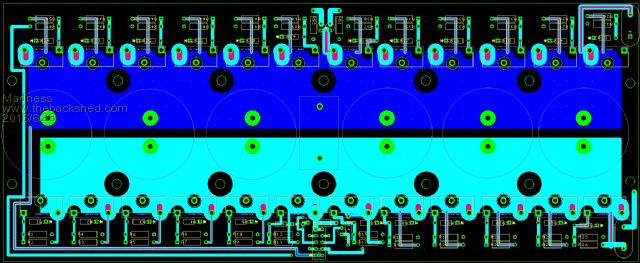

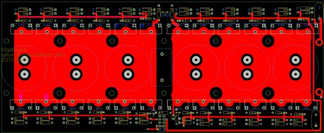

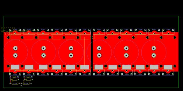

Posted: 04:03am 26 Jun 2016

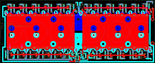

Making progress with the PCB, need to check for errors. I will do that when I am not so sleepy, but I pretty sure it is right.

Posted: 05:41pm 26 Jun 2016
Not enough definition to say if correct or not, but wow the gap between the screws and the fet bodies is pretty skinny.... if I am reading it right.
Did you leave room on the solder mask ( if commercially done) for the wires to be soldered onto the board for the 4 termination wiring areas. ( 24 points?)
I used 4mmsq solar wire stripped to the inner sheath and figured 6 wires for each should do it... they are only short.
......oztules

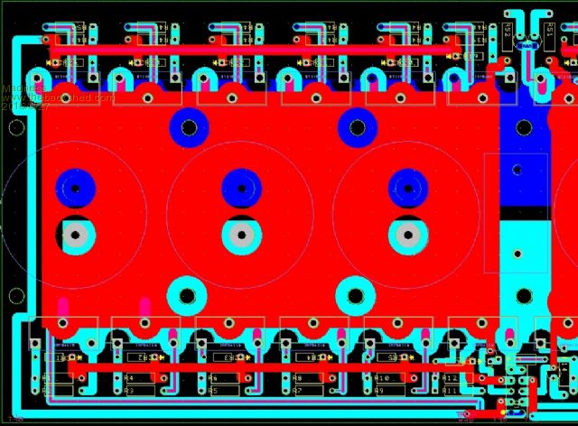

Posted: 09:08pm 26 Jun 2016
Hi Oztules,

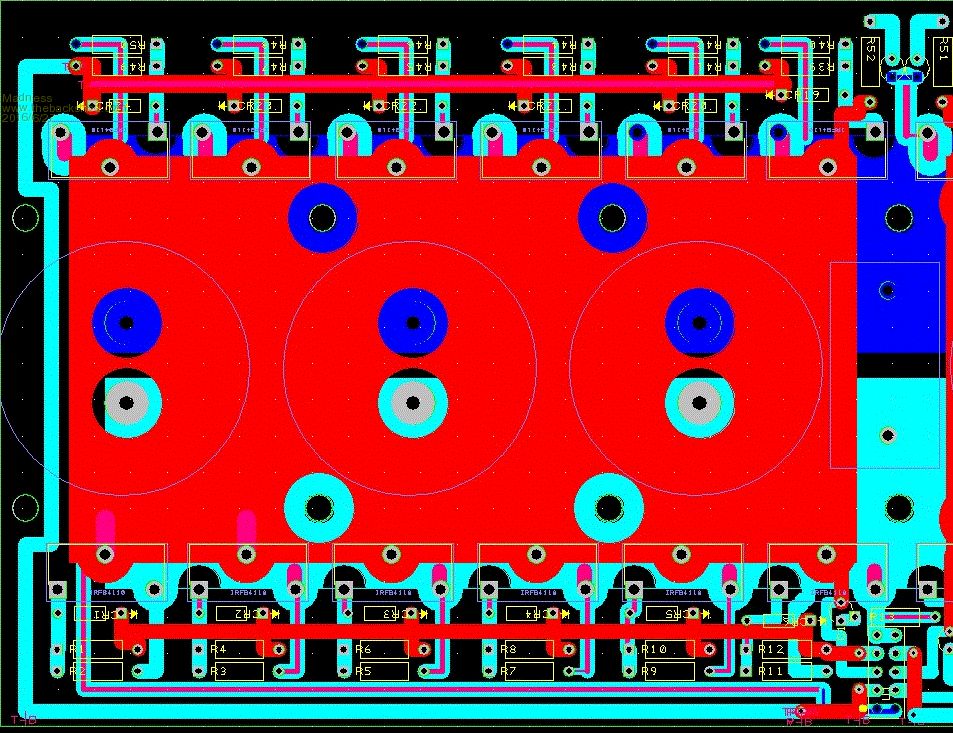

There is 40mm from centre to centre and a T220 is 10mm wide so should be room to spare, I am planning to use 3mm screws. I have kept the legs well spread as per the design Clockman is using. The area shown on the board is actually 18 mm wide so there is 4 mm spare each side of what you see on there.
After look at it with fresh eye's today I have rerouted some tracks and widened most of them. Biggest change was to get the track away from the screw heads on the right edge.
Here is a higher res version with updates
edit The file has been downsized.
Edited by Madness 2016-06-28

if you turn the wide image 90 degrees and save it as a gif the 4M will let you post a very tall 1024 pixel wide image.

Oz, no plans for commercial production of the boards, I will just make my own. Dots in the back ground are 5 mm apart, will give some idea of scale. I am using design spark if any one is interested.
Yes plenty of room for soldering on wires, I could leave pads etc to look pretty but no need. Won't have any girls in bikini's holding it like the inverters on ebay either unfortunately.
