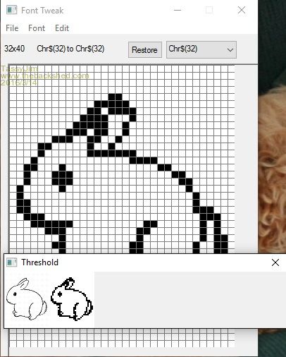

Still plugging away...
From the Edit menu - Character from Image opens a file selector to import a BMP, JPG or PNG image.
The size of the image is not important but its proportions is. If your font is 32 x 50, the image width to height should be in the same ratio. The image opens in a new window with the original one the left and a black and white version on the right.
There are two methods used for converting the image.
Threshold changes each pixel to white if it is brighter than the set value, black otherwise. This mode is best for line art or silhouettes.
Region threshold set the pixel white if it is brighter than the surrounding pixels.
This mode is usually best for true photos but you may need to experiment.
To switch between the two modes, press the space bar.
To adjust the threshold level, use the right and left arrow keys
To adjust the size of the region (only in Region threshold mode), use the up and down arrow keys.
To transfer the image to the current font character, press return or enter.
Once transferred, some touch-up is usually needed.
2016-03-14_045530_FontTweak.zip
The help file has been updated.
Enjoy.
