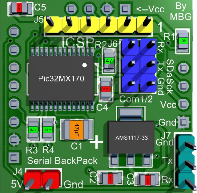

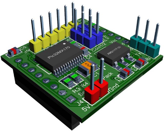

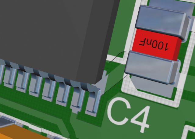

Hi All,
As Mentioned, DEX is improving the 3D visualisation at the moment and I just wanted to show a couple of examples of the effect, hoefully TBS wont resize these images too small.
The latest effect is to add a `weave' to the fibreglass PCB so that it looks a bit more realistic. (that probably wont be able to be seen in the reduced size of the screen shots but I can follow up with a close up if anyone is interested.
Kind Regards,
EDIT****
Yes TBS reduced the size so the weave couldnt be seen.
Here is a close up view.
Mik
Edited by bigmik 2016-05-01

The 3D visualization actually was the thing that convinced me.
I like that a component is not only a footprint and a 3d model.
Here it is actually a parametric model with parametric feet. This gives the most realistic representation with the least amount of data. Very smart.
There is even solder on the pins.
But what really makes a difference is that each component can have a color. In your example the headers and resistors is a great use.
My biggest wish is colored traces, but i can understand that is more a 'false color' 3D but great for documenting a project.
It would save a huge amount of coloring by hand.

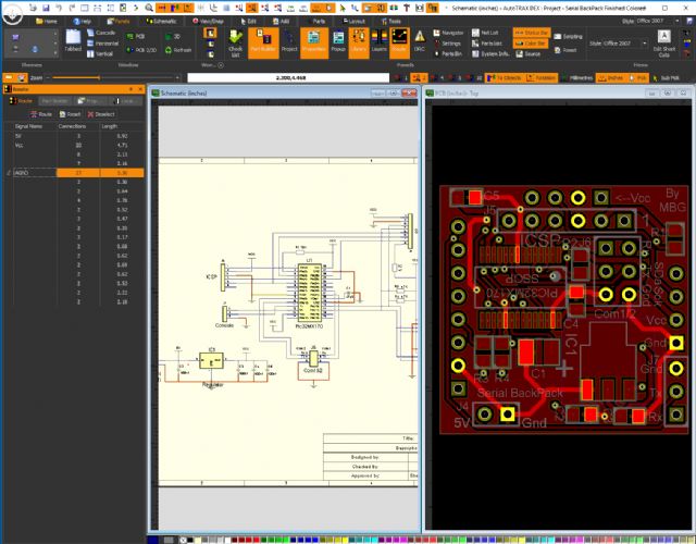

Maybe a brief description of `my' methodology of creating a board is in order.. as I suspect you are trying to force DEX to do things in the method that you are used to with Diptrace.
I start with the schematic, first I load my parts from my library and move them around where I would like them to be positioned.. Then I link the NETs (wires) to get them connected.. After I am happy that the schematic is as I want I then look at the PCB.
In the PCB DEX starts with a default size PCB and all of the component footprints around the outside of the board. I then resize the board to the desired target size I am looking for. I then drag the parts that need to be in set positions (and set which side they should be on) onto the PCB area (The NETs will start looking cluttered at this stage so you can turn these OFF in the View tab in the tool bar). Once the positions are in place I then right click on these components and LOCK them so they cannot be moved without unlocking first.
When the parts that are in set positions are done then bring in the other parts onto the PCB into positions you think they should be.. Then turn on the NETs and look at the Nets-nest and rotate/move if you can see that it might make routing easier. Then I right click on NETs that I want wider (Vcc/Gnn/5V etc) and using the properties panel set the widths. I then select AUTOROUTE and watch ELECTRA do its thing.. when finished you will generally find most if not all tracks are routed, there will be the odd funny bend that you can easilly edit out but generally it does a fairly good job. I then spend a lot of time manually re-routing tracks to try to minimise Vias and moves parallel traces further apart if I can but that is just me you could leave all alone at this stage, especially if you have a larger PCB area and the parts spread out (I try to squash my boards down to make them as small as practical and that does take a fair bit of effort). I use the DESIGN rule checker to check for board errors, this does a fantastic job and finds things you might have overlooked. (Set the rules first -- fairly self explanatory.)
After I am happy with the ROUTING (electra/manual) I then click the check box at the bottom of the Layers panel to PCB FIlled and make the top Silkscreen visible and the current layer and edit the silk screen overlay to your desire. You might wish to rotate/resize Component designators or resize the silkscreens to suit your requirements.
After the DRC passes to your satisfaction and the silkscreen looks good I then place a copper pour on both sides of the PCB, In properties select "resize to board" and tie it to a NET (I use GND) as desired.. Some people use Vcc on the top and GND on the bottom but I dont really like that but it is personal tastes.
Then when the board looks OK I tell DEX (in the tools menu) to GENERATE the gerber files and then generate the drill file.
That is it in a nut shell.. Watching some of the many videos on KOV.COM will fill in the blanks from my babblings..
