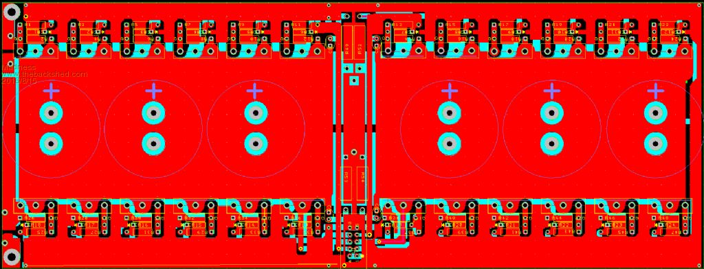

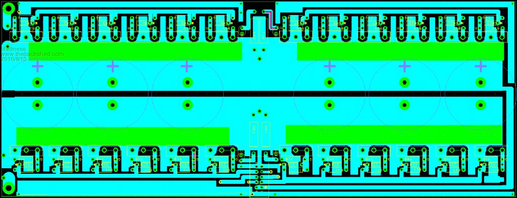

Hey Madness
My build I also will be mounting the fets underside. Fets are TO-247 IRFP4332
I also want to reduce the mainboard down to 100mm wide so I can fit 2 prototypes on a 200mm x 300mm sheet. Any chance you can post your artwork.

Hi Steve,
Yes, no problem, I have yet to verify it is working correctly but I believe it is right. I am using 250 wide PCB so I have made it fit on the size and is 100 mm wide, the image below are from Design Spark, can send you the files if that is any help.

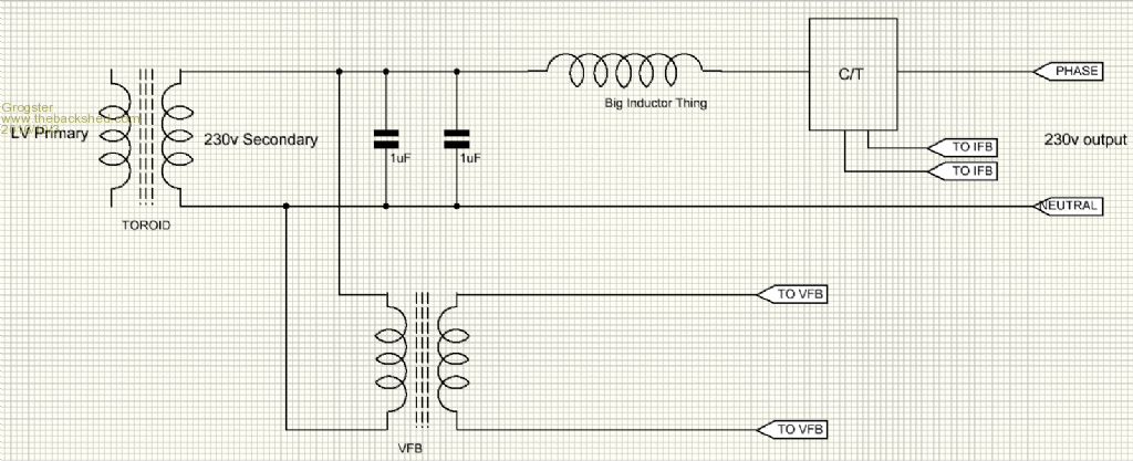

Just to reiterate, where exactly is the 2-4uF cap located in that loop?
Is it secondary - current C/T - VFB transformer - 2.2uF cap - mains filter & voltage/power measurement - output?
or
secondary - 2.2uF cap - current C/T - VFB transformer - another 1uF cap - mains filter & voltage/power measurement - output, as I had planned?
This time I'd prefer do connect it right

The VFB transformer and the 2-5uf shaping cap share the output terminals of the secondary directly... can be some distance away, but they see the secondary warts and all... then anything you want after that.
The sine wave at that point will be near perfect, but at high resolution, will have the staircase of the 20khz impressed in it very finely.... then you can filter that out next.
Then you will see how the filter works, so far it is the low frequency scramble we have seen it screen out,..... how it reacts to 20khz will remain to be seen... hopeful, but uncertain.

Posts: 10096
Posted: 10:50pm 02 Oct 2016
So is this the correct arrangement:
...or this:
Edited by Grogster 2016-10-04
Posted: 11:21pm 02 Oct 2016
Mine is gonna be the second drawing (...or this:) as the VFB transformer, C/T core and shaping caps are all on the same little PCB.
I will connect the "big inductor thing" (mine also has small caps on it) last in the queue, just before the mains connections to my house.
Oztules, I'll keep my fingers crossed for that big inductor filter to attenuate the 20KHz noise too. Thanks for pointing my nose in the right direction for looking at the CRO screen.

Posted: 11:26pm 02 Oct 2016
No 2 looks good.
......oztules

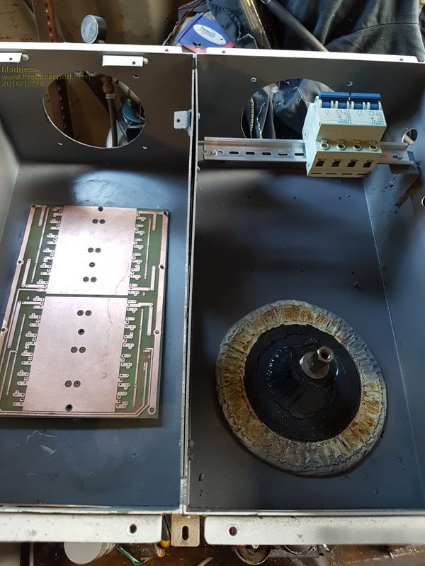

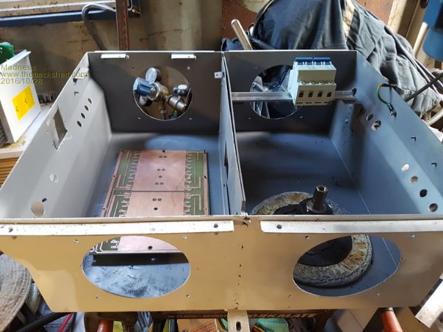

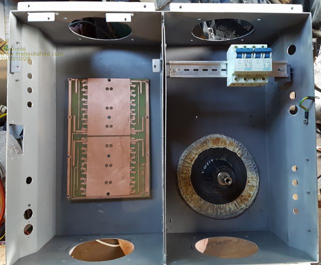

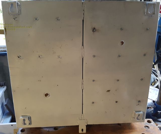

After many trials and tribulations, I am close to getting a working inverter. Somewhere I got the wrong information for the snubbers, they need to be 103 3KV caps and 2W 47-ohm resistors. Also after trying several different circuit board layouts I have now made a design that is very close the original Chinese design. This also uses the heatsinks as conductors for the positive input and AC output. I am yet to test this layout but received an order of MOSFETs I was waiting on today.
Here is how I have made the case, very similar to Oztules with 2 Aero-Sharp cases bolted together, except I have included a twist. That is I have rotated it 90 degrees so the air can flow better with natural convection as well as with the assistance of 4 140mm fans.
Posted: 12:14am 28 Oct 2016
Cutting those big fan holes in 2mm ss would not be my idea of fun , good on yer for giving it a go.
