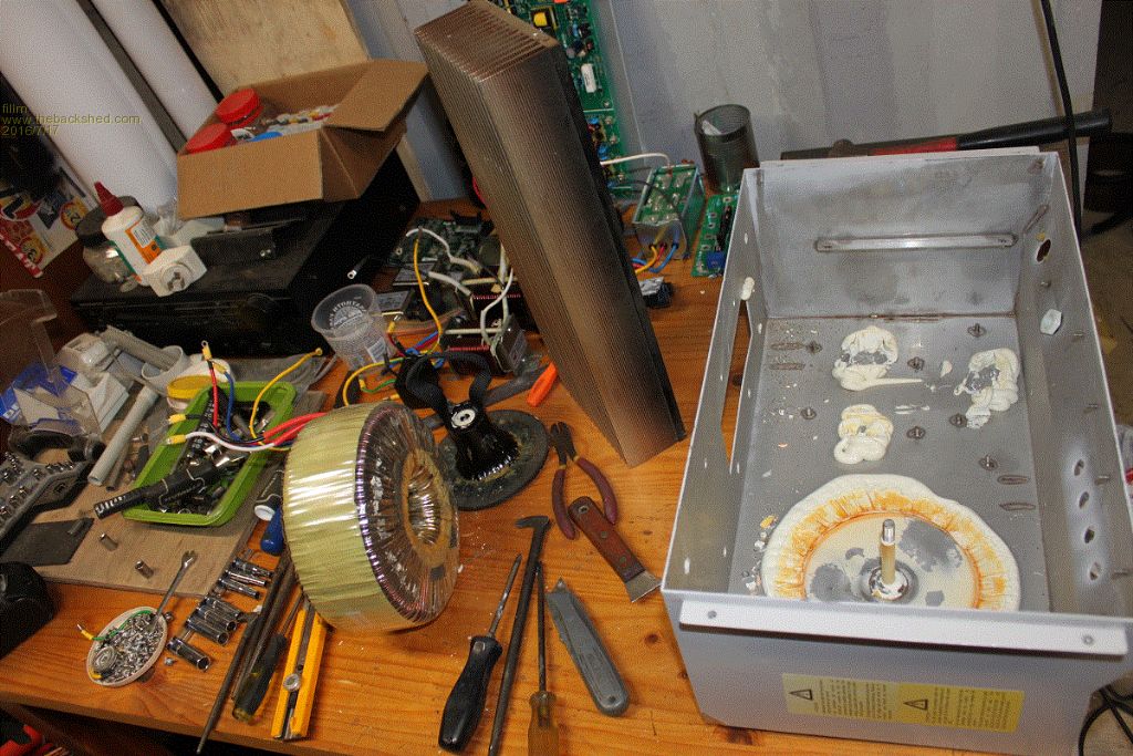

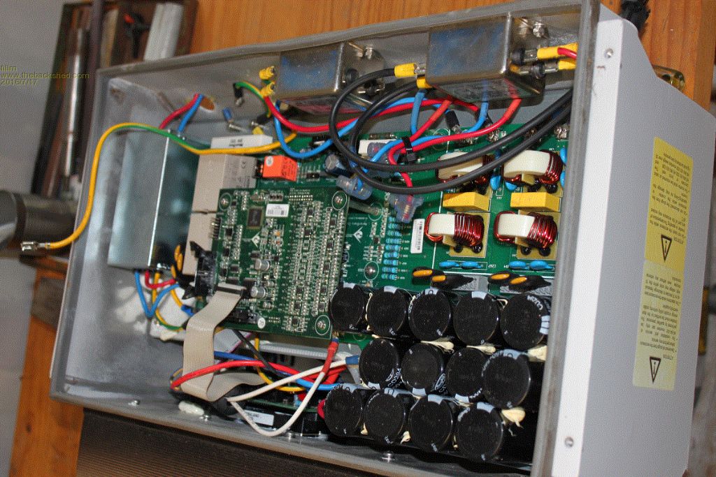

This afternoons effort , I stripped out one of the Aerosharp inverters, they liked to use a bit of glue but if you take your time and I used a bit of heat it all came apart OK . Don't really think the heat did as much as a hammer and a 330mm length of decking hardwood.
I suppose now I have to unwind the toroidial, and have a look back at Mad's toroidal build as I would like to try and get it this up to its Max.
I would also to use that nice heatsink as would seem a waste not to...

I found the easiest way to get the torroid out was to strip everything else above it out, undo the nut on the torriod, tip upside down, lift the torroid end about 250mm and drop it, 2-3 try's and it either separated from the resin or the whole lot came out.
Having stripped out quite a few I am now trying to put a couple back together, if you could take some photo's of what wires connect where to the PC it would be greatly appreciated.
I found a 450 mm long length of 25mm poly pipe with a 50 mm deep v cut in each end worked really well for unwinding the copper. When I finished 1 wire I just put a cable tie around one side then popped the pipe out ready to do the next. Edited by Madness 2016-07-18

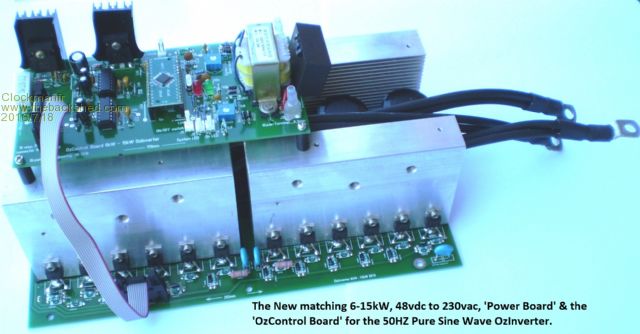

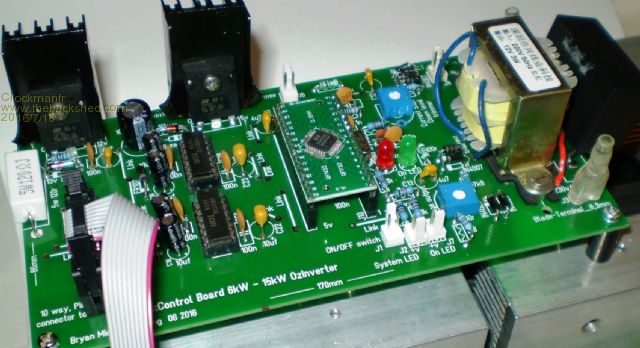

Clockmanfr
Joined: 23/10/2015
Location: France
Posts: 437
Posted: 08:51pm 17 Jul 2016
Hi Fillm,

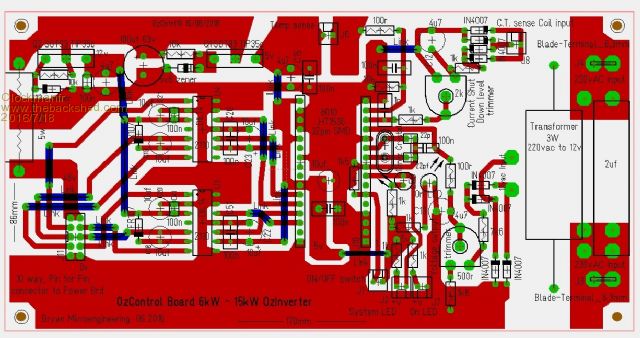

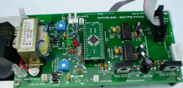

I have just re-printed my PCB Supplement, with some new photos of the OzControl Board with the Pin 6 Start/Stop to now match the PCB's. These pics might help on final assembly.
This now brings all the PCB's up to date.
I do have another OzControl Board 10a that is designed and ready for production, but this is just 6mm longer and redesigned around the 220vac to 12vac 3w Isolation Transformer, for ease of fitting.
So for now on the present OzControl board, just raise the Isolation Transformer on 3 or 4mm spacers.

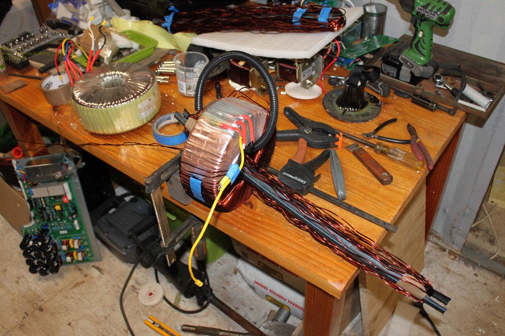

Making some progress with the revamped toroidal and this is a pic unwinding the 2nd outer layer. Mdns gave me the tip on the 25mm poly pipe I made the first one to long @ 850 and settled for 650 with a good 30mm notch. My tips for wha
t they are worth seeing I am coming in on the tail end .
1/ Put masking tape around it to keep it a bit under control.
2/ Take a bit of time st the start to work out what direction to unwind , go opposite to the toroidal winder so from the end back to the start.
3/ On the second time I used a piece of 12~15mm flexi conduit to slip around a few turns before unwinding on to the poly shuttle unwindy thing each time, acting as a follower would on a crane winch. It picks up where the winder sometimes gets the lay wrong . and one wire has jumped under itself. If its a bad one and caught under 2 take time.
4/ Find a way to secure the toroidal when unwinding. Probably goes without saying.

Good to see you are having fun Phill, I also used a shorter piece of poly to wind off the Mylar. I found an old mig wire spool was really useful to wind the Mylar onto. Used a piece of tube that fitted nicely in the centre clamped that in the vice slipped the spool on and a rod in the offset hole acted as crank to wind off the mylar.
When I was unwinding I used a portable bench that had 2 parts that you can wind apart and leave a gap, the torroid sat in the gap of about 150 mm and behaved itself.

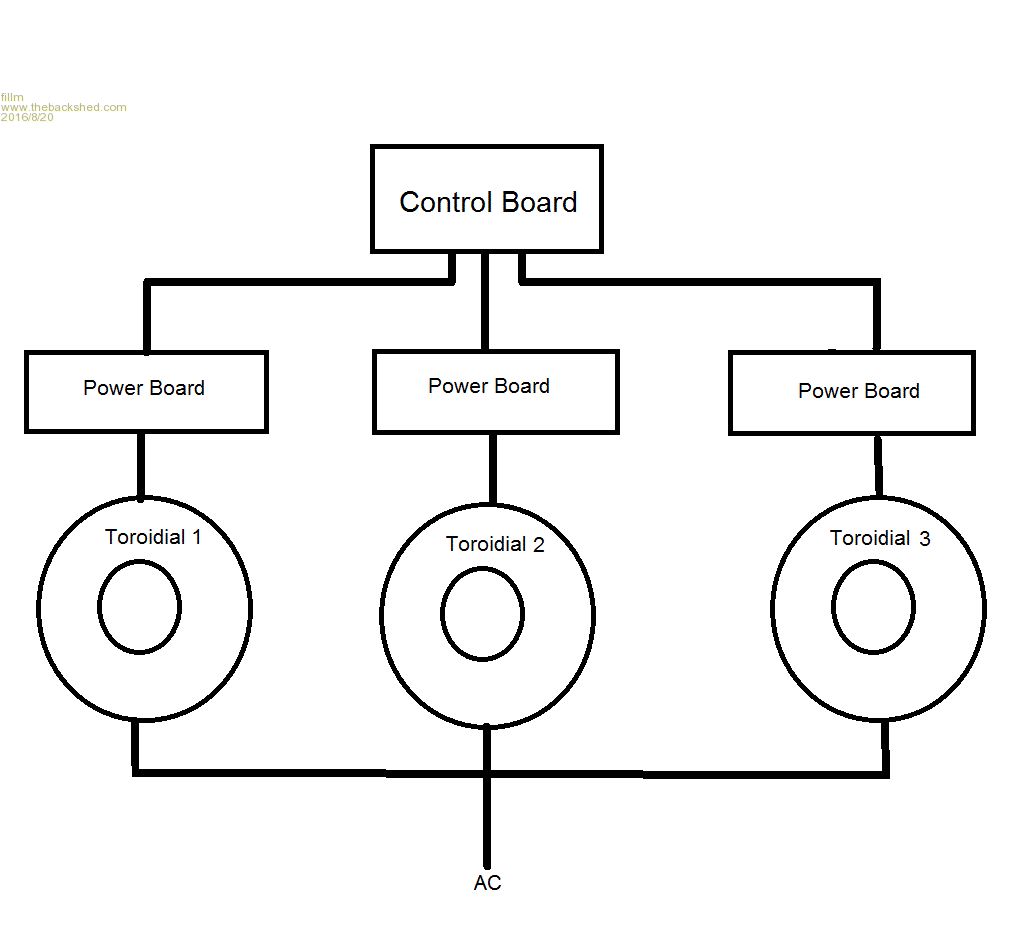

A Question - Instead of stacking the toroidal cores can the one control board switch 3 power boards to operate 3 smaller Identical Toroids as shown in the simple block diag below.
If not then why or is it just plain stupid ?
Edited by fillm 2016-08-21
oztules
Joined: 26/07/2007
Posts: 1686
Posted: 07:30pm 19 Aug 2016
No.... simply parallel or series the three primaries, and do what you need with the secondaries ( series or parallel... depending on voltage of the transformers).
ie if you have three transformers 10v:240v, then series the primaries, and parallel the secondaries etc etc. ( for 48v).
You pay for it in copper losses compared to stacking and rewinding. In the case of three, then you loose a complete winding in the case of stack and rewind.. ie you loose 4 "sides" of copper when stacked compared to loose.
............oztulesEdited by oztules 2016-08-21

I think everyone has asked that question as it involves a sh*t LOAD less work.
Most of the builds here are :)
