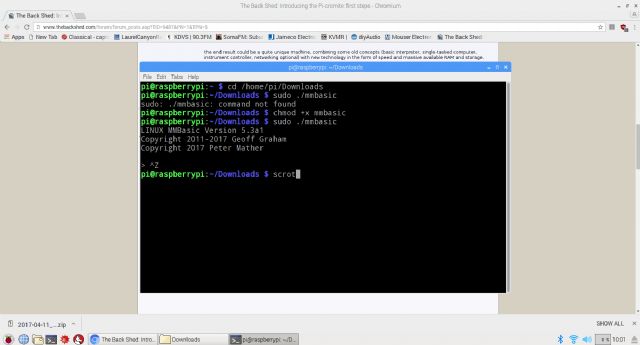

Hi,
Should this work on a Model B?
I can get it to run but it crashes the rPi at the mmbasic command prompt.
On a fresh install of Jessie which has pigpio installed already.
Anthony.
Posts: 12244
Posted: 07:07am 12 Apr 2017
The pin usage of the early Pis were different. The code should work properly on A+, B+, Pi Zero (W), Pi2B, Pi3B but not currently on Model A, B, or B (revision 2).

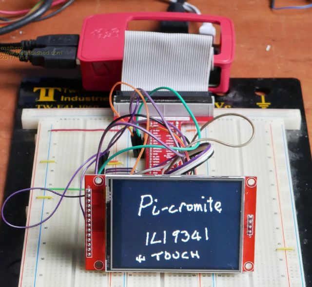

Fairly big upgrade 5.3a2 including more "Micromite" functionality
2017-04-14_184056_mmbasic.zip
This now supports hardware SPI using Pi pins 19,21,and 23 with the standard Micromite syntax (SPI OPEN, ? SPI(x), SPI WRITE, SPI READ)
In addition it supports the following SPI displays connected to the same pins (+ user selectable CD, CS, RESET) ILI9341 (320x240), ILI9163 (128x128) , ST7735 (128x160), ILI9481 (480x320). Transparent text and BLIT are available for the ILI9341 display.
Touch is fully implemented and should also be connected to the SPI H/W pins + user selectable IRQ and CS.
The displays and touch are enabled using the standard Micromite syntax (OPTION ...)
Options are saved in the file ".options" in the same directory as the mmbasic executable
GUI TEST LCDPANEL and GUI TEST TOUCH are both implemented (exit using ctrl-C)
All MX470 GUI capability is also implemented and has been tested at a limited level.

...is it possible that's our Pi-cromite doesn't work on a older Raspberry-Pi B? (not B+, Pi2 or Pi3)
It start's but I can't type something in - ctrl-z also doesn't work!
I have some Odroid-W which have the original chipset from the B (but with integrated battery loader and RTC) - they are ideal for battery operation - it would be very nice to have our MMBasic on it...
Frank
Posts: 4401
Posted: 12:03pm 14 Apr 2017
  Frank N. Furter said   ...is it possible that's our Pi-cromite doesn't work on a older Raspberry-Pi B? (not B+, Pi2 or Pi3)
Peter already posted some examples that are not supported, so yes.
(Though when time permits or someone helps then maybe there's nothing too hard to tweak so it would work.)
JohnEdited by JohnS 2017-04-15
