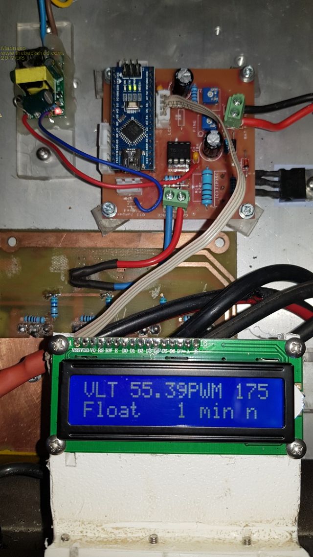

Ok it has had a few days operating, and I have seen no bad behavior.... so I think I'm done with the programming for the moment.
Here it is for those that want to use it as a basis to start their own journey into nano land....
It is simple as it is straight forward with no fancy computing skills.... as I don;t have any, even the averaging is Gomer Pyle simple... no array's in sight..
Anyway comments welcome, and better versions welcome too.

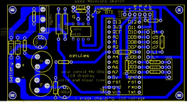

/*program to use for driving a 3 stage charging device via pwm.
The program will use the floatVolts,bulkCharge and absorbCharge values to control the set points.
pin3analog will be the voltage sense from a 0-5v input from a voltage divider for measuring the
voltage from the battery. Standard 1602 LCD is assumed.
Stay in bulk until 59v, then run absorb for a few hours, and then float at 57 for the rest of the day.... if we fall to far ( eg 50v), then restart the whole process
The time is in the long timedOut constant. If the battery voltage drops to less than startAllOverAgain ( nominal 860 for about 50volts ) then it reverts to bulk
charge again, ready for the next day etc.
Voltage read is the " lcd.print (val/16.99);" line, the 16.99 can be changed to calibrate the voltage to match the real world.
output is from pin6. It can drive a opto or totem pole driver for the fet.
Also is simple 5 stage averaging.
It was developed for the accompanying circuit board. It can be used for HV GTI contoller or LV array to battery use.
A jumper needs to be used for GTI use... this will common the fet source to the battery neg.
For the 48v array, the pos is common, and this jumper is not used...as to keep isolation between array neg and battery neg.
Fet drain goes to the batt neg in the LV, and goes to the GTIneg in the GTI setup.
........oztules

That should be the last from me as a pretend programmer for a good while.
I think it has been fun... ish.
.........oztulesEdited by oztules 2017-07-26

Board for above program
............oztules

Excuse my ignorance but what is z18 and the lamp on the left hand side of the board?
oztules
Joined: 26/07/2007
Posts: 1686
Posted: 02:45pm 25 Jul 2017
18v vener and 1 amp diode.... for GTI use there is a small jumper next to the pins for the fet output.... if only using GTI then just join the tracks there.

You may find it better to see it over on another power... it is much bigger and easier to see.
http://www.anotherpower.com/board/index.php?action=dlattach;topic=1270.0;attach=7157;image

Looks like I am on a winner with the GTI regulation, here is how it looks.
I used a part I cut off one of my old inverter PCB's to mount the 4 20N60S5 MOSFETs they are rated for 600V and 20A. I have put a 10K gate to source resistors on each one and 5r6 gate resistors. Also I have added 103 3KV caps and 3W r47 to act as snubbers.
I don't know if it was necessary but I separated the drains on the PCB by cutting the copper down the middle of them.
It has been running the last few days without a hiccup, I have tweaked the settings a little to get it to match my DC charge controllers. The GTI I am using is a 5KW Zever Solar HF type, it errored out initially using the on board power supply, so I have added the isolated supply on the top left of the photo above. This is the IPSU it is modified by adding a 6k8 resistor across r6, this increases the output voltage to 16V. So the MOSFETs are completely isolated thanks to the IPSU and A3120 Isolated Gate Drive IC.
I am now working on a new version with everything on one PCB and will control a GTI and dc to dc panels.
I have made 2 changes to Oztules code also, these are to stop the GTI shutting down if another source is charging and the absorb timer will stop ticking down if the voltage is reduced by cloud cover or loads on the system.

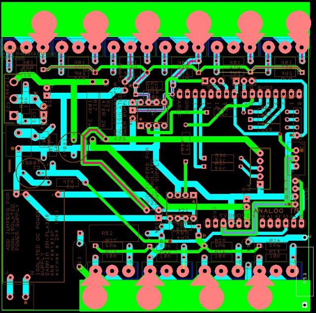

Hi Oz,
Just about to get some of the boards ordered as shown above, I will also be doing a slave board to go with it. I am keeping it separate as keeping the board size 100 X 100 has a big effect on the price. The slave board will have another 2 gate driver chips and 2 banks of 6 MOSFETs, these will be able to be configured for either LV DC or GTI.
I will be doing a complete rewrite of the code which will include temperature compensation, control of SSR's etc, one thing I want to include is controlling the AC in my equipment and battery room.
While doing this I will work on control over power lines so the PWM of the master controller can be sent to slave units. I have changed to using a Arduino Uno which is much easier to add shields etc to. There is a Mamba shield that would do the job but not sure it is still available. What sort distances would be required? Wireless may be another option.Edited by Madness 2017-09-10
