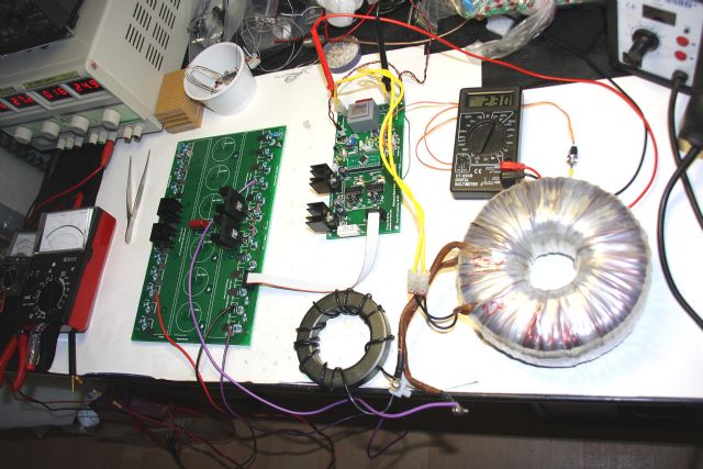

Is there any way to test ctrl board without connecting it to power board?
OffGrid 24/7: 250w black mono solar panels 6.4kWp, 1x Midnite Classic 150, 1x MorningStar MPPT 60, battery bank 840 Ah @ 48v, modified LF-8K inverter, DC/DC, hot water harvesting, etc.
Madness
Joined: 08/10/2011
Posts: 2498
Posted: 11:03pm 28 Sep 2017
You can test the output pins of the IR2110 chips on the low side with an Oscilliscope. One chip will give a square wave output, the other is the sinewave pulse width modulation. To do this you need to put your probe on and turn on the 8010 chip, you only have a few seconds before it will shut down due to no voltage feedback. You can connect the 12v on the board to the positive side of the output of the diodes to fool it into running constantly, it may require some adjustment of the VFB pot to get the right voltage level.
Then you can test the control board and power board by leaving the capacitors off the power board and put a couple 10-ohm resistors in series with the 48V input you can run the power board without risk of blowing the MOSFETs. Once you have established you are getting a decent smooth sinewave and low idle current from the transformer you can then shut it down and add capacitors. Then you can finish assembling everything and everything should be fine.

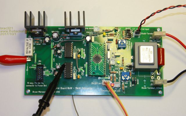

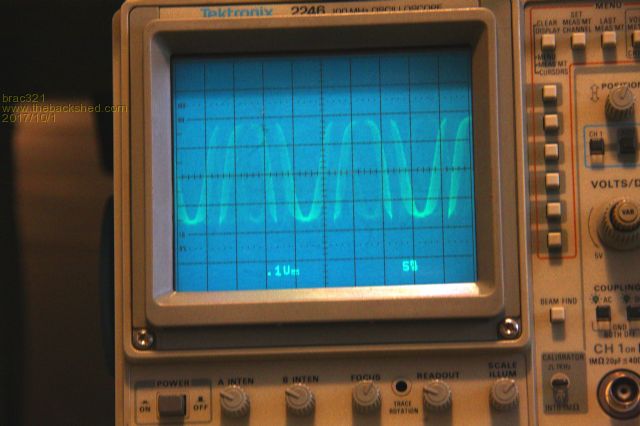

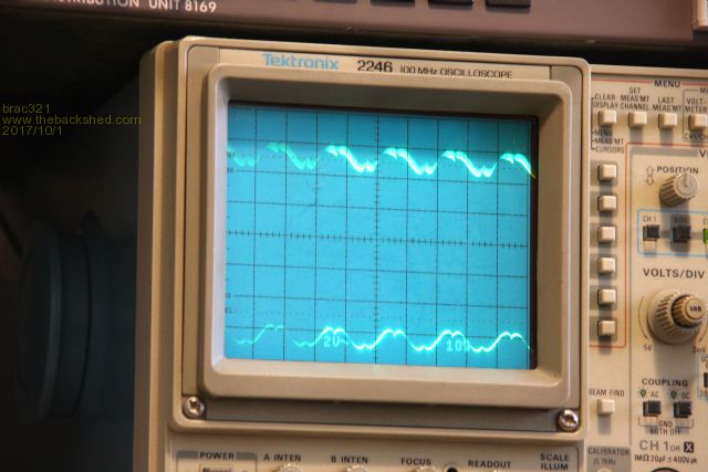

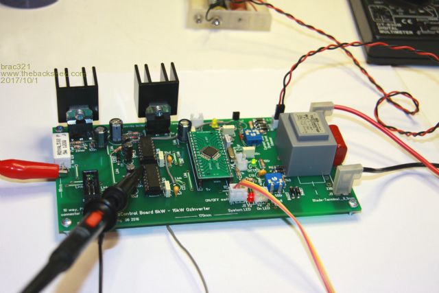

Have tested today ctrl board alone. For voltage sense I connected it to 230v home grid (Off-grid). It takes less than 30mA @ 50v. Both pulses are there, temp. protection works, current shut down and on/off switch too.

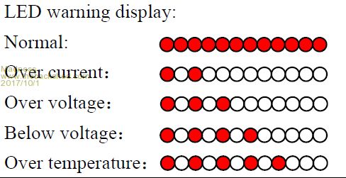

Is it normal that System LED flashes in case of voltage too low/high or current shut down, regardless to position of on/off switch? Also current shut down (after triggering) is not reset until I switch supply to board Off and back On.

The one drawback with the 8010, is that if the voltage rises slowly, the chip will hang... and be totally unresponsive, so it needs a reset switch.
I do this by a momentary switch that shorts the power to ground after the 120r input resistor.... crude but works perfectly well.
This allows you to slowly charge the cap bank when installing it with say a 100r resistor.... the 8010 will hang, we reset ( short to ground after the 120r ) and we install with no brutal sparking.
It also is the only way to reset the current shut down. I did this on purpose, as I want a person to reset from a current overload, in case there is a real problem on the line. Mine are always set well north of 10 kw, if you blow that there is something wrong I suspect.
"Is it normal that System LED flashes in case of voltage too low/high or current shut down, regardless to position of on/off switch?"..... it is years since I looked at this or had a fault, and can't really recall what the true behavior is. I may get the heat gun out and have a look
Those scope pics are not what I remember, but it relies on where you actually measure as to the shape of the waves on the output side of the drivers, and you may need a fet attached to see it, or the high side voltage pump will not work properly.

I am not sure what the first CRO photo is but the next one off the bottom IR2110 looks very good, the other IR2110 should short hi/lo similar to a square wave. Is that in the photo taken at a angle to the CRO? The other output pins on the IR2110's will not show a signal till it is connected to the power board as it requires the charge pump to drive the high side.
LED will flash as per below, this is from the EG8010 manual attached.
2017-10-01_213231_EG8010.pdf

I see you have updated the old 10aOzControl board to the 12 version, nicely done.
And your testing and photos are good to see.
I look forward to seeing your finished and running OzInverter.

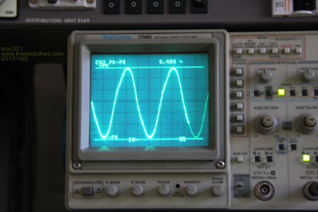

Posted: 06:38am 02 Oct 2017
Oztools, thanks for all the infos. I think I will play a bit around this problem (current shut down reset), have some ideas.

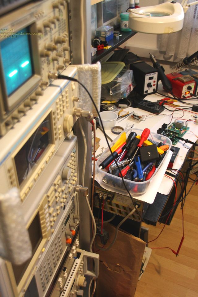

My scope pictures, yes Madness 2nd one is valid and should be ok, 1st one was taken with not properly set scope (AC/DC ...). Blurry pictures taken at low light with my shaking hands, sorry.
"Wow you have some gear there" - hm, nothing special, older high freq. lab equipment up to 14 GHz. Some RF generators, few spectrum analyzers, modulation analyzers, video generators, etc. More than 30 years was occupied designing UHF & SHF - Microwave projects ...
Warpspeed, yes I found out the same behavior of voltage feedback stage. Have used stabilized PS later on, and the voltage level must be very precisely set. Anyhow, also with home grid it can be tested well, except from time to it goes in to under voltage protection and back.
Clockman, yes I've updated your board. It operates well, except problem with reset of current protection. After triggering it (with trimmer & DC source on sensors input), it stays permanently ON - until both boards were disconnected from DC source. Don't know if I missed something to rewire around SCR for rev.12? It is a bit strange to me, that diode bridge is not grounded in that part of board. I have only older Gerber files from Oztools where this protection circuit does not exists.

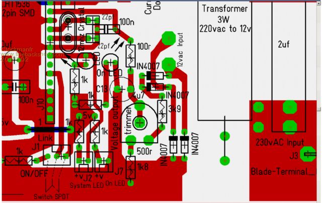

I am sure you have amended the OzCntrl board No10 to the No 12 arrangement.
Just to check a couple of things brac123......

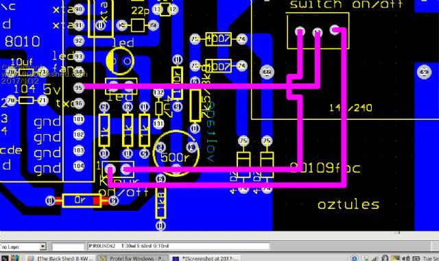

Firstly, ... I trust that you did not fit that 1k5 resistor that is shown on No10 board at Pin 6 of the 8010 chip.
Board 12 has Pin 6 going straight to the centre contact on a SPDT On/Off OzInverter switch.
Looking at your board a little closer, It is not clear.? I can not see that extra 1k resistor or is it under the board.
Regards shutting down the DC on the power board, ..... Personally I do not see a problem with this. I think its a good safety feature especially if the overcurrent has tripped, either alter the trimmer to allow more as Oztules says 10kW is fair, or check to see where the problem is.

Your waveform looks good brac, next step on the power board is to fully populate it except for the caps. With no load the FETs will run all day like that without a heatsink. If you get the same result add the caps and heatsink then your done with that part.

Clockman, yes the 1k5 was removed, 1k (SMD is on bottom side) on the Off position of the switch. And that switch operates without any problems.
I would like to see part of the latest board around current protection (upper right corner of ctrl PCB).
I know, my English is fare a way from perfect, but I do understand Oztools explanation how he solved reset of current protection, and yes it is a good idea for inverter to stay Off after over current error. What disturbs me is that it can not be reset without physically switching main power off.
