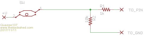

Opps swap the resistors and kill the led. LOL

@ quazee137 - change 'TO_GND' to Vcc, and '+V' to Ground, and you have what I have on the hacked one now. IE: Pin is pulled up via resistors, and ball-switch is supposed to pull the pin down like any other switch in the world does with the 10k/1k arrangement. It does not. Some ball-switches DO, others do not, so they are not consistant, and they must indeed have some internal resistance or oxide layer or some such as has been discussed in this thread.

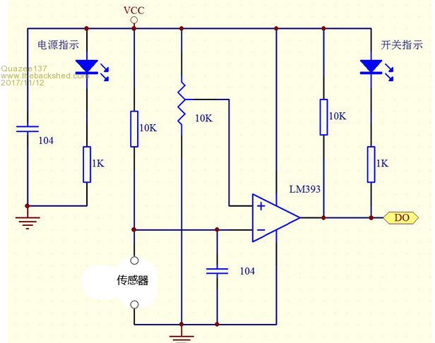

Quazee137
Joined: 07/08/2016
Posts: 603
Posted: 10:47am 11 Nov 2017
This looks to be more of a mass problem or lack of.
I made 3 different ball tilt switch mock ups the smallest ball fails a lot
gold, tin and copper contacts does not matter.
The next size ball works 70/30 there abouts.
The largest ball works every time but at 3/8" is has
the mass.
I am waiting on a neighbor to drop off two sizes copper plated lead (buck shot)
to try out in place of the two smaller ones.

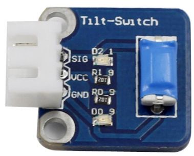

I did find a few sources for the type you posted but they are modules.
All of them seem to use heat shrink no real seal. Maybe your working units
have a good seal. (could try adding a 2nd ball)
The cheap newer types clamming they are mercury replacements has two balls
to help with the mass needed and are sealed at adafruit.com they look to
be gold plated too.

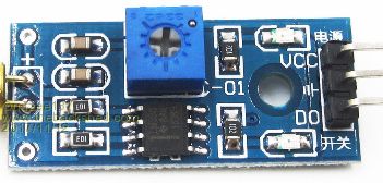

Here is the link and a few more.
adafruit
The sunfounder show the same type but the pictures show one like adafruit .
sunfounder
And wiltronics ball-tilt-switch-module with code.
wiltronics

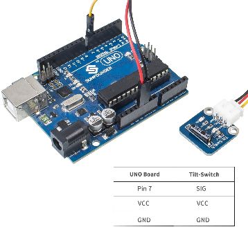

While shopping Digi-Key found RB-441-45
different from how your doing but its one switch.
on till tilted in any direction
Datasheet
and 10 for $14.45.
I don't know if there is some one that carries ckswitches there.

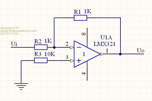

And maybe a way to still use what you have.
but use the little 5 pin opamp
it takes little power to run.
