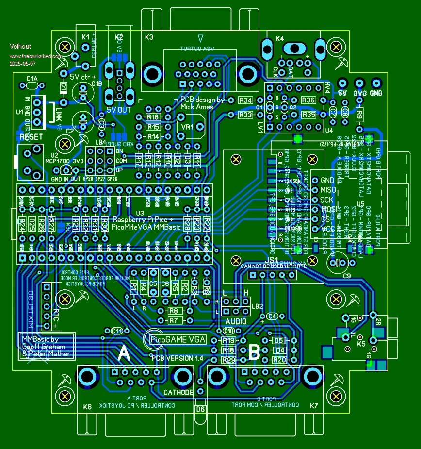

Posts: 6273
Posted: 06:56pm 06 May 2025
Hi Kevin,
When no WII Classic found MMBasic gives an error. So no error means it sees the WII controller.
I did not test with a LCD display. I would be surprized if it would show the same. It feels to me like a memory leak, since the behaviour is different depending the size of the program, and the resources used (sound/no sound etc..). Since standard pico (non VGA) has significantly more free memory, if it is a memory leak, you may have to wait 1 hour before it happens. And how it shows on the LCD is not clear to me..
Thanks for your effort.

Posts: 6273
Posted: 08:29pm 06 May 2025
Hi Kevin,Picogame
This is a VGA game platform similar to Peters VGA referenda design, but with connectors for controllers.
With your result It feels like I am wrong. But I cant ignore what I see on 2 different units showing the same phenonem, and rc20, and rc22, and the intermediate release Peter did. So It is not a bad download. And I did clean the flash each time.

Posts: 6273
Posted: 08:48pm 06 May 2025
@Kevin,
This is the PicoGameVGA

Posts: 6273
Posted: 06:05am 07 May 2025
@Peter, @Kevin,
Both thank you for your support. As to Peters questions.
- I run the WII Classic from 3.3V. Power is stable and filtered.
- It is not a genuine WII controller (ALiexpress says so, but it has no nintendo marking).
I have run the system I2C bus at 400kHz (default) and 100kHz.  Problem remains, and it takes similar time to appear.
The I2C communication decoded is constant loops of
WRITE 0x52 value 0x00
wait 10ms
READ 0x52 values 0xA0, 0x40, 0x10, 0x00, 0xFF, 0xFFn (the n=NACK)
wait 20ms
So the controller is read every 30ms.
On a scope he signal shows quite some crosstalk between SDA and SCL, and that is caused by coupling in the controller cable. I added 2x 100pF capacitors from both SDA as well as SCL to GND. That completely cleaned up the signal, but it made no difference.
The only common component in the 2 setups is the WII controller (connectors, cables, pico's, power systems, VGA screens, keyboard/console) all is different. And the behavior of the setups is wrong, but identical. This leads to believe it is the controllers fault.
However.... from the beginning to the end, the controller continues to responds identical and consistent, looking at the I2C bus signals on a scope. A "crash" could have been visible as a corrupted I2C message, but I do not see that. Also the final I2C message before the crash is complete and correct. After the error the I2C bus always ends in IDLE (both SDA and SCL high) which is correct.
On a scope I may have missed one single controller response in between that is different and causes this problem. I will see if I can borrow an aardvark (I2C decoder/debugger) from my work, that can decode and log each individual message.
Not giving up yet, I need to know....
